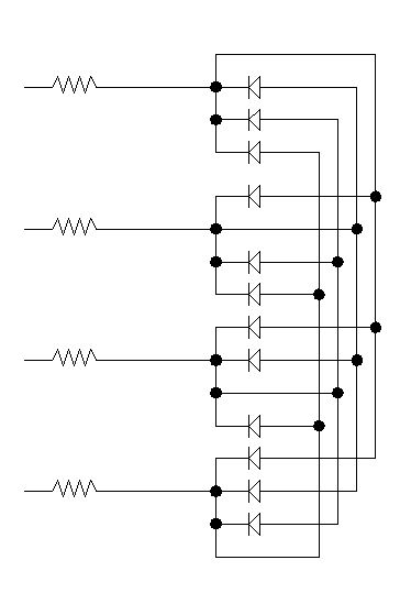

if you want to have few LEDs away from picaxe and if you want no more than 4wires between them you can try couple of methods but i would suggest to:
- use group of LEDs and 4 resistors (wire LEDs in a matrix)
- use another chip(s) like picaxe for example. make them LED driver and use the 4 wires for RS422 or 485 to address different nodes.

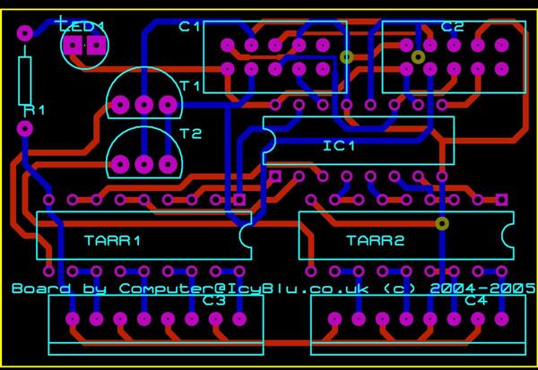

Hi again,
I've been working out a PCB design - Its a pity I can't get it to single layer but this is the easiest way. I'ma going to get it made at a local shop with a milling machine who'll do it for me (they've done before and I'm pleased with the results).
I've decided to use the transistor arrays - can you please check for me if possible the pins are correct. The two connectors at the top are in/out connections. I'm now using 8 core multicore wire wired to DIN connectors. I am doubling up the transistors too so I hopefully can have 1 amp per channel maximum. The two big transistors are amplifying a PWMed signal from pin 4 so that I can (somewhat crudely) dim all the channels as a master dimmer. Pinout as follows:
1) +5v
2) GND
3) +12v
4) PWM (@ 5v)
5) Clock Signal
6) Latch Signal
7) Serin (With pin 7 on other connector as Serout)
8) GND
I will work a design for the control PCB later on tonight.
I hope that looks ok,
computer
note: the sqare pads on the ICs represent pin 1.
