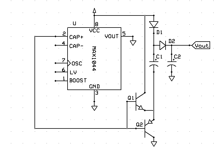

Hi, everyone.
Since the charge pump in the market has limited output current, around 100mA, this will be the problem to power the power hungry devices like amplifiers.
I had modified the circuit and it seems can work. I'll use 2 D type dry cells to power the circuit. Please give me some suggestions because I don't know whether this circuit can work or not.:confused:
1.5V dry cells quickly drop to 1.2V each so the charge pump will have a 2.4V supply.
The transistors have a voltage loss of 1.4V and the diodes have a voltage loss of 1.4V so the output voltage will be less than the input voltage. You made a heater.
