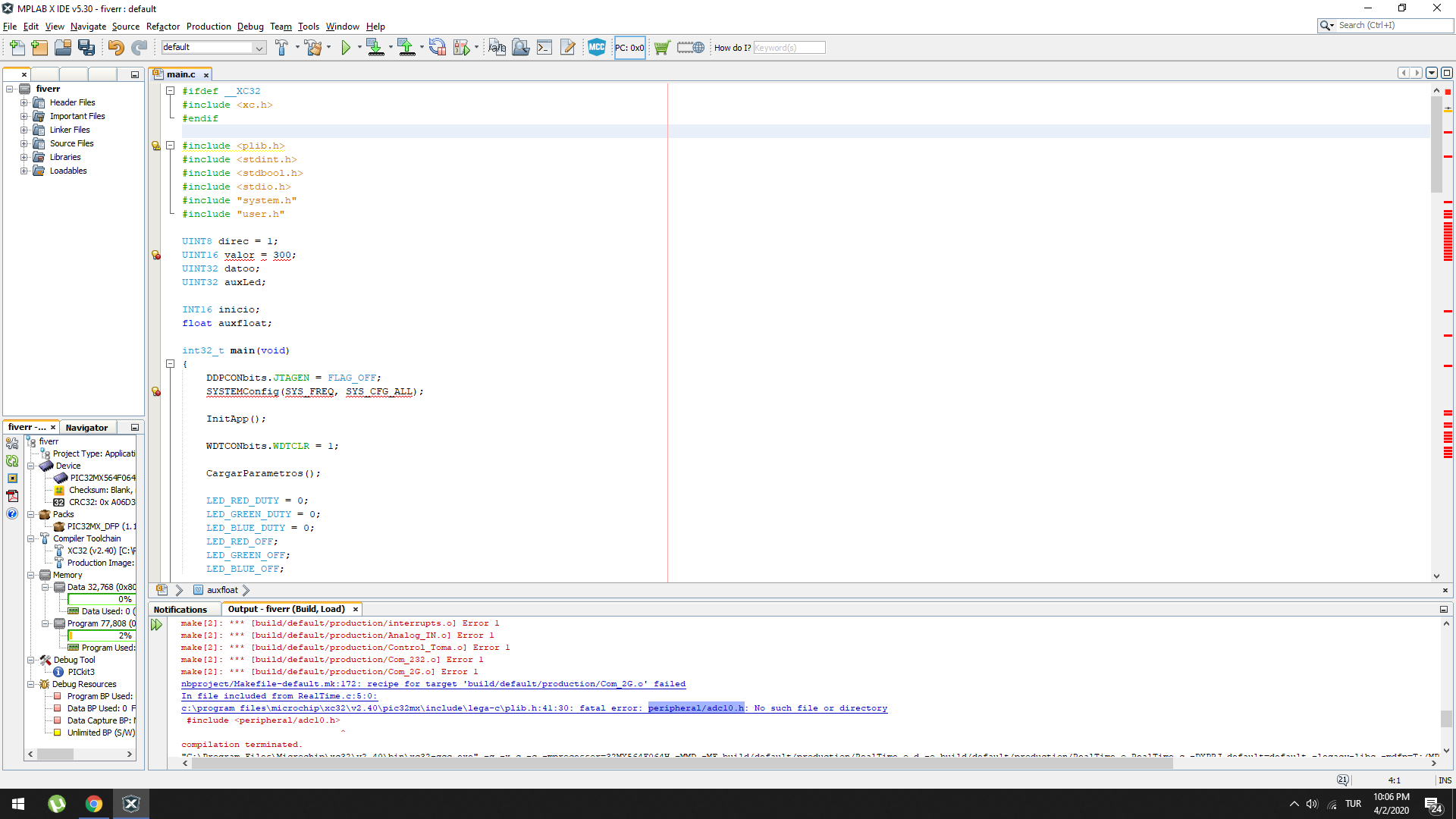

Including header file (plib.h) in MPLAB stops building it
shreyans
Hi am using MPLAB XIDE v2.26. I have created new project for PIC32mx3048ech144 which builds for main.c with only while(1). When I include plib.h header file it generates list of errors. The log is shown below:
code:
C:
#include<p32xxxx.h>
#include<plib.h>
//    Function Prototypes
int main(void);
int main(void) {
    while (1);

Hello, I do not use harmony and I have the same compiling problem. Can you tell how can I fix this error? (I use 32mx546F064)
Actually the problem is related to <peripheral/adc10.h> missing and I cannot find it, besides I downloaded the legacy peripheral library put there but I still have the same problem
You can use the PLIB the problem I had was when I installed the Plib it installed to the wrong place So xc32 couldn't use it cause it couldn't be found I copy it to the same place 1.40 had over to 1.43 and it worked
We are now at 2.40 I have not tried using it with that but I about bet it's the same thing move my copy from 1.40 to 2.40
