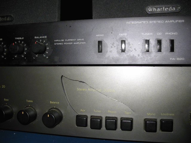

Does a little NAD 3020A count :p
2 Ohms no problem for it as a speaker load. Even tried blowing it up when it was new in 1984 and under Warranty still. Drove it into a dead short (piece of wire). Gave me the middle finger and showed me who is Boss.
Still working today. Tough little amp.
The fact that it's claim to fame was amazing/warm/pleasant sound also helps.
Still the same today 30 Years later. Gold.
Except...the front cheap plastic panel where the controls are...had a little "accident" a while back where I managed to put my elbow through it. Lost my balance again. Frigging ears and stuff.
As I sit and look at it and compare it to my Rotel RA 820 with a nice Aluminum face...I have to make it better. Please excuse the grubby look of the Rotel. It was in storage for the best part of 10 Years.
It needs a clean up. Was my parents one that I convinced them to buy along with Ditton's.
