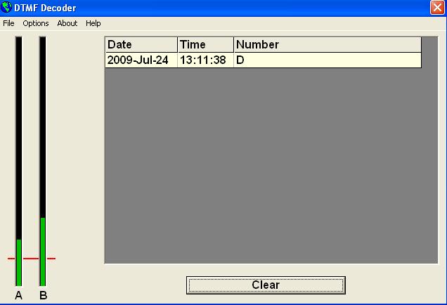

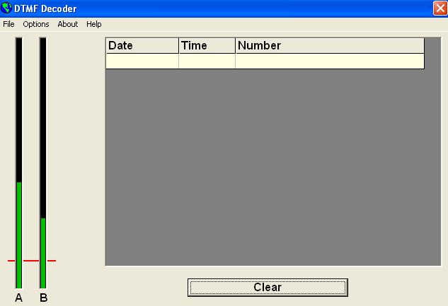

DTMF decoders have a certain amount of allowable "twist". Twist is the level difference of low tones to high tones.
Your 150 ohm speaker might have a poor frequency response which causes the twist to be too high.

I have attached a screenshot of the speakers signal generated. notice the shift of A & B tones between speakers.
The 8 ohm speaker uses much more current than the 150 ohm speaker. They both have the same voltage swing so the power in the 8 ohm speaker should be 19 times higher than the power in the 150 ohm speaker. Then the 8 ohm speaker should be much louder than the 150 ohm speaker.
You're right, given same condition! But I do have a potentiometer installed, so i can adjust the volume. That is why I could set the 8 ohm speaker to its lowest volume and the 150 to a higher volume. The thing is, even if the 8 ohm has lower volume it can still be detected. So I think it is not about the volume or gain issue.
For DTMF to work properly, the low frequency tones must be close to the same level as the high frequency tones.
Your tiny "speaker" has a huge peak at 1.6kHz that messes up its production of DTMF.

Most frequencies are messed up because the tiny "speaker" has not enough output from 500hz to about 1200Hz and too much output from 1200hz to the 1633 highest frequency.

As I read the fine print in your speaker's specs, I'm reminded of something else I wrote a few days ago. I suggested to try a foam donut to couple the speaker to the microphone. Lo and behold, I find that the frequency response was taken when coupled with an "IEC 318 Coupler". It's like putting the speaker right next to your ear and it makes a big difference.
This expensive speaker needs a proper enclosure (possibly a ring of high density foam will help) between it and a phone. Once you've done that, you can probably begin trying 50 cent speakers.
