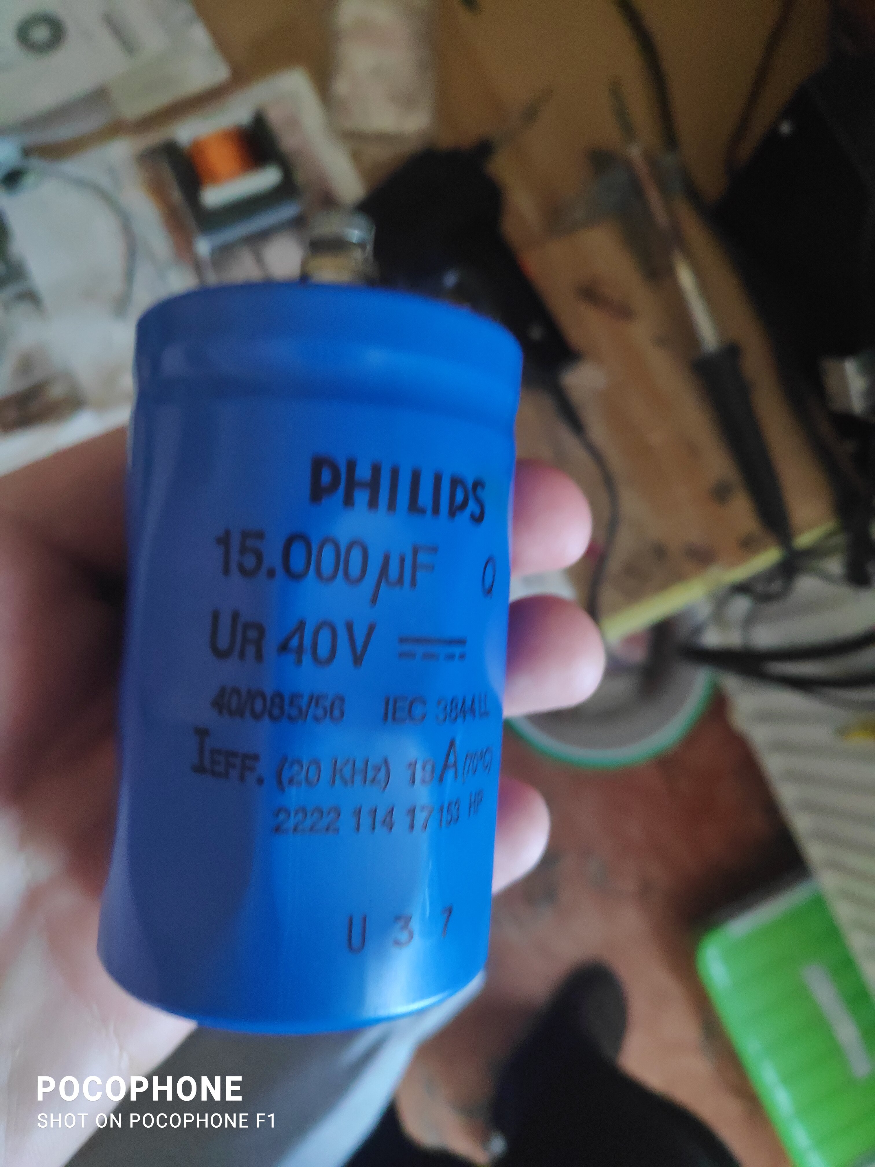

Commonly a smoothing choke was used as well, but you couldn't really get big electroytics back then.
They were crude days.
Bigger than my hand? :)
