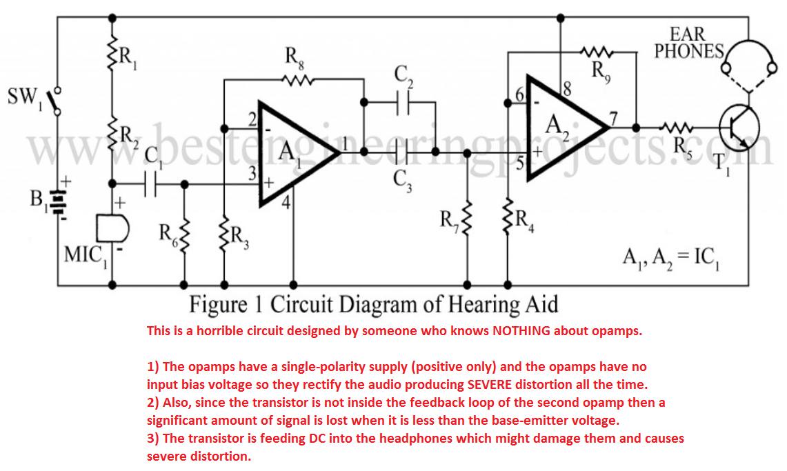

The hearing aid circuit in post #9 has many mistakes. It is extremely distorted and is much too sensitive. The dual opamp selected should NEVER be used for an audio preamp because it is too noisy and also produces crossover distortion. Look here:
I can't believe the headphones are right across the power supply.

If you design one from transistors alone it can prob. work with much less voltage. The question I have is; how much dB amplification is required and what is the efficiency of the earphone unit? Also I imagine you're gonna need to have high end emphasis....anything over, say 4Khz, is gonna need boosting to enhance audibility. Then you have to deal with the feedback issue between the mic and the earphone. there's going to be a natural resonant frequency feedback that kicks in once you have any decent amplification going. So you're going to have to dampen that by mechanical modelling or electronic means.
hard to believe that circuit AG spoke about uses a drive transistor with no biasing....no negative feedback...that thing could saturate and pop the earphone coil.

The description of how the first circuit works is completely wrong (it says the 6.8k resistor between the collector and emitter of the BC557 when it should say between the base and emitter) which makes it confusing. Its gain of only 50 is too low for a hearing aid. Where can anyone find an earphone that is 8 ohms today because they are 32 ohms now.
The second circuit puts DC through the earphones which might destroy them and will cause severe distortion. Their plug is wired so that if you simply connect them in series at their plug then they will be out-of-phase which sounds weird. Two earphones should produce stereo but the circuit is mono. The second circuit produces severe distortion.
Both circuits do not provide important equalization of the frequency response.
