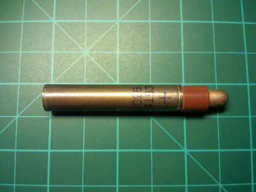

And if you don't already have a Geiger tube, the price of those is going to curl your toes - not cheap.
There used to be a few cheapish ones out of Russia, but I think they may have dried up now.
Google 'Geiger Counter kit' to see what is out there.
Tubes are available on ebay - eg.
Some types with quartz windows will detect alpha as well. That's difficult as alpha is blocked by almost any material.

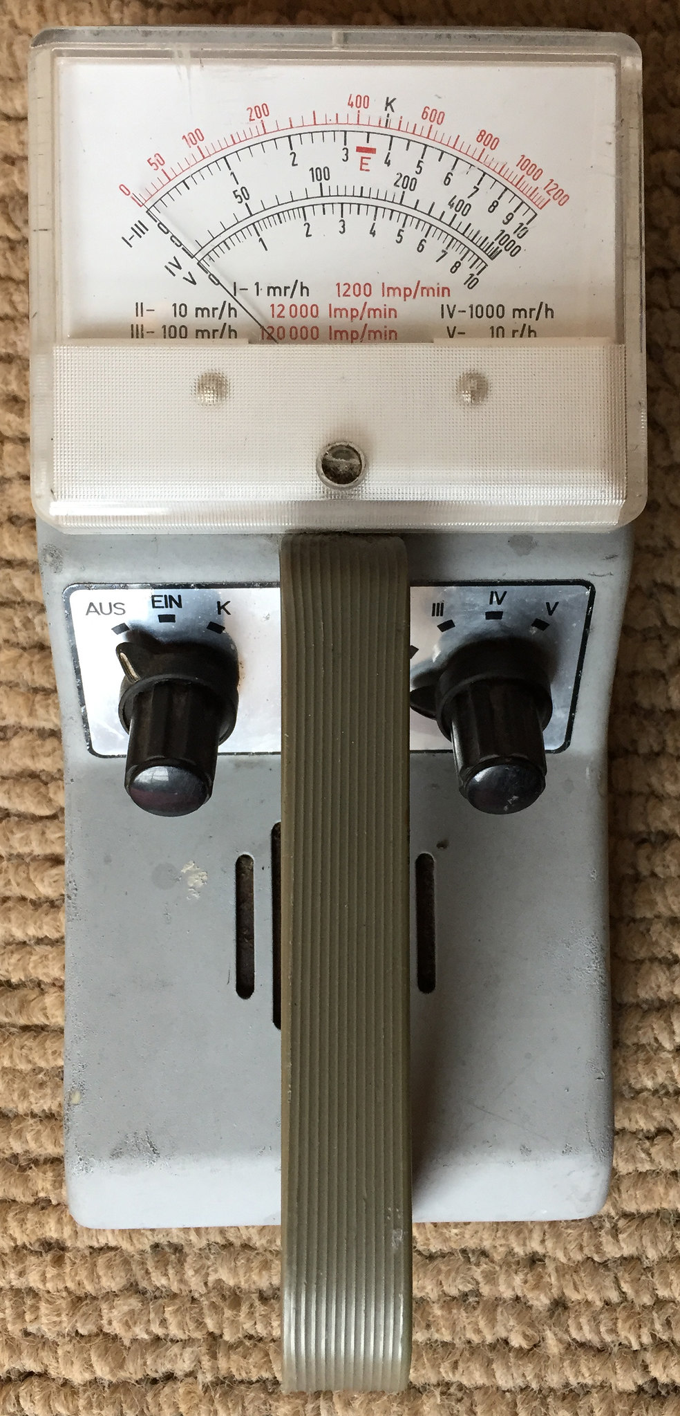

An old unit you can repair of modify may be a good option, they have more facilities than simple kts and some level of calibration. Something like this?
Ignore all the small plastic "radiation detectors" being sold new, they are generally scams that pick up RF etc., not ionising radiation.
There are no places with "zero radiation" outside of specially screened facilities! The Earth itself is radioactive, some types of rock more than others.
This is my Geiger counter, I've had it near 50 years - it came out of one of the UK nuclear sites, sold off because the battery failed.
That’s an interesting option, although it may be fun to try and make one if I need a reliable counter this is probably the way to go.
