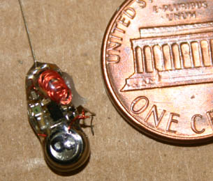

it would be very cool. When I search for falconry transmitters, the most powerful ones I find claim a range of 30 miles under "ideal line-of-sight" conditions--which means *not* in the city.
--- true. every transmitters company says like that. in fact i 've got 5miles range tranceivers and in a city probably 1 mile ranges . when i got 20 miles range tranceivers I got about 4 miles range in city!! lol
--that experience make me start to think that stronger signals still able to emmit signals to the some distances. let's say a transmitter able to emit in sight line 200 miles in line of sight...lol it will able to send signals 50miles in a city !!! theoritically , it's possible but in reality, maybe not....200 miles... it's like a marine class communication and possibly it's need huge battery comsumptions and huge antennas. or maybe after when i was doing ham radio was about 25 years ago... so, time & technologies has change a much more about that point....lol or am I just dreaming way too hard? I wonder how that bat's site guys made his transmitter & receivers....must be it's a factry made & so many smart engineers guys and huge money behind it. :confused:
The article describes tracking devices, most of which lasted one month or less. They don't say that the receivers were in a city.
tracking device
True. the receiver performance is very important . however the distances of signals are decided by transmitter's performances.
in this picture the transmitter is as small as a penny and it's handmade by an Amature American Ham radio operator who does Fox hunting as a hobby.

Well, it's certainly impossible for me at this point in my education, but I have read enough to feel that it would not be easy even for an experienced professional. And in a city there are just so many variables such as building interference and other sources of RF to worry about.
I also suspect that as soon as someone *did* figure it out, it would appear for sale somewhere. Any company making these things would *love* to be the first to say "light enough to be carried by a falcon but strong enough to reliably transmit 50 miles in the city". So far I haven't found anybody who claims to make something like that (but I've only looked a little).
RF design is not easy, certainly not for the electronics beginner. There are all kinds of things to think about, such as bandwidth (it must not interfere with other RF communications), power demand (what kind of battery would be required to power it, and how much would it weigh?), and other things. Even things like the length and shape of the connections between the components become important at RF.
Then again, I don't know what your training and experience are like, and what kind of test equipment you have available.

At the risk of adding to a dead thread, I noted the objections of the poster and thought perhaps my previous range and power predictions were in error. So I recalculated with some bold new assumptions and found that it is indeed technically feasible to make the requested range. Here's how:
The poster's requirements and assumptions included frequency=216 MHz, tx antenna length of 29 cm, battery voltage of about 3.5 V (don't remember for sure), small size and light weight.
I began by considering what is the best way to get maximum range and the answer is to assume the narrowest possible bandwidth in the receiver. For example, if the transmitter simply keyed on and off at a regular and relatively slow interval a simple unmodulated carrier, we could practically use a receiver with 400 Hz bandwidth. This assumes a very good crystal calibration setting in the transmitter. With such a narrow receiver and assuming everything about it is optimized, we could achieve a sensitivity of about -141 dBm.
I modelled the transmit antenna and found that it would be difficult but not impossible to match to. The match is best done with a center feed, where Z=10-j758. If end fed, Z=16-j4000 which is much tougher to manage. The antenna ideal gain would be 1.8 dBi, but with practical matching and some resistive losses, we can say it will be closer to 0 dBi in free space. However, when attached to the falcon, we might lose a bit of power due to body losses and detuning, so I chose a figure of -4 dBi for the overall tx gain (which I feel is a bit optimistic).
