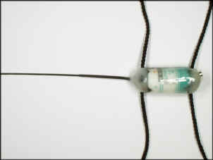

Transmitter weight will be about 75 g or less with Litium battery 6700 (mah) ,3.6V. peak intensity 6 (ma) . dimention of transmitter will be 74x24x24 or smaller if possible. antenna length 29cm. life of battery should be 5.8 years or more. transmitting distance is 40km-80km depends on ground conditon that's the best small transmitters out there that i know so far.
(you can see one on attachments)
Super Voip! thank you for the reply as well.
Yeah, the site looks awsome. i'll should check on that site much deeper.
once again, thank you guys for the insights. if you guys have better concepts plz let me know.
