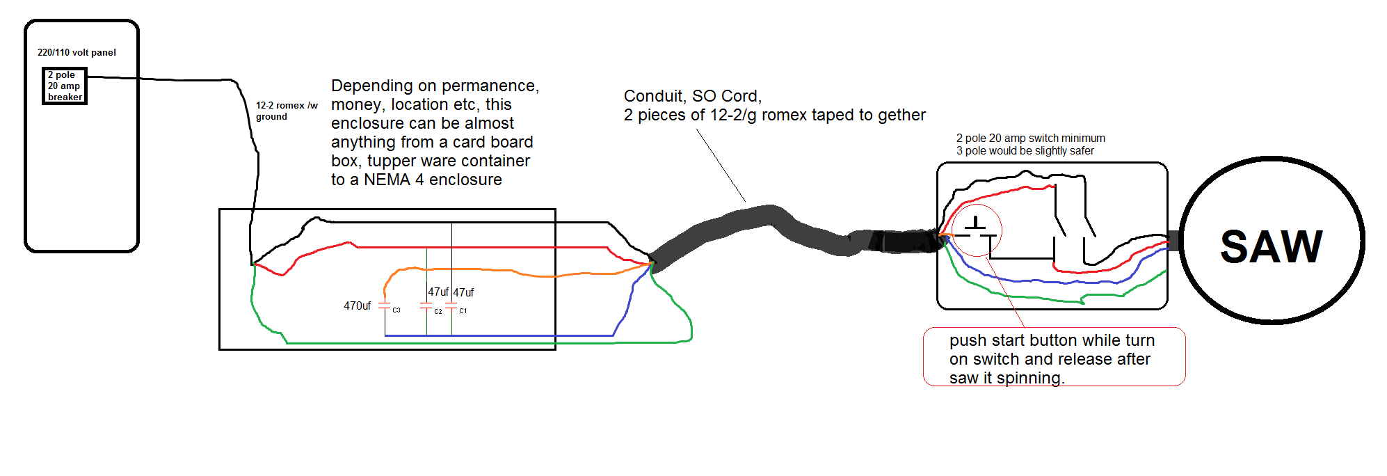

April, If I were to build what you need, this is how I would do it, assuming you working on your own house and when done, the saw more or less goes back into storage, If you're a contractor I would upgrade to voltage or current sensor relay to cut out the start capacitor and use a 3 phase starter switch in a NEMA 4 or better enclosure since brick cutting usually uses water.
I thought I posted this, this morning, but when I went back, it wasn't there.

Well the moment of truth has arrived. Big box of capacitors arrived today ( Isn't that brilliant service and quick) and its all wired up .Just have to get a suitable cord to connect up the single phase. Just a last check of my first try setup
Motor is in star (wye) configuration -see first post for photo of connections.
2 run capacitors of 46 uf each
1 start capacitor of 460uf with 1 pushbutton
Single phase line in is 240 V - 2 lines ,active and neutral.
Earthed all through
If there is anything wrong here shout out now
Fingers crossed...

Well . Thats what I call marvelous.
Thank you very very much tcmtech for that very enlightening and useful piece of information.I know it will definately come in handy here.
I kicked it off with the above configuration and with a supply voltage of 236 Volts I had approximately 430 Volts on one line and 206 on the other while the motor was running. I noticed for the brief period before I cut the start capacitor circuit the motor seemed faster and stronger.
I changed the high line run capacitor to 10uF and was able to get a balance on both lines of about 235 V. Is this what I should be looking for ?
I'm very pleased with this and will post a confirming message on your thread for others that may wish to use this method.
At this point I cannot test it with a load for a week or two as the pulley is in use on the single phase motor.
There was no overheating that I could detect but when I get it set up with a load I will put a temperature gun on various parts of it to check.
