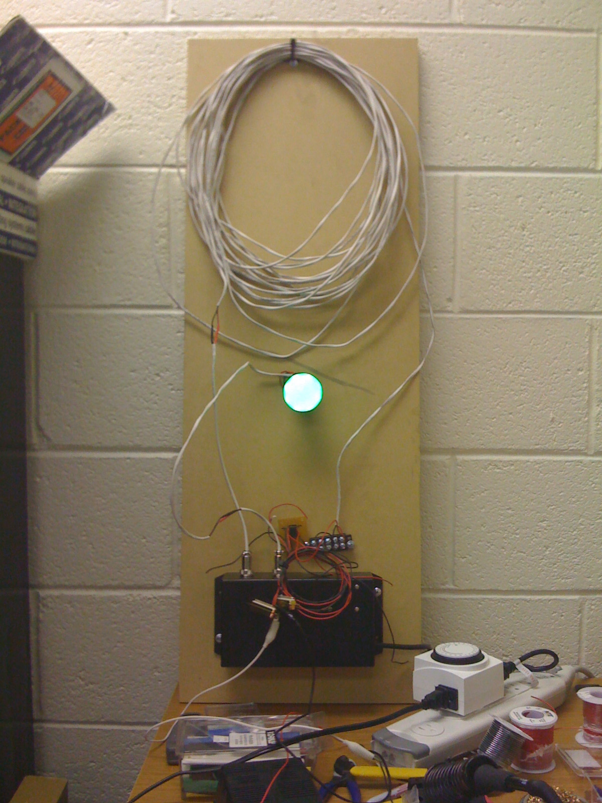

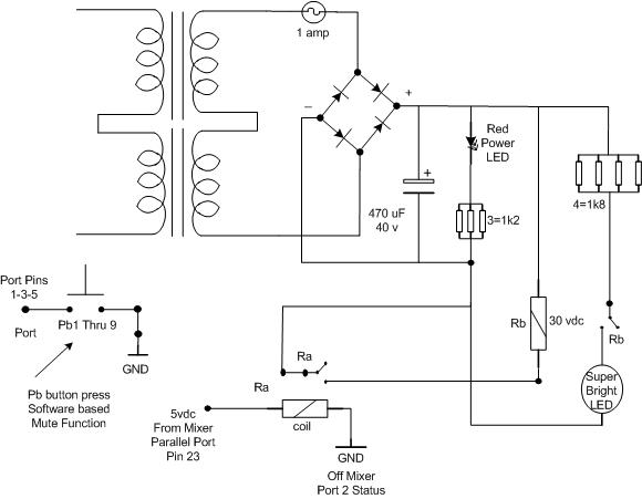

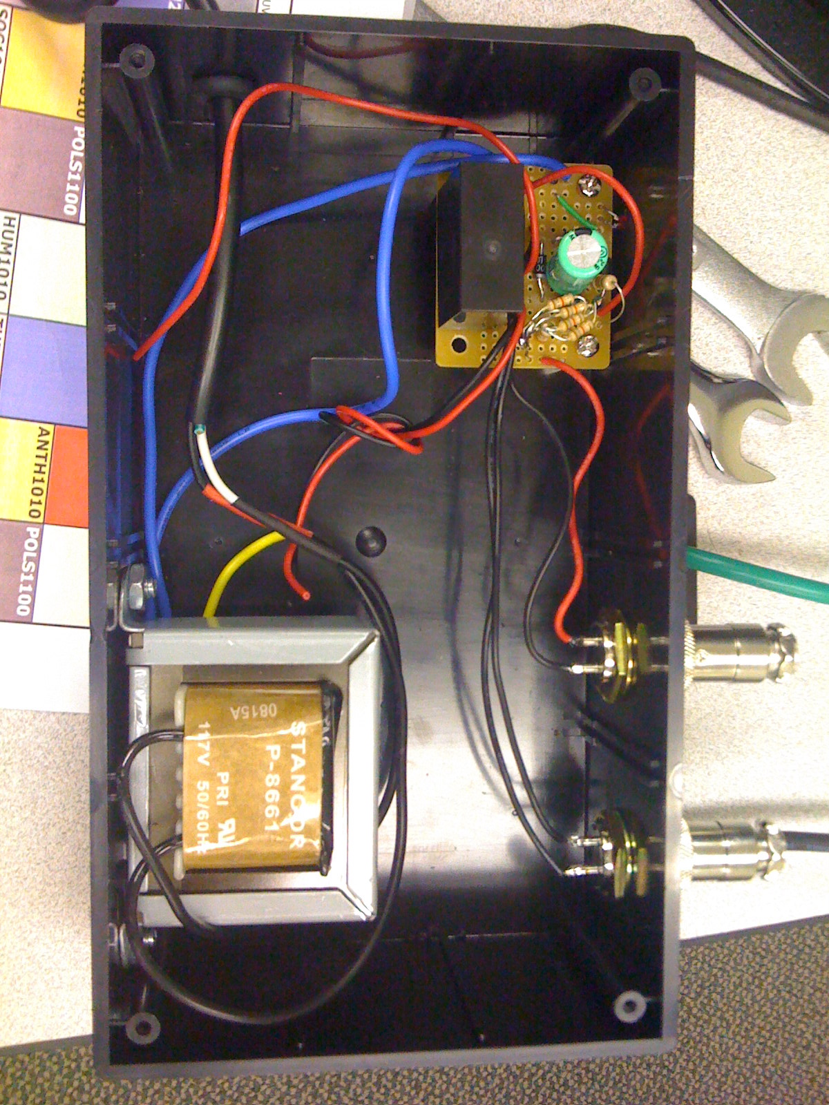

Finished drawing and some pics.
Ok, this is the finished for review and some pics of the application bench test and inclosure.
1. Finished drawing.
2. Bench test light circuit.
3. Inclosure , circuit board and transformer.
If you could give me a suggestion where a fuse circuit could go into this it would be good.
Thank you.
kv:)
Edit: (The Bench Test) I have a 5v supply with an appliance timer. It's been set on 15 minute's off 15 minute's.

Is the 110Vac input fused, if not I would fit a fuse.
Let the smoke begin.
So, maybe a 1.5a or would you go higher ?
On the secondary I've seen where people use zener to short a fuse in a secondary but those are usually SWMP I just don't understand what part of this circuit is best to try it in.
Afterward, I will simulate that destructive load I have extra boards to fry.
I have also Edited the diagram again I missed some stuff.
kv:)
kv:)
Looking at the transformer and the load, a 1A slow blow should be ok.
I wouldnt use fuse/zener on the low voltage side, every component you are using is well over rated. Again a 1A fuse on the output of the transformer secondary should be OK.
