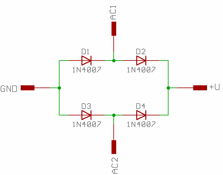

Hi kv,
the bridge rectifier is drawn the wrong way.
Please compare.
Boncuk

Your so right I just new I would do something like that. Apart from the backward rectifier do you think the circuit could work the way it's drawn or do I need to go back to the drawing board ?

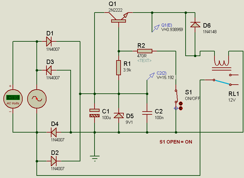

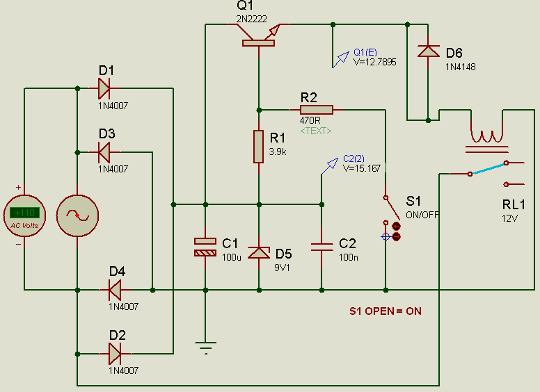

Hi kv,
use the attached circuit. It works in the simulation and so it should do in a real circuit. (Compare the contactors of the relay in the ON and OFF position. The relay is animated.)
Use an NPN-transistor and a 9.1V zener diode. You might try an 8.2V zener as well. Using a 9.1V zener the relay voltage is between 12 and 13V.
Don't omit the free wheeling diode across the relay coil to avoid frying of the transistor.
Boncuk

Correction,
the diode is useless as drawn. :)
Connect it that way.
Boncuk

Got it. Hero taught me about that well placed diode. But unless you hadn't pointed it out I wouldn't have noticed. Thanks.

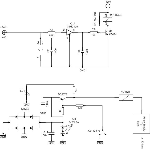

Mainly the top circuit is my re-creation of your buffer circuit. But, using my relay. I built the circuit on the bottom now I'm hoping your buffer circuit can latch the (cc1124-nd relay) and pull the 557b to ground and latching the 2nd relay.
In this drawing the ( 5v 300ma ) is coming from the source pin on a special parallel port built by the manufacturer of some equipment.
I was hoping the buffer circuit with my relay in it would work.
So, I have done the correction on the rectifier and removed the switch to show the voltage coming from my equipment if I push a button on or off in the software I get the source voltage High/low.
This is my first circuit here on the site. When it comes to this I'm a fish in a bath tub going round and round.
Lots to learn.
Thank you

Hi Kv,
it doesn't really matter if the switch I used in my schematic is a switch or a relay. The function remains the same. (Switch or relay closed = OFF)
Please be aware of the odd values of resistors and capacitors you used in your design. You will most likely not be able to get parts like these.
Instead of 4K I used 3K9 (standard E12 value) and instead of 110nF I used 100nF.
A DC smoothing electrolytic cap of 100µF instead of 10µF won't be a mistake.

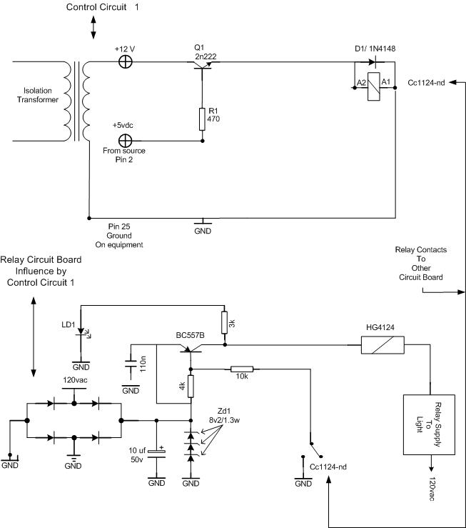

Ok, so I thought about your circuit and decided that maybe I could pull this off.
The lower Circuit has 12vdc on the board I plan to use it and apply it to an Isolation transformer. Then I also began to look at the circuit and thought maybe with the control voltage it could pull in the transistor 2n2222.
If so do I keep it NPN or change to PNP.
Thanks I hope you can look at it.
I'm also open for suggestions.
kv

Hi KV,
I've not read the whole thread and to be honest I don't want to.
I've just read the first post and briefly skimmed through it.
The circuit in your last post doesn't appear to work.
The 120VAC part looks like a transformerless power supply which will blow up as there's nothing to limit the current.
What's the isolation transformer with +5V and +12V doing at it's secondary?
I don't know why on earth you're using a 110nF capacitor and 4k diode when standard values such as 3k9 and 100nF are near enough.
Sorry but this doesn't make much sense to me. I'm sure this has probably been discussed before but why not just use a relay?

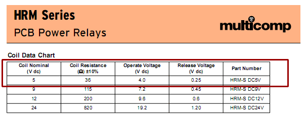

Ok.
You want a relay like the type in this attachment, with the 5V coil.
You connect the relay coil across the +5V [400mA rated] and 0V.
Connect your light and mains supply in series with the normall open relay contact.
Do you follow OK.?

The relay will do nicely.
