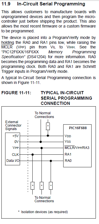

Reading section 11.9 in the datasheet, the 14 pin version has icsp. Section 11.10 mentions that the ICD2 is not suitable for icsp so a 20 pin version is available. Why can't you use the 14 pin version?

Read section 11.9. The 14 pin chip CAN be used for debugging. Use your Pickit3 or just try it.
Just in case you're looking at the wrong datasheet, here's the section,
Note the connections are to A0 and A1 - not the special pins the 20 pin version has.
Edit, I may be wrong and only programming and not debugging will work. Have you tried setting a break point?
