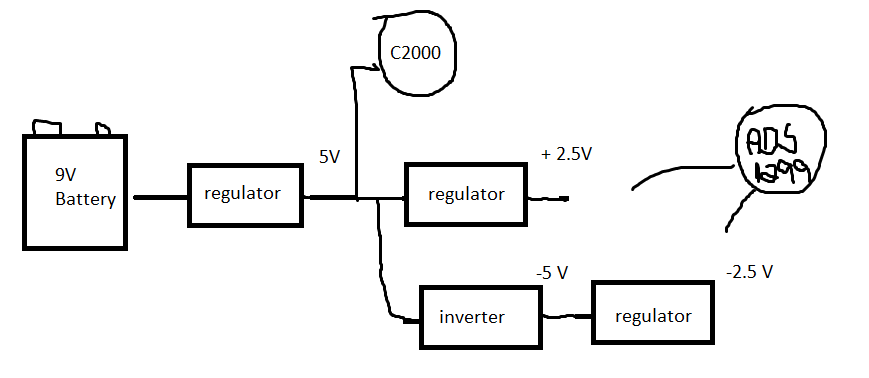

So, I have this ADS that I am interfacing with a microcontrollter called C2000.
ADS works with a dual supply (+2.5 and -2.5), and C2000 with a 5V.

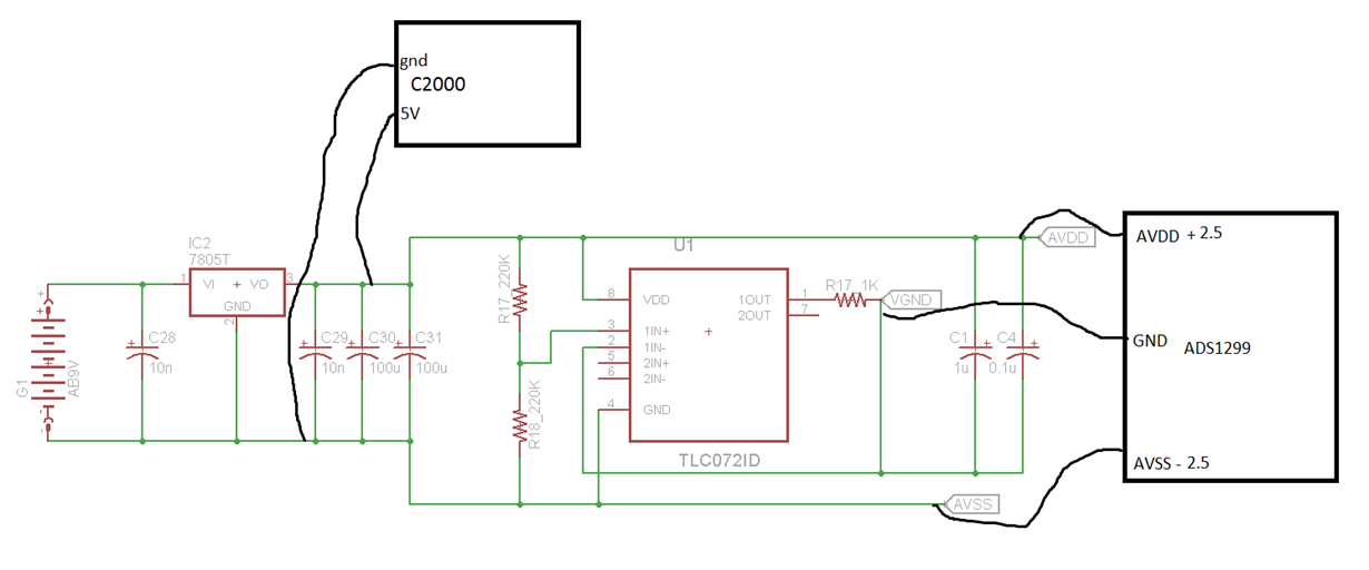

I made the following schematics and I can get a +-2.5V to supply the ADS1299.
I use the C2000 to interface with ADS1299, which means that both grounds should be tied together.
The whole system consumes around 50mA.
And according to this schematic that i made, this isn't possible because the references are different.
At first I thought about making separate rails:
This is definitely gonna work, both devices could share the same ground. Although, the parts I would need for this can't be found easily in my country, and I would need to buy most of them from somewhere else which would take time and money.

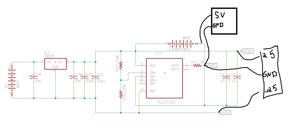

So, going back to my first schematic. Instead of putting the c2000 before, I would put it after the ampop. But I would have to use a battery to bring up the voltage to 5V (I have a 2.4V battery so it would work) Something like this.

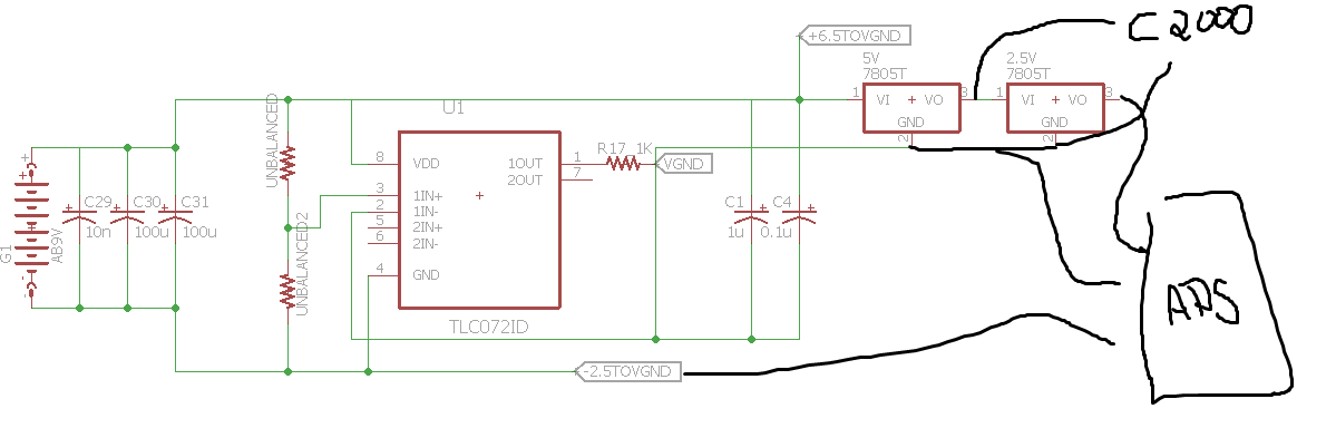

Or maybe a different approach. Back to my 1st schematic, what if I make an unbalanced voltage divider?

Is it critical that the analog voltages be bipolar about GND?
As a rail splitter, the opamp works only if it presents a zero ohm output impedance to the loads. Not 1K.
