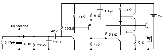

Here is what I have so far. (see picture). As I change the input, I hear a local AM station. What I am trying to achieve is an FM radio. I am currently trying to pick up 102.9Mhz on my receiver. 102.9Mhz belongs to a local station that is about 2 to 4 km away.

This is a cristal-detector receiver for AM stations, with AF amplifier (and what is a transistor B-E serial with piezo-speaker?) You can build an FM-demodulator with another circuit, called discriminator.
In this circuit the coil/cap pairing is only tuning the antenna input so you will only get the strongest signal.
I would suggest thet you change the 5.1pF capacitor for a variable, 0 - 10pF, to enable some very broad tuning.
A better solution for building an cheap FM receiver is to use the MC3362 or the more modern variant MC13135.
Have a look at the example in the datasheet. Also other design with this chip are available on the web
I've used this in a lot of home built transceivers and found it to be more than adequate at an affordable price.
