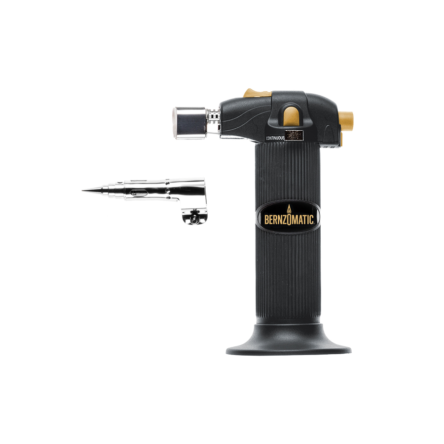

I'm repairing an HTC Desire 816 that had a broken screen and LCD. I fixed all of that but the battery terminal was some how pulled away from the circuit board. I need to solder the terminal back onto the circuit board in order to charge the phone. However, I don't have a soldering iron. Is there any other way I can fix this? Is there an alternative to soldering? I'd order one, but it would take way too much time to get here. My client needs their phone back asap.
There isn't really a substitute for a soldering iron when it comes to delicate electronics work.
Your local hardware store will probably sell a soldering iron.

If you can't stomach the purchase for "just this one" repair (albeit an insignificant price, IMO), then maybe you could get a tool that does more than just solder. For example, this is what I use for soldering when I'm away from electrical power source; It's actually a small butane torch with all sorts of applications, one of which is a removable soldering tip:
IMO every person should have a soldering iron. There is no substitute
