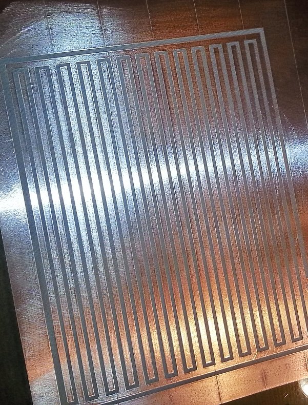

Hello, I have this table with electrostatic sticky surface that made by a snake design of tracks and 3000V DC power supply for HV.
My problem is that the table was redesigned from zero, and now the electrostatic sticky force is very low. The tracks were copied exactly.
The tracks are made from copper foil, the 0.2mm double sided tape used to glue a 0.6mm PVC or PP plastic sheet not sure.
Track gap is 3.5mm exacly for 3000V not to arc right.
Any ideas how to make this work?

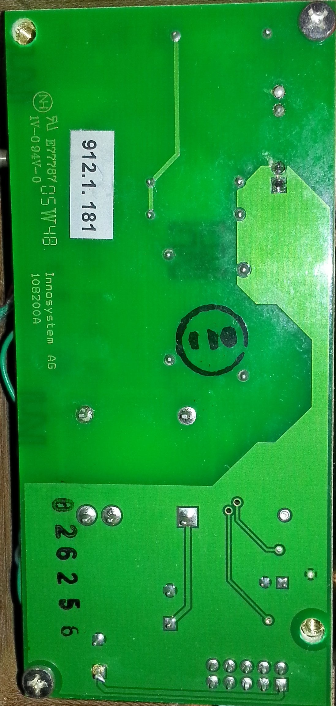

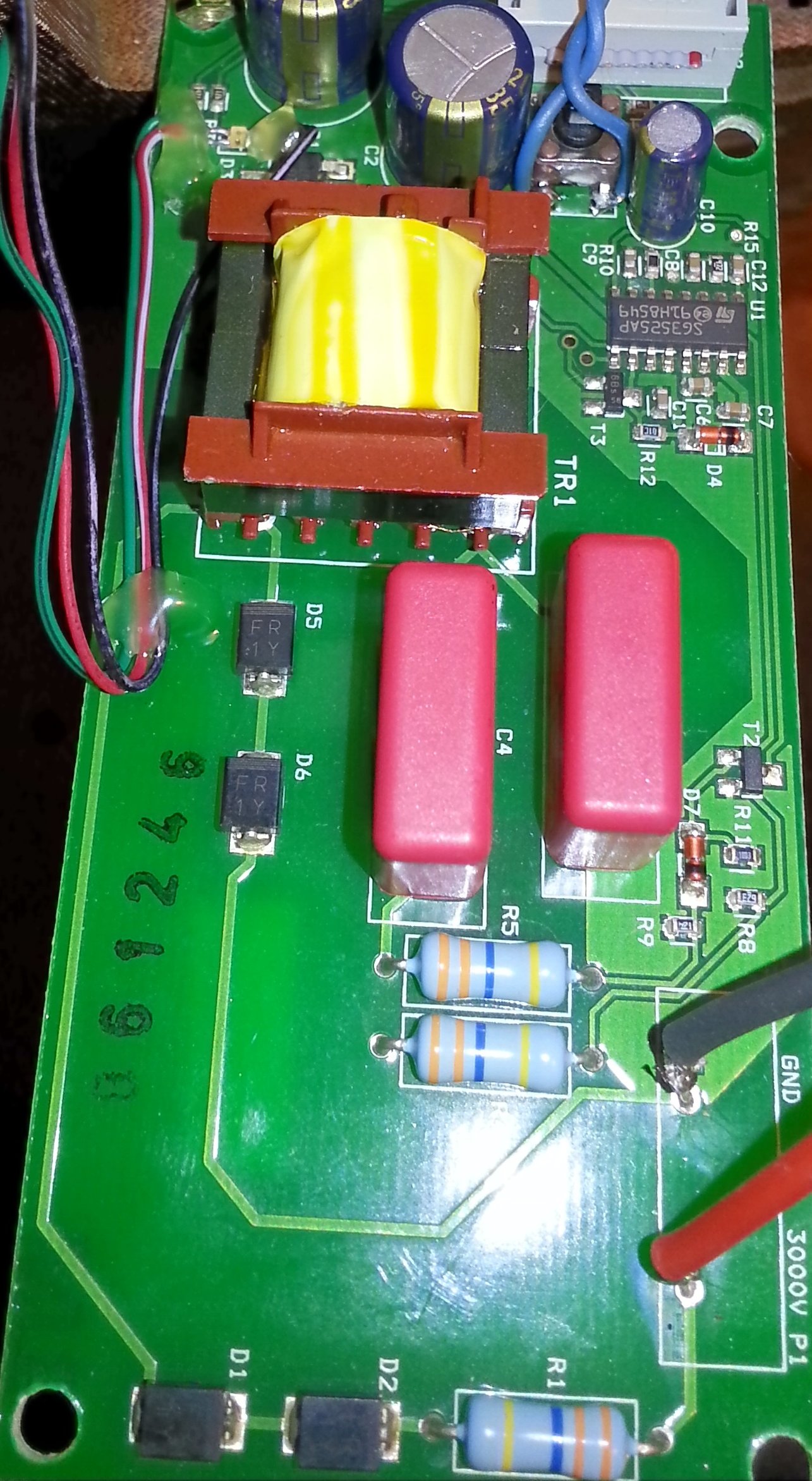

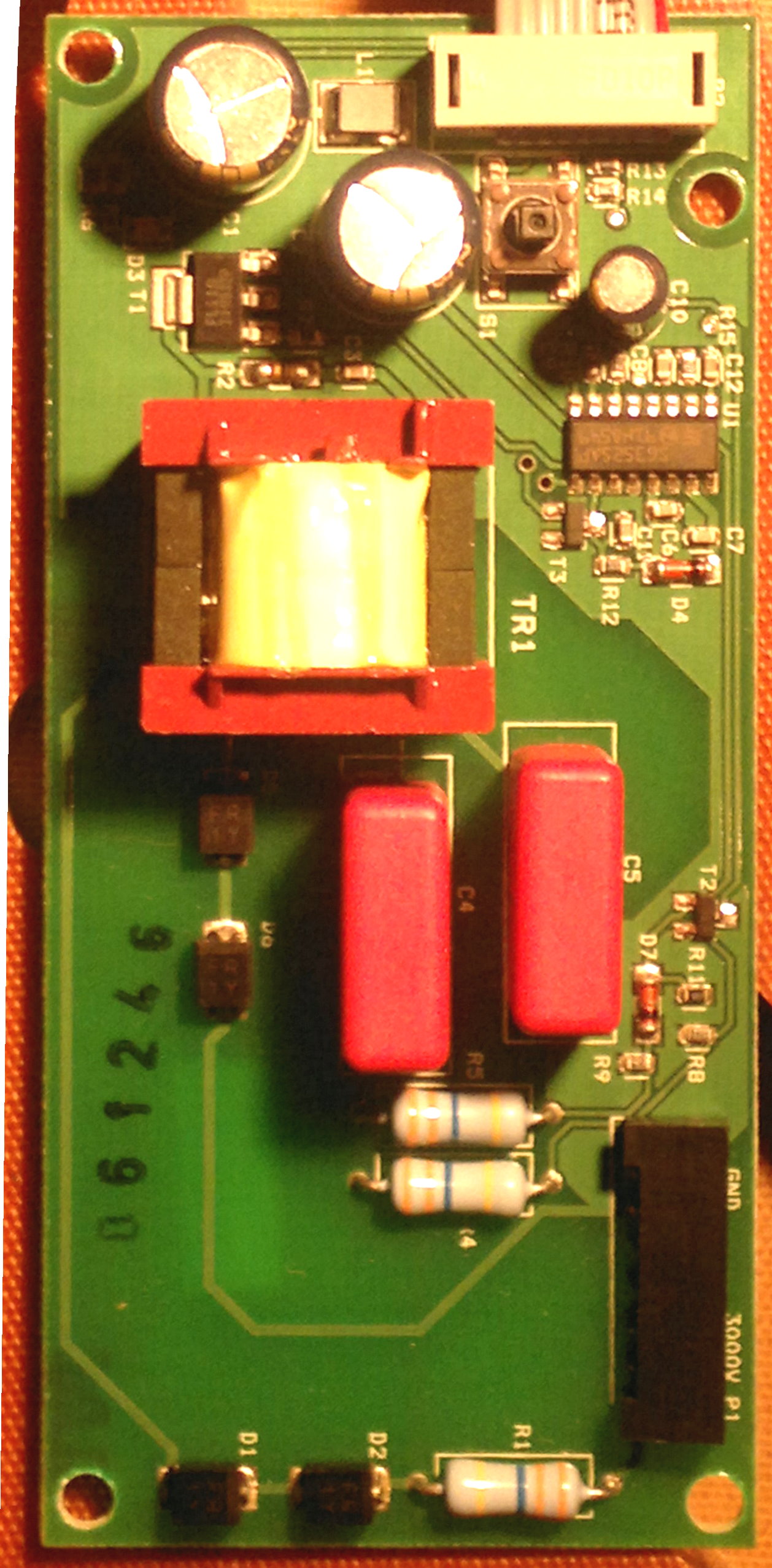

The PSU PCB are attached.

It looks like better performance is had by applying the pattern to the back of the top vinyl film film. Possibly screen printing?
The platten was attached with 4 screws. Counterbored, recessed and was surrounded by an insulating material.
I tried to apply tracks on the top surface with graphite spray, turned to be unreliable and high resistance.
The tracks are now copper foil then 0.2mm double sided 3M 9088 Polyester tape that gles backin of 0.6mm PVC or PP.
How can I increase voltage to 5000V? I attached my schematic.
I looked on ebay for cheap DC to HV power supplies and can't find anything in 5000V range?
Perhaps I can add few caps and diodes to increase the voltage further to 5000V?

Found this project https://github.com/Jan--Henrik/electrostatic-adhesion-plate/tree/master/DINA5
What capacitors and diodes do I need? SMD? The project does not mention any specifcations for parts. Now how stupid is that?
The caps seems like polarized ones either.

I agree, but the electrosttic force is too low to be usable. Perhaps the 33M safety resistor should be lowered the current perhaps too has an impact of how strong the electrostatic force will be?
