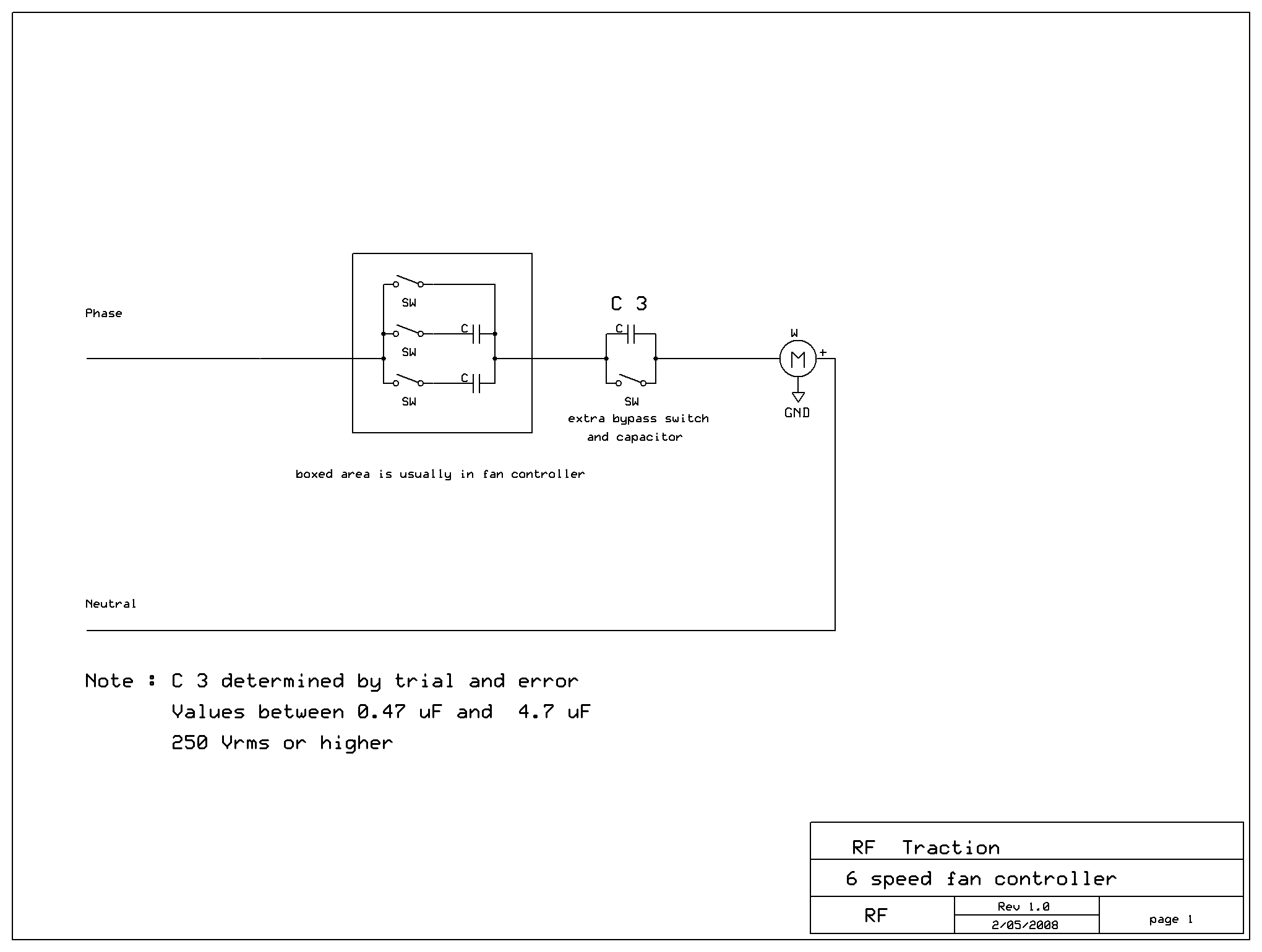

I m trying to design a hum free 5 speed electronic fan regulator. Input voltage is 220vac. The cycles/hz must remain at 50 cycles/hz at all speeds. can anybody help me out?

Motor is Ac type. the one used in ceiling fans
input voltage means the input voltage to the circuit like u hav 110 in us and 240 in uk.
hum is the sound produced by the motor when the cycles r less then r greater than 50 and the circuit is for the ceiling electric fan.
wat i require is that at speed 1 the ceiling fan should b doing 350rpm with 50cycles
at speed 2 the ceiling fan shuld move at 290rpm with 50 cycles
at speed 3 240rpm with 50 cycles
at speed 4 180rpm with 50 cycles
at speed 5 120 rpm with 50 cycles
reducing voltage is not a prob. d prob i m facing is that i m unable to contorl d cycles. i want to make the cycles stable at 50...

Generally ceiling fan motors are induction motors and speed control is achieved via an autotransformer or series capacitor which reduced the voltage.
The motor gets a lower voltage, less torque, slip increases and reduced speed.
I have succesfully modified 3 speed ceiling fans to 6 speed as well an plug in fans which often are 3 speed to 6 speed to have a very slow speed available.
I use capacitors and a bypass switch.
Ensure the caps are mains rated. 600 Volts ac or more and ensure safe wiring practises, because 220 volts is dangerous if you don't know what you are doing.

As Atif butt82 requested a schema to be drawn via a PM here it is.
Most portable fans have 4 switches, mechanically interlocked ( drawn in the box of schema ) to get 3 speeds. Leave as it is.
Celing fans may have a capacitor arrangement with a rotary switch or an autotransformer.
Add the extra switch and capacitor C 3.
By choosing the correct value the desired low speed can be obtained.
A bit of experimenting may be required.
The X2 class mains rated Caps work great. My room ceiling fan has 2 x 0.47 µF 250 Vrms in parrallel for C3 to obtain the lower 3 speeds.
(That is for 240 V 50Hz.)
As said before, you are working with lethal voltages so ensure that all wires are mains rated and sleeved so no danger of electrocution exists.
Hope this helps,
Regards, Raymond

thanx rodalco i hav got ur attachment but confused abt few thing. first how the voltage will drop at speed 2 n 3 with .47uf cap. and why to use a bypass switch? and secondary watz that 'M' in the circuit representing
M means motor (fan motor) in the schema.
The capacitor reduces the voltage to the motor by limiting the current flow. Also it causes a phase shift.
A capacitor doesn't get hot like a resistor.
This causes the motor to tun slower.
Basically the slip from the induction motor increases from the usual 3-4% to 40-60%.
The bypass switch is to run the fan at the top three speeds via the normal switches drawn in the black square.
