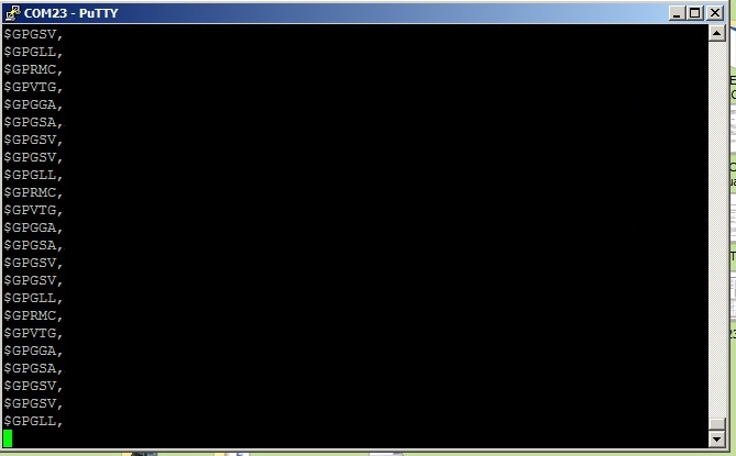

I've been round in circles, but now I can see the data on screen in PUTTY, in hindsight, it's not difficult.
I've been watching the data coming in and the strings are typical of NMEA data. I've attached a photo of what's coming from 'this' GPS module, with the actual location removed. I notice that the number of different sentences aren't consistent as I've counted 9 and in the posted image case there's 7. You will notice that there are 2 $GPGSV sentences next to each other, I've counted 4 the same in other instances.
Camerart.

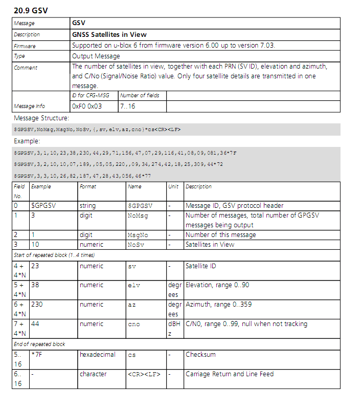

hi C,
I will look at the $GPGSV messages in the d/s.
The $GPGSV is the satellites in view message, so it may change.
Eric

E,
Actually, I was thinking about more of a calculation and chose $GPGGA, but $GPGSV shows amongst other things, Azimuth and Altitude. How I understand it, is, all I need are these two, and no calculation?
C.
C,
I believe that the Azimuth and Elevation are the actual satellite bearings in degrees, will this be accurate enough for your project.?
E
EDIT:
The GGA message will give the Ground position and Altitude above MSL
C,
E
EDIT:
I'm trying to remember not to think of it as satellite information, as it will be used for other things, so if it's ok, can we use SOURCE as a name instead, this will stop me being lulled into a false understanding. I need to research a bit more about this, to see if the simpler $GPGSV can be received from all of the likely SOURCEs.
Cheers, C.

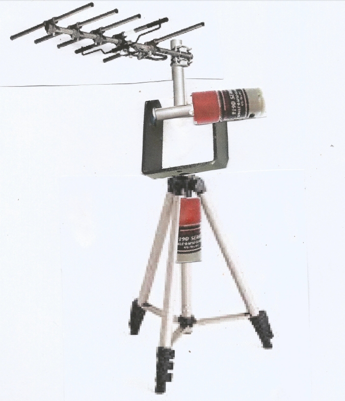

Hi Eric,
It is for aiming aerials at NMEA sources. As I said, I will have to research each of the formats the different sources transmit, in case I have to trim my cloth. If you take an example of a satellite, some of these are weak e,g, Funcubes, and need the aerial aiming towards them for a better signal. If you take one of my multicopters as an example, this also sometimes needs the aerial aiming towards it, especially if it goes behind foliage, also in the case of a multicopter, these send back video, and this is particularly poor at reception, so the receiving aerial is in parallel to the NMEA one. A data source could be an animal, and there are what are called fox hunts, that track a hidden transmitter.
The received signals are picked up via a radio receiver, and this is connected to the tracker though a PIC that commands the two motors on the tracker.
So the tracker is aimed at where the source might be, from previous calculations or knowledge, and once the tracker locks on, the system should take over.
I hope this clarifies things a bit, if not ask some more.
Cheers, C.

hi C,
What will be the receiving beam pattern for your Base station Yagi aerial.?
ie: beam width in the Horizontal and Vertical planes, at the maximum Range you will expect the remote Rover telemetry link to transmit from to the Base station.?
If you had a +/-5 Deg H and V for example, the arc-tan values could be in a Table in a PIC, say a 18F4520.
E

Hi E,
From what I understand there are different frequencies for each application, so the aerial/s would be attached to suit that particular one. Once I've got the data input sorted out, then the angles calculation, I'll try to find the speed of the system. The aerial/s will be designed round this. A few tests with simple aerials, then, make them up to suit, this will be last I think, as the aerial receiving angle will need to be within the system speed, but as sensitive as possible.
Camerart.
Hi C,
Whatever the App, it will have to be a directional aerial so that it can be pointed towards the remote transmitter, if its not directional ie: omnidirectional there is no purpose for a tracking system.
I would strongly advise that you focus on one App and try to avoid the trap of trying to make a universal unit.
E

Hi E,
I was hoping to only do this once, so I was trying to make it as universal as possible, at the early stage if possible. My first idea was to aim at my models, but at my amateur radio club they are making trackers that have pre calculated data, and I was hoping to make a 'live' one as something novel, and my thoughts are it would be more immediate and fun too.
I agree about the aerials being directional, and will need to make them to suit.
Edit: If I was forced to only have one SOURCE choice it would be for my models, which use similar GPS modules, that I have connected to Putty. The data will need to be transmitted back. My logic is to see how the tracker works first.
Camerart.
The problem area will be the arctan functions in the PIC.
If you had a directional aerial that had a beam width of 10 degrees, it would mean for a 90 degree quadrant you could use a short Table for the arctan.
So the Table would represent a 90 degree quadrant divided into say 18 sectors [values covering 5 degrees].
Use your Base station as the Datum, so reduce its N, E, to 0,0 and then normalise the received N, E ,GPS data relative to the Dataum 0,0.
This will give a Table pointer for the arctan/ angle.
E
