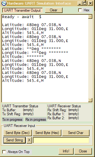

Cleaned up the draft prog, added some comments.
Note: the UART print out, the '*' are output when the sync char '$' is missed, the string is dumped.
E
'software uart receives data stream at 9600 baud And when char $ is detected we capture all bytes
'in array str1 until LF code.
'Then send these To the PC via hardware UART at 9600 baud
'COPY and PASTE this string.
'$GPGGA,123519,4807.038,N,01131.000,E,1,08,0.9,545.4,M,46.9,M,,*47?

This is a revised ISR, it uses the string location to pick off the N,E and M data
On Interrupt
Save System
PIR1.RCIF = 0
Hserin chr
If chr = "$" Then 'start
rxi = 0
Endif
str1(rxi) = chr
rxi = rxi + 1
If chr = "?" Then 'temp LF
For txi = 14 To 23
Hserout str1(txi)
Next txi
Hserout CrLf
For txi = 25 To 35
Hserout str1(txi)
Next txi
Hserout CrLf
For txi = 46 To 52
Hserout str1(txi)
Next txi
Hserout CrLf
Endif
Resume

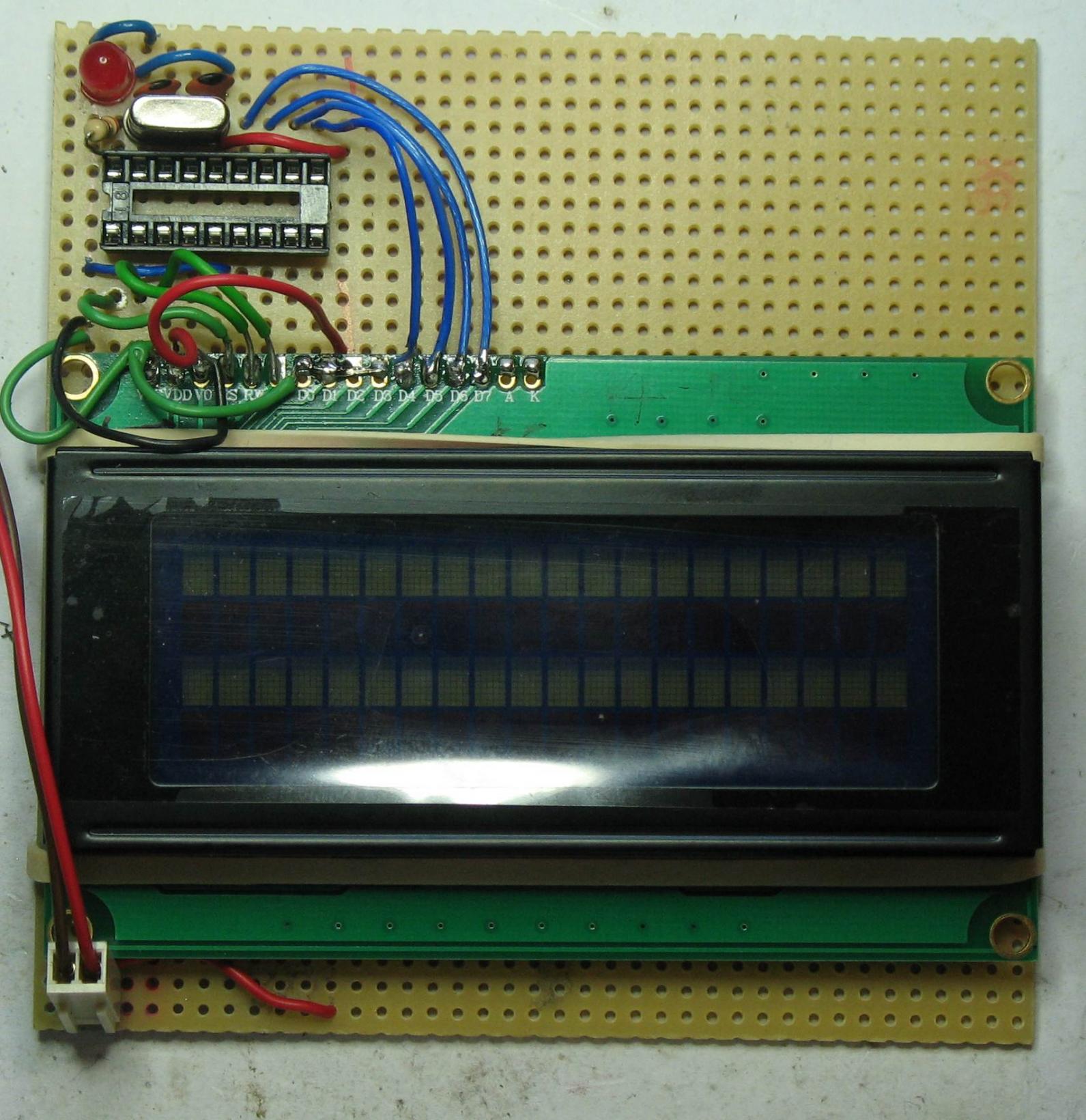

hi C,
Did you Rem out the Define SIMULATION_WAITMS_VALUE = 1 before you programmed the PIC.?
also do you have a datasheet for the GPS NMEA module so that I can check the RS232 levels.?
If you have a photo of the layout it would be helpful
E
hi C,
E
Hi E,
Yes, but I do forget sometimes:)
As requested:
EDIT I tried a toggle LED inside the LOOP, and it flashes in time with the GPS. (I used a logic probe)
C

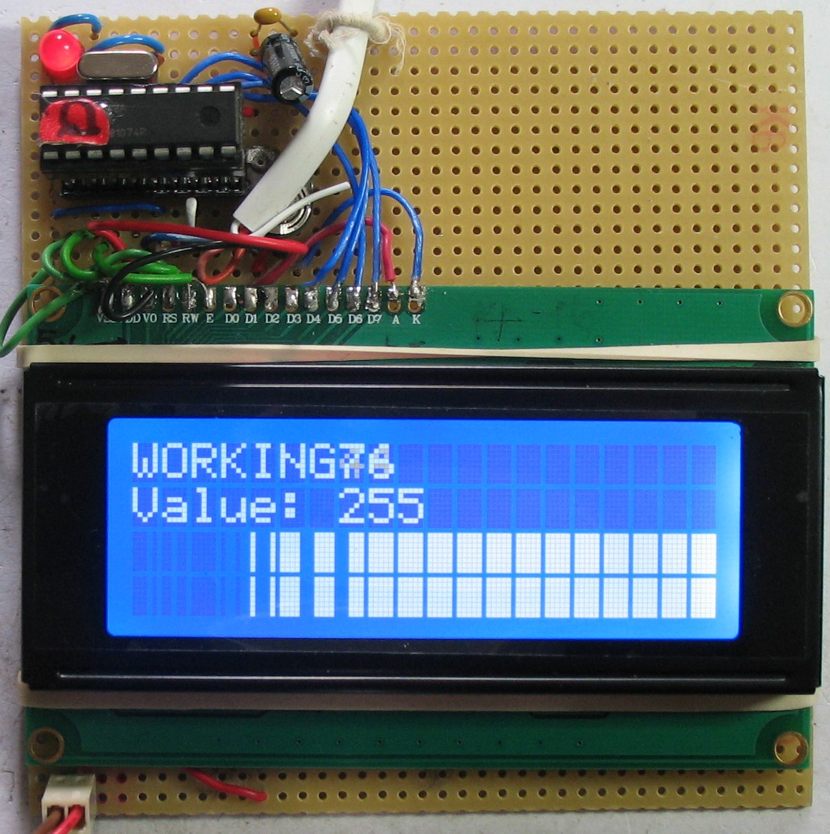

hi C,
Thats an old photo, showing the links on the LCD D0,1,2,3 and no Contrast pot.?
E
hi C,
E
Hi E,
True:facepalm:,
Here's one straight from the lab! Running one of my earlier programs. Both attached. Note the top number is changing, after a while it settles down to one number.
EDIT: D0,1,2,3 are not connected! I noticed and changed the incorrect TRISB pin to $00000010

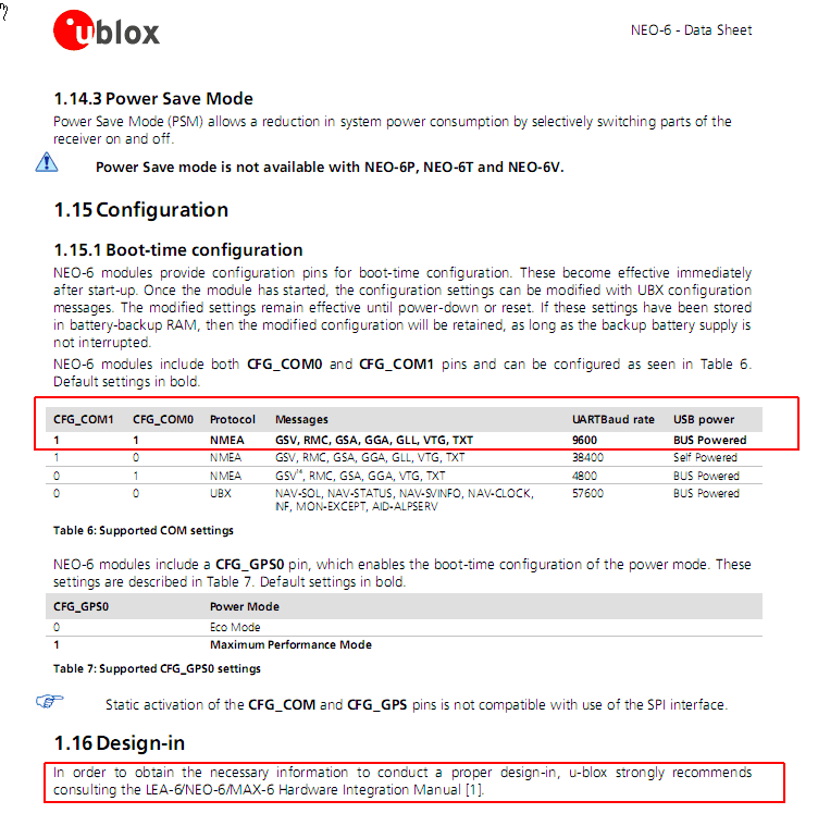

hi C,
As far I can see from the d/s for GPS module, it does not require RS232 'handshaking' to operate.
I checked the d/s for any requirement that GPS may for setting up/initialising, it just says CFG-COM1 and COM0 should be High, hard wired.
Looking at the NMEA Message Strings it does not show the $GPGGA header string you are using in your program.????
Read Section 1:16 of the d/s I have outlined in Red
Eric
EDIT:
I would advise the follow test.
Connect the NEO6 module to your PC via level shifter,[MAX232] use the PC 's Hyper Terminal to read and display exactly what is coming from the NEO
Or contact Ublox and confirm with them

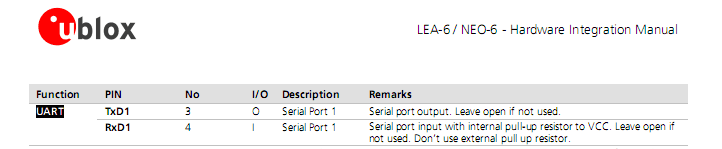

hi C,
I have tracked down the lea-6/neo-6 hardware integration manual, attached, I would suggest you use this reference.
Eric
EDIT:
Added the u-blox Receiver Protocol pdf.
You should now have all the information you require.
If I am reading the d/s correctly, the UART on the module needs to be initialised.

Hi Eric,
Thanks for tracking down the integration manual, and reading it.
Handshake OK.
I don't understand 'CFG-COM1 and COM0 should be High, hard wired'
I see the GGA string is there (hope I'm correct) No 4 in the list on AAesp01.gif. All sentences begin with $GP then the chosen type. I'll re-check!
I'll search for the GPS initialisation.
And try the MAX232 hyper-terminal suggestion.
And report back:)
hi C,
Eric
EDIT:
