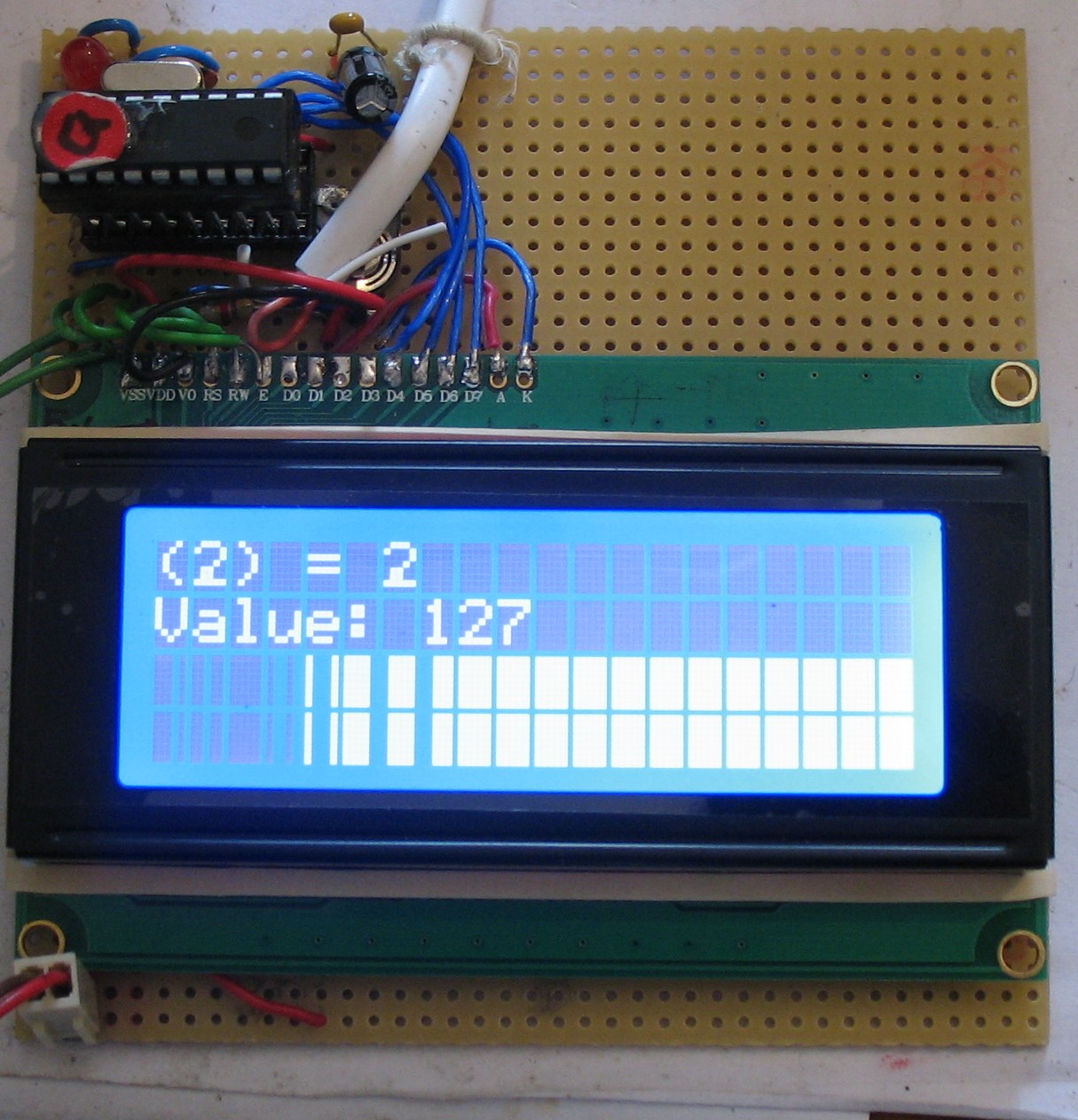

Hi E,
Here's a tidier program, sorry for the first! I've attached a photo of the result in the circuit. Where the '2s' are on the LCD, the numbers change and the indicator LED flashes.
E

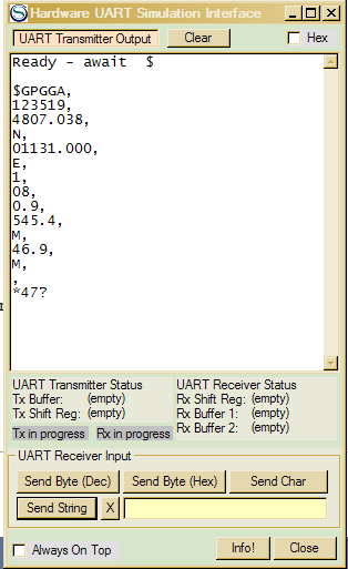

hi C,
I used the '$' to initiate the string test and capture, you will never have two NEMA strings being received at the same instant.
So test for the '$' character, save the whole string, then if required test for the GGA string, if valid process the string
If you only ever expect the $GPGGA section of the transmission on the serial input.?? Then parse out the N , E , M segments of the string
[tell me, where is your actual data string from and does have other string prefixes???]

Looking at your application, I would do it this way.
Use the internal UART to read the NMEA string.
Set the Hserin, UART to Interrupt on receiving a character, go to to ISR [intr service routine], IF the Character is $ then read the remainder of the string into a buffer array.
IF the Buffer string has the prefix GPGGA then its the one you want.
IIRC the string terminated with a CR LF code.??
Once you have the full string, look at the Index Pointer of your buffer array to find the Nnnnnn, Eeeeee and Mmmm values and then process them.
You can use the TX output of the Hserout to talk to your PC
E

hi C,
I have a draft program working using RX interrupts to capture the string into a buffer, I will post when its debugged.
If you are using the Hardware UART TOOL in the IDE, are you aware that you can Copy and Paste the $GPGGA.......... string into the UART text box.??
If you want to send the Line Feed Code at the end of the string you have to send 0A using the Send Hex... its a pain.
E
EDIT: Dont use # hash sign in front it will turn it into a Decimal!!
hi C,
Try this.
NOTE : I have terminated the string with a '?' character as a temporary substitute for the LF [ saves using the send hex]
Copy the string shown at the Top of the program and Paste it into the UART Send String Box, DONT include the Rem at the start.
This is a revised ISR, it uses the string location to pick off the N,E and M data
