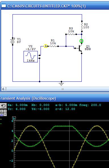

possible transistor solution
Hi guys
I’m just putting this out there if precision is not required.
If precision is required then i believe the opamp would be best.
Remember that the gain of the transistor which you would use would have to be considered. You will also need to consider the load on the output.
This circuit was just simulated, so I suggest that you wait for replies before building it.
what i understood is that he needs to invert the input . 0 in> 5 out, 1 in > 4 out, 2 in> 3 out, 3 in> 2 out, 4in> 1 out and 5 in> 0 out.
at zero input this circiut puts out five volt. i'm sorry , i should have noted that the output is at the collector of the transistor. the problem is that at 5 volt input , the output only drops to approx 0.8 v. this can be circomvented by decreasing the base resistor and choosing a high gain transistor. but this will also have an effect on the signal that is driving this circiut. remember that the input impedence of this circiut is bassically the base resistor.
