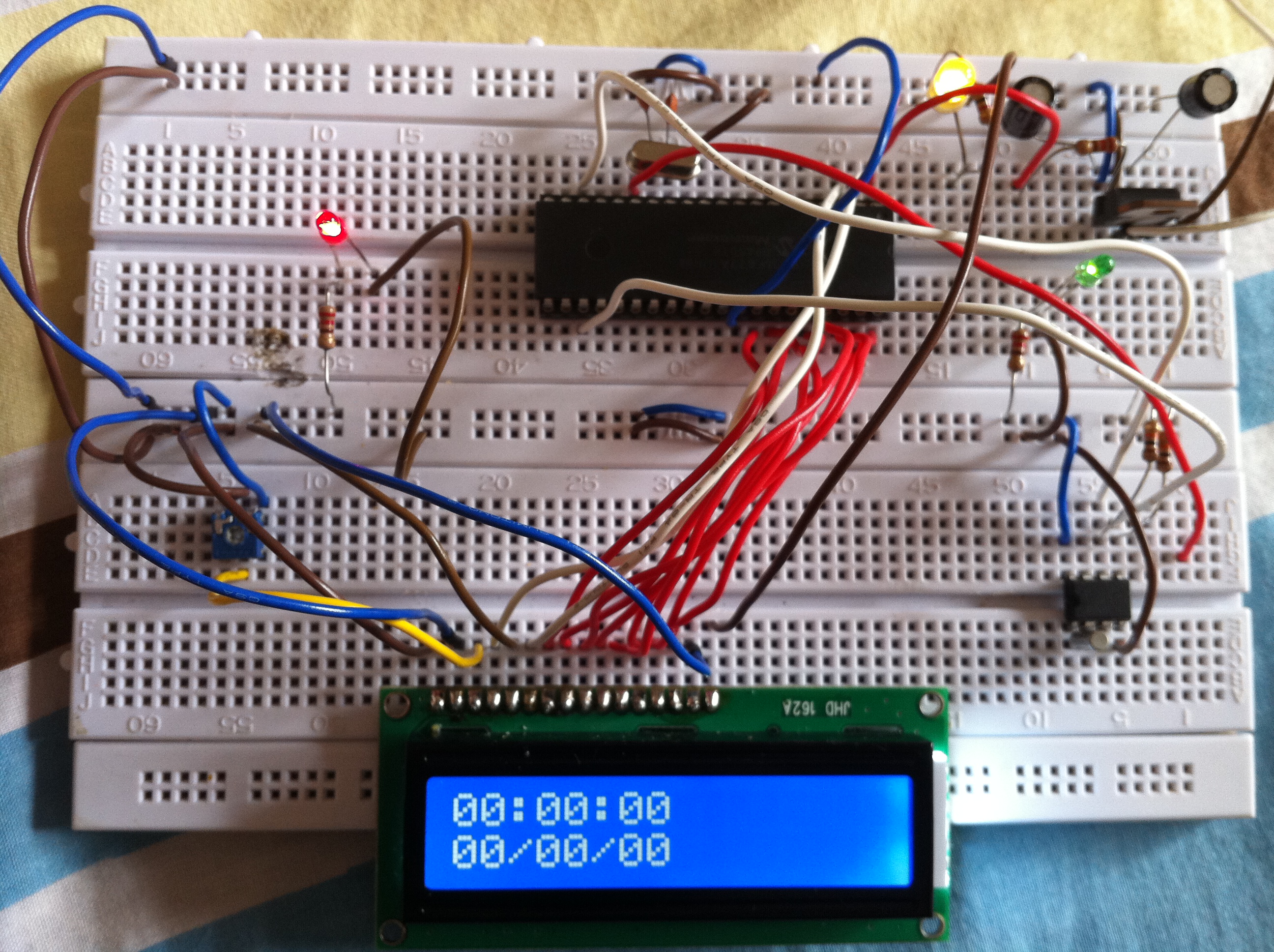

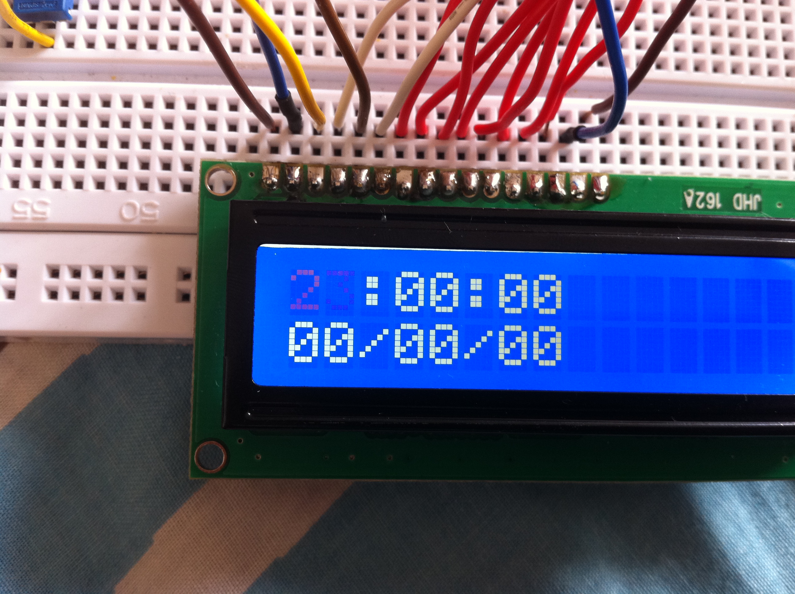

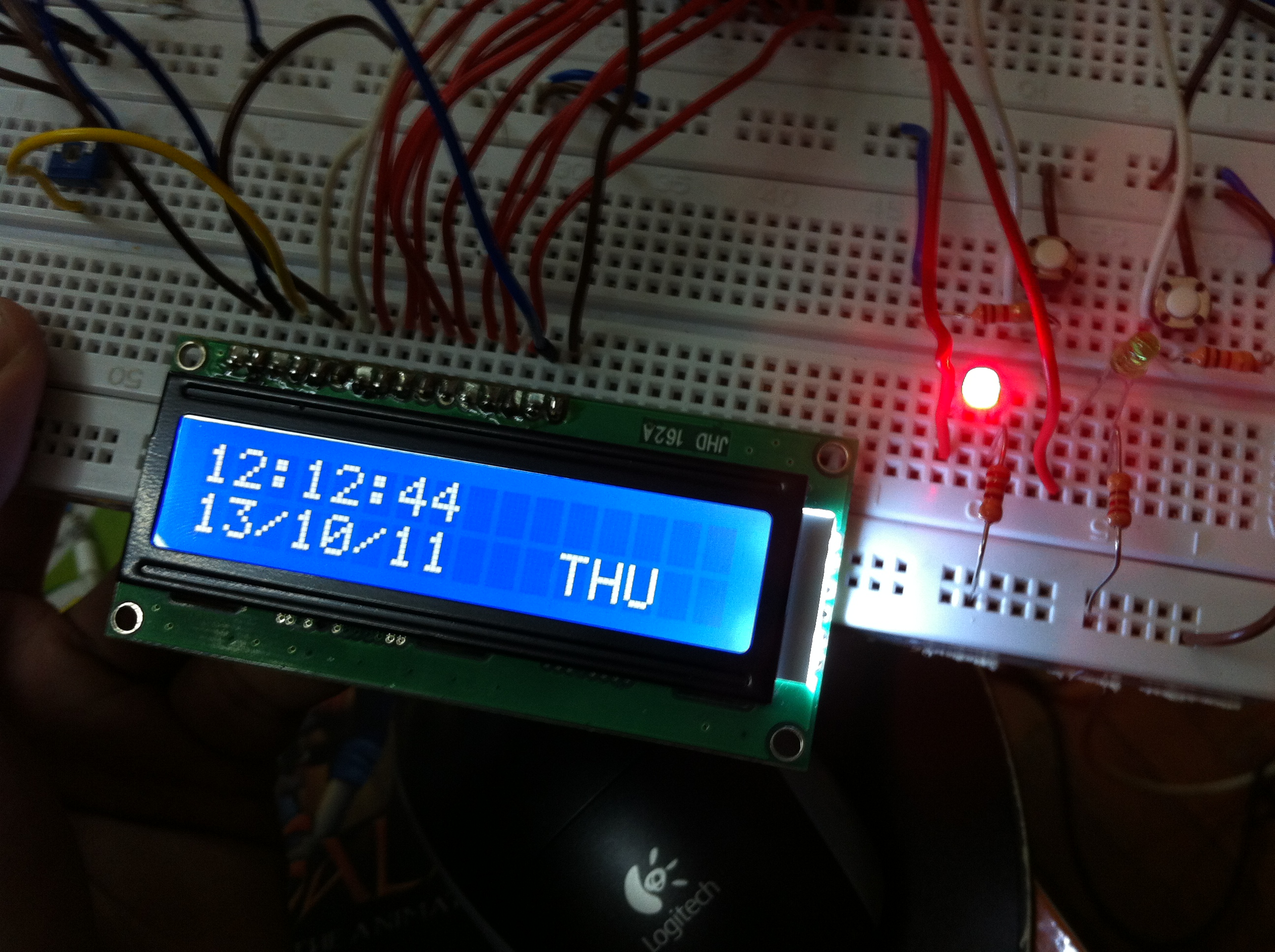

Rusttree,I have found something here.When I deactivated the first alarm and wait for the second alarm,is it I cannot touch the motion sensor?It is because when I wait for the second alarm,I have touched the motion sensor before,after that the second alarm no longer activated.Besides that,sometimes the second alarm does not activate after the first alarm activated and sometimes when the second alarm is activated and I touched the motion sensor but it can't deactivated the alarm.Is it the breadboard problem that cause the clock unstable?
No, for your low-frequency circuit, a breadboard is just fine. If it's not working on a breadboard, it won't work on a PCB.
You just have some bug in your code still. Post your new code and we'll see what we can find.
Ok Rusttree.I would say that the breadboard is unstable is because sometimes when I switch on the power,it will give me different output at the LCD with the same coding.So that's make me doubt that is the breadboard problem that makes the clock unstable.I have attached the pictures of different output that I faced before.Besides,I have also attached another 2 code for the function of DS1307 RTC which are i2c.c and i2c_rtc.c.

Rusttree,I think the LCD will give different output with the same coding is the problem of hardware.Now I'm trying to fix the instability of my clock.At the post #94,the problem I stated is it related to the bug of the code?Hope to see your reply soon.Thanks.
You misunderstood my suggested code in post #90 above. The "else if" was for the embedded if-statement, not the outside if-statement. The way you have it now, the "else if" will only execute when the current time no longer equals the alarm time. So once you snooze, the buzzer will only turn off again 60 seconds after the snooze alarm activates. That's definitely not what you want.
Revert back to your last iteration of code and made that "else if" part of the embedded if-statement. Post it again and I'll check to make sure you got it.
Oh.Seem like I really misunderstood what you mean in the post #90 above.So now I need to make the correction for the "else if" part only?I will post the latest code after I have done the correction.
