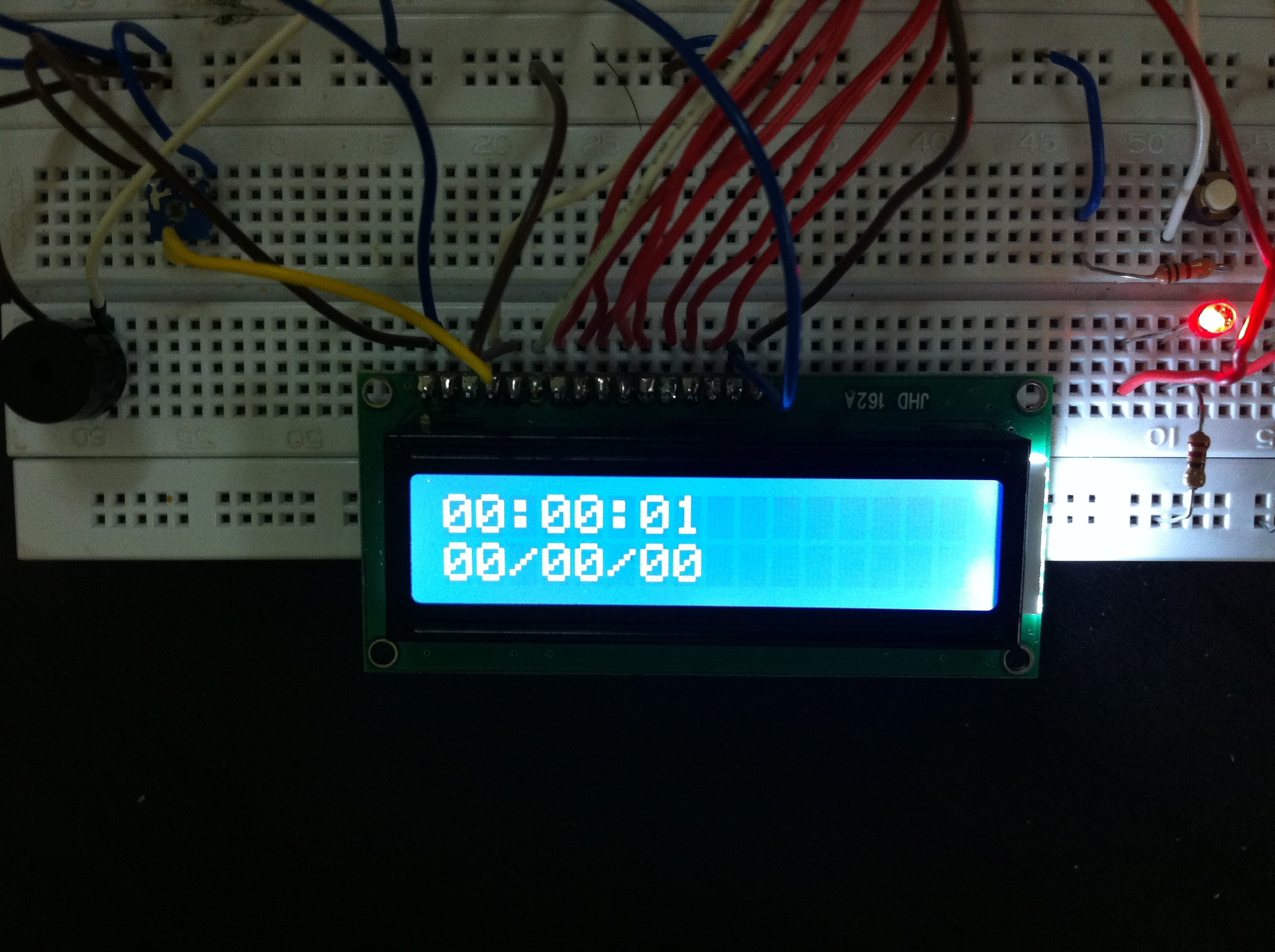

I hope the sensor can deactivate the alarm only when the buzzer is on.Any thing need to modify?Besides,I found one problem I'm facing now.As I set the alarm time to 1 minutes,when it reached 00:01,the buzzer does not on but after I turn off the voltage supply and turn on it again immediately,the buzzer is on.Is it unstable or is because there is a coding "if ((clkmin==alarmMin) && (clkhrs==alarmHrs) && (buffer==0))"?

I have attached the latest code here.Everything I'm written is at the "Read RTC function" there.I have tested it many times,the alarm still not stable.Because as I said at the previous post,when the alarm time is reached the alarm is in a deactivated mode(buzzer off).Besides,I can't get the idea how to move the logic that checks the sensor.

This is the photo of my LCD when I turn on the power.Anything that is regarding to that?

The alarm now is stable again after I tested it 3 times.I think the coding there can solve this problem if only check the sensor when the alarm is on.
Ok, not sure why you were having problems before.
Now, think about the conditions that are true when the alarm is on. The clock hours and alarm hours are equal, the clock minutes and alarm minutes are equal, and the motion sensor is inactive. Don't you already have an if-statement that checks for exactly those conditions? So if you moved the motion sensor logic into that if-statement, then the program will only check the motion sensor when the alarm is on.
