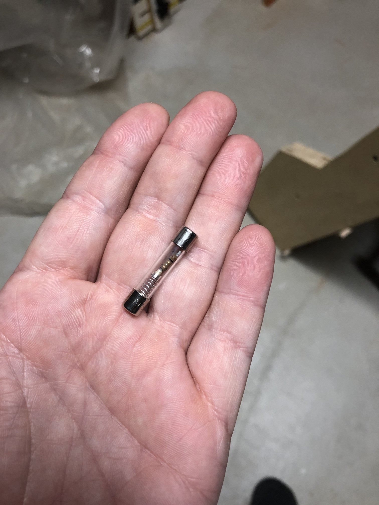

Hi All,

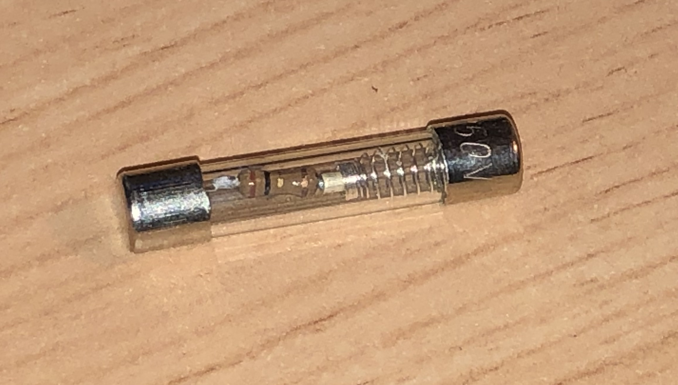

I've blown a fuse in my O-Scope. It's an AGC sized fuse, 0.5A, with a 1-ohm resistor inside. I've attached a pic. O-Scope has no power and the fuse is reading around 400K ohms.
I'm having difficulty locating a replacement. I'm wondering if I can replace it with a standard AGC 0.5A fuse, and also solder a 1-ohm 1/4 watt resistor in-line? Or a better idea?
I have confirmed that the scope works with a new standard ACG fuse. But I prefer not to run it like that since (I assume) it is meant to have this 1-ohm resistor fusey thing in there.
TIA!

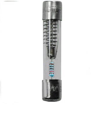

The resistor is attached at the spring end with a low temperature solder. Current flowing through the resistor causes the resistor to generate heat. When the resistor transfers enough heat to the low temperature solder, it melts and the spring pulls the circuit open. Over the last 50 years in electronics, I have seen these on occasion.
In normal operation, up to that 0.5 amp rating, the resistor will drop at a maximum 0.5 volts. Hardly significant in a 120 or 240 VAC supply.
Normally when they slo-blow, you will see the resistor separated from the spring. A severe overload can cause the resistor to open without creating enough heat to melt the solder.

I've seen resistors in fuses before too, including devices that looks like r's but without colour stripes.
I didnt know they were heaters though, thought it was some other reason.
Look up, "fusistor".
This is a less common permutation but fusistors, originally made by BelFuse have been around for 50+ years. Zenith TVs (pre-solid state) used them. They were originally sandblocks with crimpable lugs, then plastic capsules with blades that plugged into a socket.

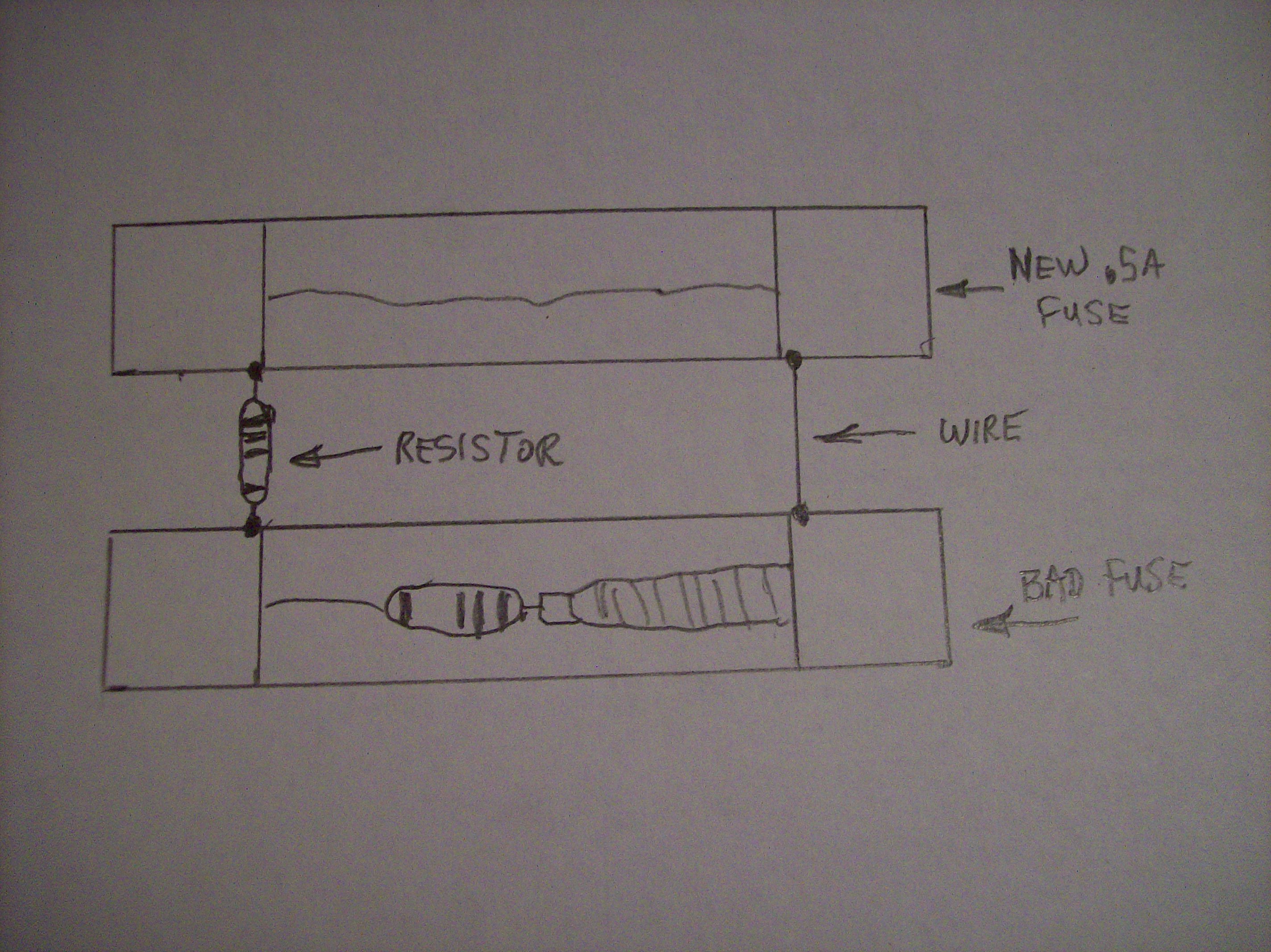

Get creative. If fuse fits into a clip in fuse block this will work. If fuse fits into a fuse body this will not work. Solder resistor, new fuse, short wire in series. Solder this in parallel with bad fuse.

They are not all that unusual. Just replace it with a same dimension slow blow fuse having the same current and voltage ratings found on the end caps.

That's about it. While not quite as common as those with just a spring / alloy mechanism I have run across them on a few occasions. If you look at a 0.5 amp Littlefuse Series 313 the fuse resistance is shown as cold 1.2600 Ohm so for what you have the resistor seems about right.

Get creative. If fuse fits into a clip in fuse block this will work. If fuse fits into a fuse body this will not work. Solder resistor, new fuse, short wire in series. Solder this in parallel with bad fuse.View attachment 120869
I don't think so. The resistor isn't there to just supply some resistance to the circuit that the fuse is part of, or else the resistor would be in that circuitry and not be inside of the fuse.
The resistor acts as a heating element. When the current through the resistor rises up to the melting point of the special low temperature solder, then the fuse opens.
You proposal wont work unless you duplicate the thermal behavior and mechanics of the original fuse.
A few points to consider:
  • The glass body contains heat for a greater temperature rise, whereas the external resistor has moving air past it to lower the temperature rise. It will probably still blow, but not at the intended current.
  • The melting point of the solder must be the same as the original
  • Even if you duplicated the solder to the original, the fact that your resistor is external (not constrained) means that when it did blow, the resistor (and possibly the rest of the patched on assembly) would then be floating around where it probably shouldn't be.
I am guessing there is also some spring tension on the spring to make sure the circuit disconnects (and stays disconnected) once the solder melts.
