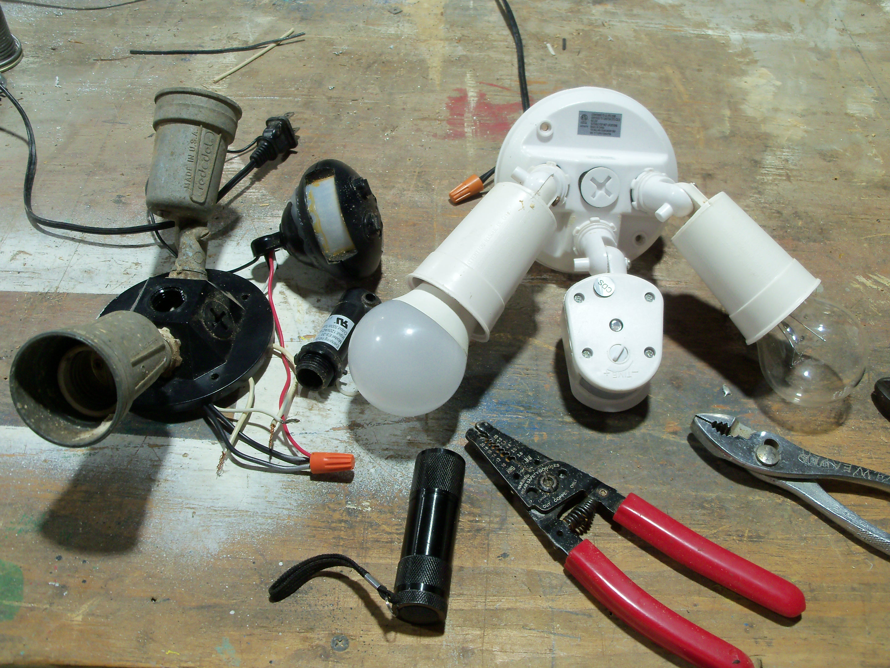

2 nights ago we had a thunder storm that killed 2 motion detector lights. One light stays ON all the time the 2 adjustments do nothing to turn it off. The other motion detector light does random flashes like a strobe light the adjustment does nothing to make is stop. We live in tornado alley I have a pile of a dozen dead motion detector lights. These use to cost $12 now they are $60 each. Circuit boards in lights have, LDR, motion sensor, 12 pin IC with no number, no burned parts.
Is there a way to protect these lights form lightning?
That sounds like an induced spike, rather than a direct strike to the power lines near the house.
A good size VDR (eg. a Zenamic or similar) across each light would likely reduce or eliminate damage of that level.

Your motion detectors seem to be AC powered. Thus, they may be more sensitive to a pulse on the power line that other household appliances. One solution is a "whole house surge protector", a device that wires directly into your electrical panel, and will absorb surges. It is basically the same as a power bar with surge protection, just that it does the entire house wiring instead.
If they failed because of a nearby hit and the EMP caused them to fail (not via power line), not much you can do about that in practical terms. That is due to the design of the device, whether it has any internal protection or not (most don't, to save costs)
Plus, you need a proper circuit breaker wired to your panel. Get an electrician to install it.
