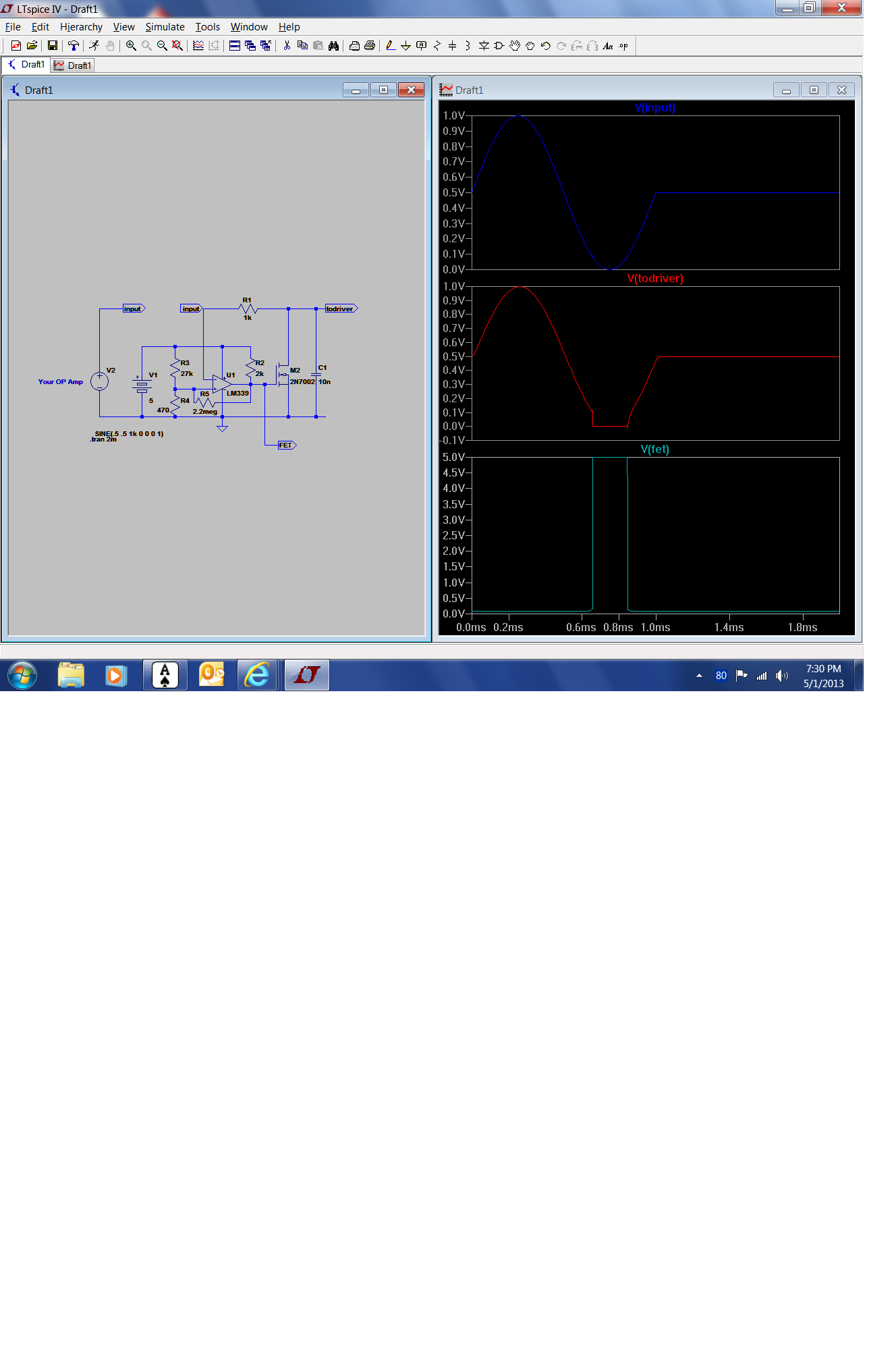

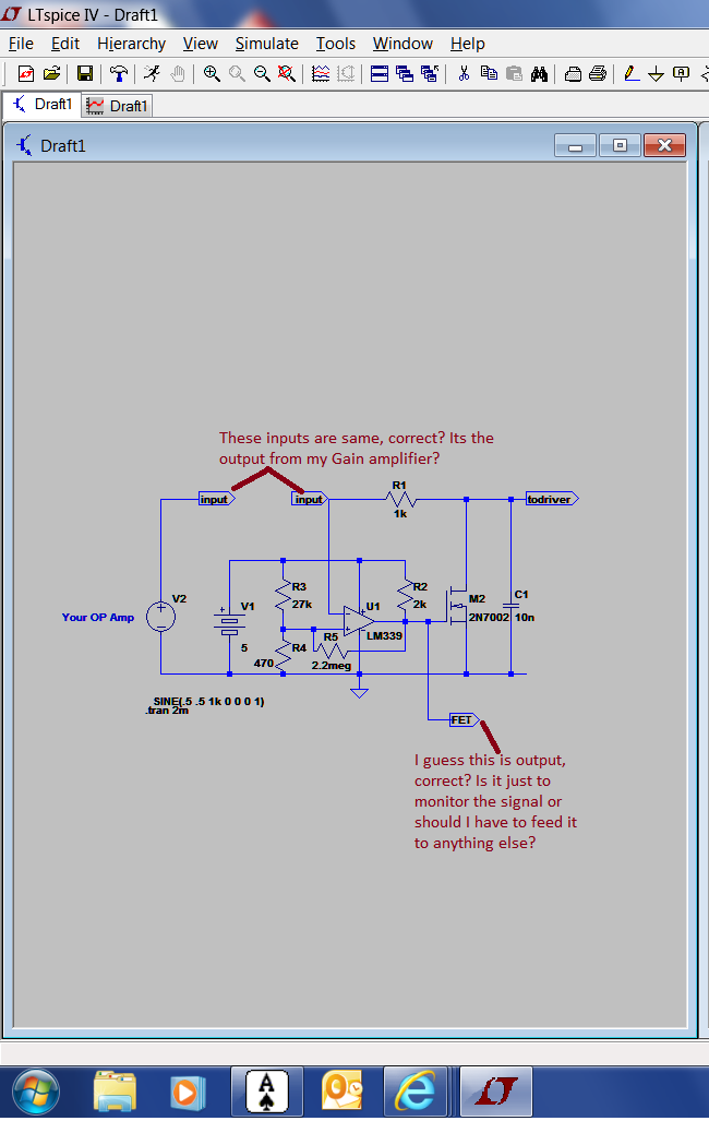

I think something like this is what WTP is talking about.
The 339 comparator turns on the FET when the input voltage goes to about 85mv shorting the input to your driver to ground.
I should ask if you know the input impedance of the driver to make sure the 1k in series with the signal doesn't mess it up.

Thanks for your suggestion, I will definitely try your setup and see how it performs.
The manufacturer specs states that the input impedance as 50Ω. But I have ot mention that the lower limit for the FET to turn on must be very low (lower than 85mV), this is because the resolution of the driver is pretty good that we drive it with DAC resolution of 10bit from 0-1V.

I have a couple of questions about your schematic. It would be great if you can clarify me on those.. so that I can try it out.

Yes, the ones on the right are the same point and the output from your op amp. The other is just a test point so you can see where the waveform and where it switches.
But I don't think it will work because the voltage drop across the 1k will be to large driving into the 50 ohm load.

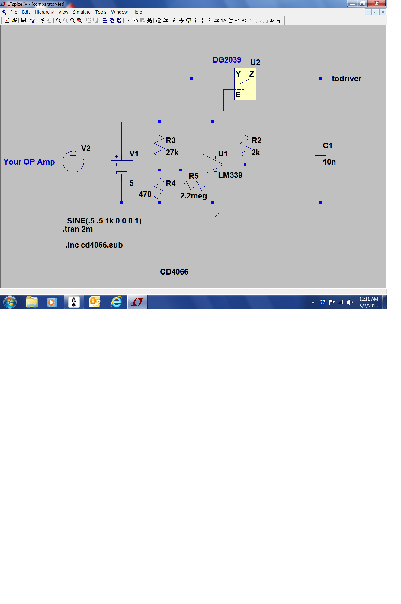

A better solution might be to use a switch like a DG2039 to open the signal from your op amp to the laser. I guess I was confused by

Something like this:
It would open the circuit when the voltage gets close to zero. The only other way I can think of if this won't work would be to try to clean up the noise.

All these switches seems to have off voltage of <0.8V, but we need it to be OFF below 0.9mV, does your schematic still work?

No, since you have 11 mv of noise it would need to be set higher than that or it would go on and off with the noise and you would have the same problem.
Do you have coax from your op amp to the driver? What does the noise look like? What op amp are you using?
