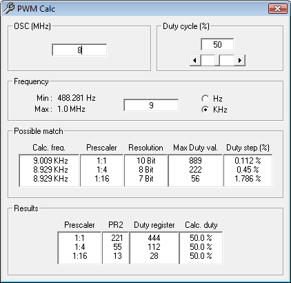

There is another way with the PWM registers, which I've never used. However, a PIC calculator (Mister E PIC Multicalc) comes up with these values to try:
Again, these are suggestions to try. The 1:1 prescaler option seems the closest to 9khz. You have to figure out the PWM registers based on the PIC you are using, and adjust values based on what you actually get in real life... For the 16F628a, read section 9.0 and 9.3 of the datasheet. The problem with PWM is that the output pin is fixed to RB3 (port B, pin 3) as pin 9 on the IC (18 pin DIP)
You need a cycle every 111 clock cycles. Use a 4MHz crystal, set PR2 to 111, tmr2 to 1:1 prescaler and PWM on with CCPR1L set to 55 and you should get 9KHz on RB3.
Just follow the setup steps in section 9.3 of the data sheet.
Edit you main code can just be an infinite loop.
Edit2, I see I was beeten to it by Sagor. Double the above figures for a 8M crystal.

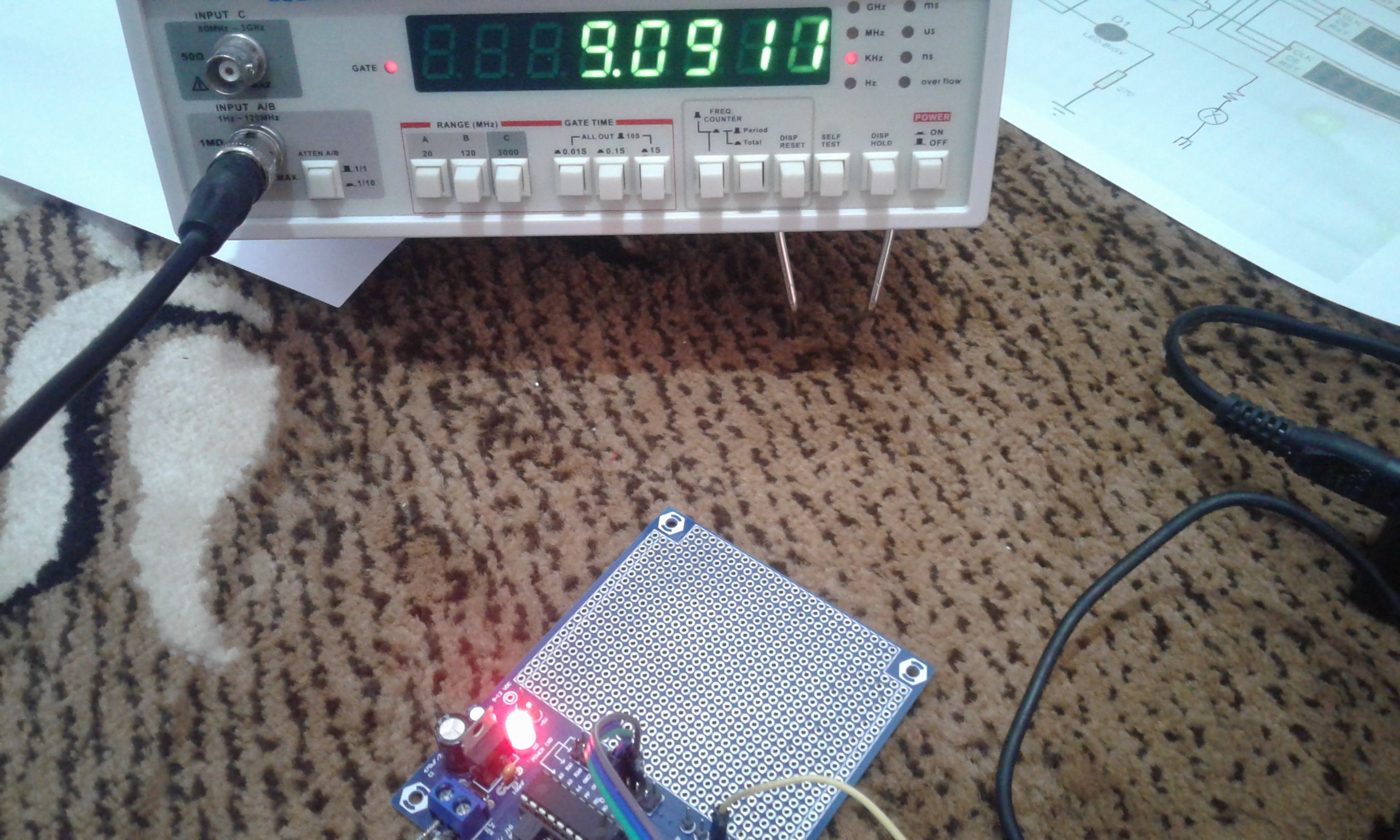

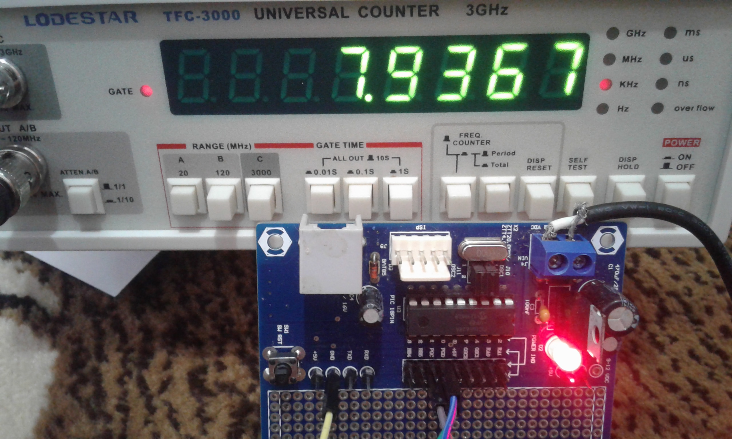

Today I just tested the project to real hardware, please see on picture attached.
As well as you saying that TMRO not changing to 161, I measure it to frequency counter it will be around 7936 Hz or 7,936 Khz for TMRO 145, it will be around 90911 Hz 20180728_144607.jpg
if I put the value to 161 for TMRO.
At a moment I don't have a crystal for those 3.6Mhz, 7.2Mhz or 18Mhz, last night I checking to online store, I prefer for crystal 7.2Mhz and 18Mhz, those crystal are easy I found in store than 3.6Mhz.

I find your results strange, according to the documentation. Are you sure you are running off the external 8Mhz crystal, in HS mode (not XT)? Did you check the input crystal frequency from the crystal to confirm it is running at 8Mhz? Some crystals can be known to be bad. Is there the required 30pF capacitors on each crystal lead to ground? (30pF can be anywhere from 22pF to over 50pF, depending on board/make). In some cases, the board expects you to insert the caps. Hard to see in your picture if there are caps or not, they may be underneath.
I don't doubt your experiment results, you can clearly see the frequency output. It is just that it does not match what all the calculations say it should be. Mind you, using TMR0 means you are trying the interrupt method. If there is anything else running interrupts, that can throw the timings off. Also, make sure you are not mixing up decimal and hex values.
Try this site:
http://www.micro-examples.com/public/microex-navig/doc/097-pwm-calculator.html
and see what the register values should be. Results are in binary (8 bits), so you can insert those directly. It shows the code in C, but you can use those values in Oshonsoft.

True Nigel. I was just wondering about his overall hardware setup...
To MINI: if you insist on staying with the interrupt routines, and use that 161 for TMR0, you can probably slow down that 9091kHz frequency by adding a NOP instruction in the actual interrupt routine to slow that frequency down. Then measure again. Keep adding NOPs until you get real close to that 9000Hz. Not sure how good an idea that is, but no harm trying it.
