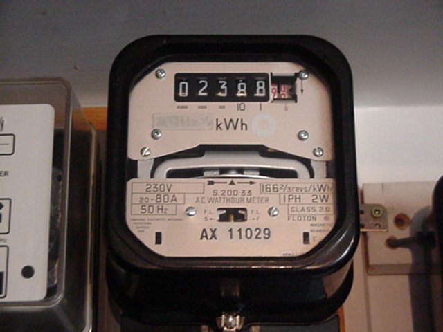

kWh meter
Get a utility kWh meter,
there are a lot very new ones and on the bay or get one from the powerboard for less 20 bucks.
Put that on your 120 or 230 volts supply.
Do a 24 hour or week measurement with it.
Put it on a board with a plug and socket and you can use it for other projects as well.
Just my 0.02 on the topic

kWh meter
a kWh meter like this
