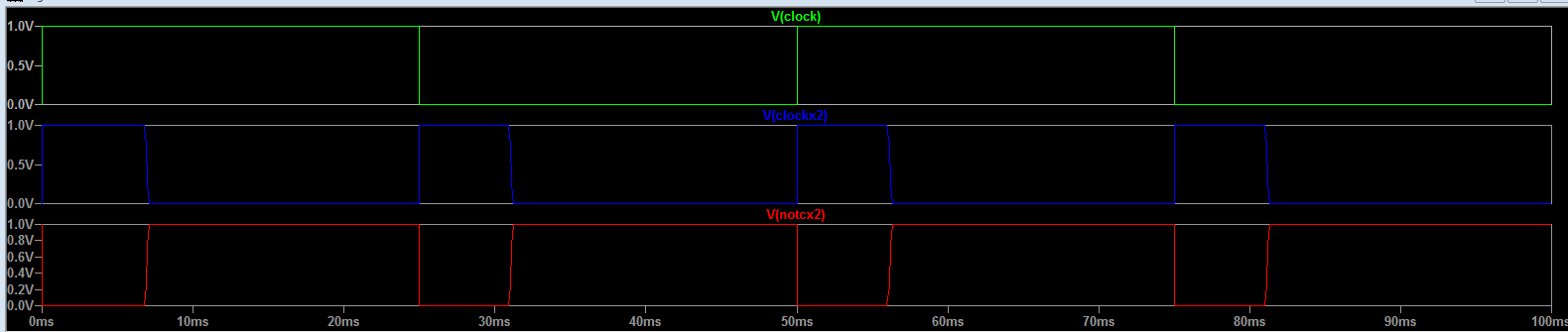

Green trace is the original clock. Blue trace is 2X clock. Here the CD4040 will count on the falling edge which is in the wrong place.
The red trace is the inverse of the blue trace. Here the 4040 will count on the falling edge and be in the right place.

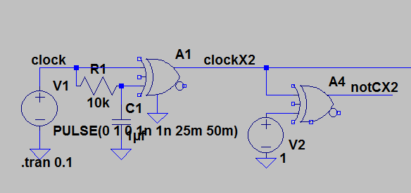

Here I am using a XOR gate to do the 2X and a XOR gate to invert.

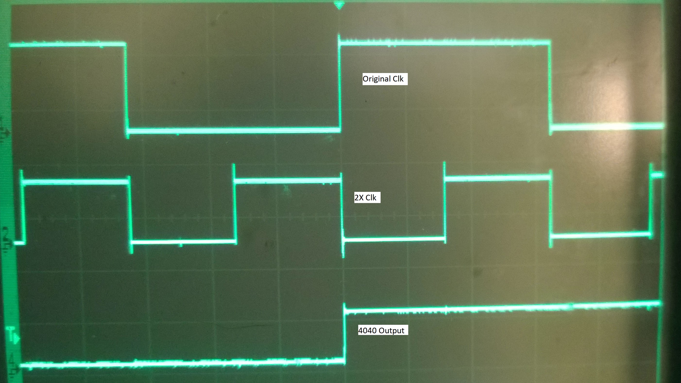

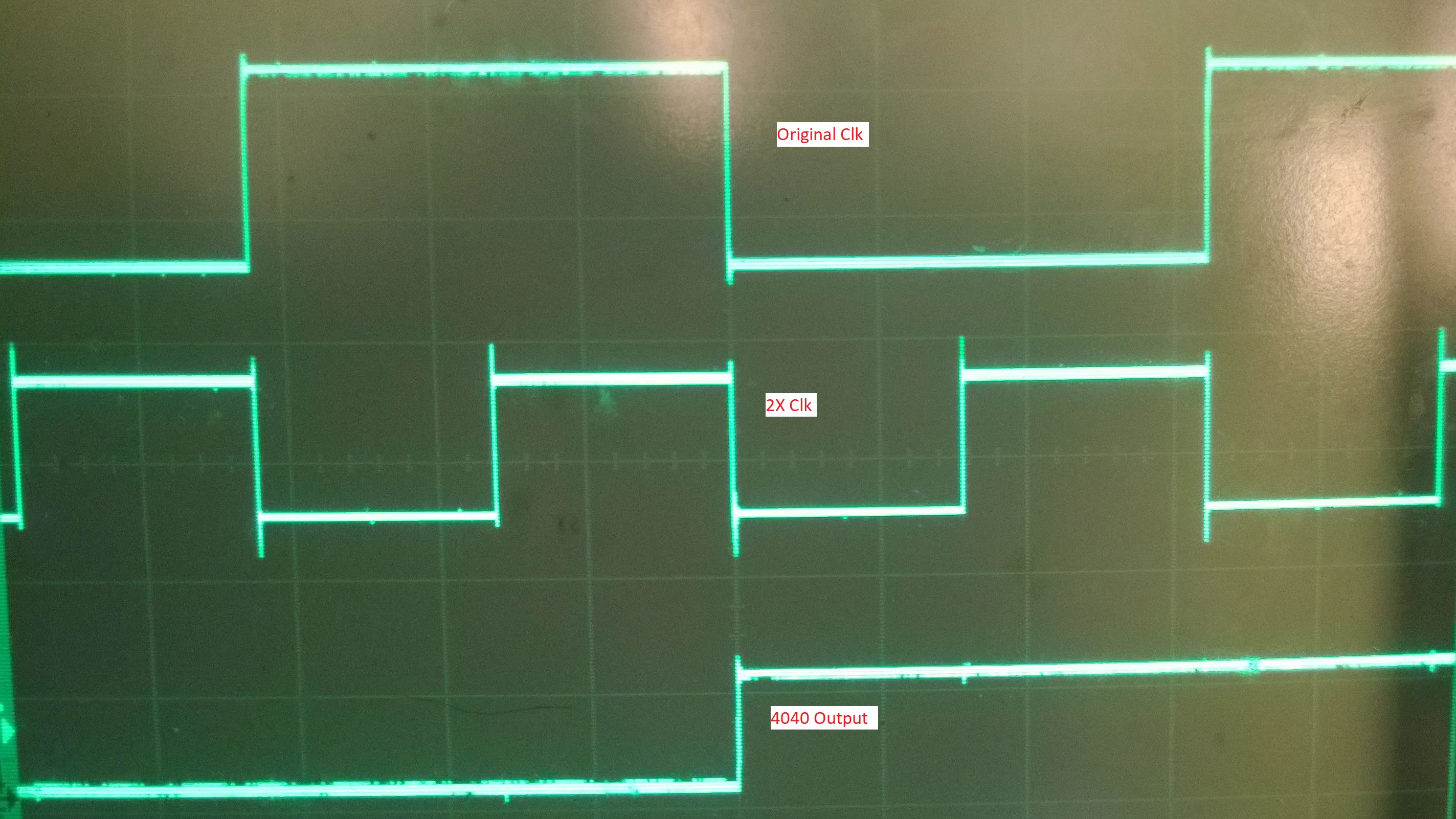

Here are some labeled screenshots of my signals. As we can see, the 2x clk has 2 falling edges for a given original clk cycle, so its arbitrary for 4040 as to which one it chooses and that can be seen here. I am not sure if there is a way to lock it to the falling edge of the 2x clk that coincides with the original clk's rising edge.
If you do that you are using only half of the double-frequency signal, so you might just as well forget about doubling the frequency and simply clock the 4040 with the original signal.
I have to use the 2x clock in this situation where my 4040 is connected to a DAC.
So none of us understood from your words. Different problem.
Picture below. Bottom trace is not Q1 but Q3 or 4 or ....
Look at Q1. It will change state on every falling edge. But we do not know which falling edge will cause Q2 to flip over.
Look at Original Clock and Q1. They will be in phase or our of phase. There will be some delay but they will be 99.5% together or 99.5% wrong.
So add a XOR gate looking at the two. The output of the XOR will be "good" for 99.5% or "bad" for 99.5% of the time. Add a RC on the output with a time constant to hide the small spikes (0.5% of the time) After the filter (RC) the output should be 1 or 0 all the time depending on which condition.
