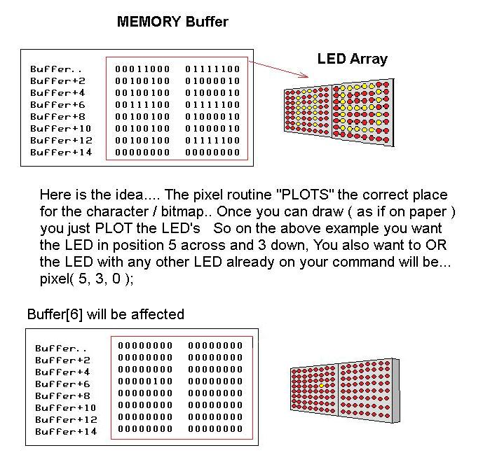

What do you mean... The font IS in an arry... fnt[];..
When you specify an array with no size... then initialize with the contents, the array can be traversed through like any array..
one more question can't we send the buffer data in such away that the connection LEFT to right or it s opp right to left can be changed by software......
I use the method that EVERYONE else uses... That way you can grab fonts of the web and also font creating software has it this way round...
Ritesh...
Look at this..... To fully understand "plotting pixels"
You make a pixel routine to identify the bits (LED's) in a picture so you can turn them off or on
The LED's are in an array of 32x8... We draw a picture to fit
As you can see the pixels match the screen..
We we plot the pixels we make the buffer the same shape as the array of LED's ie 4 bytes in a row and 8 rows.
to locate ANY LED within the array... take 5 across and 3 down from the left.. We normally call the variables x and y..
y is 3 down so we need 3 rows of 4 bytes.. and as its in the next row we now work out how far across x is there are 8 leds to one byte
so LED will be in buffer [ 3 * 4 + 5 / 8 ].. so buffer[13]...The pixel is modulus 8 5 mod 8 = 5.. The pow table selects the bit_weight.... pow[5] = bit 4...
The bits are right to left ( same as the T6963C) to rotate them just mirror the POW table...

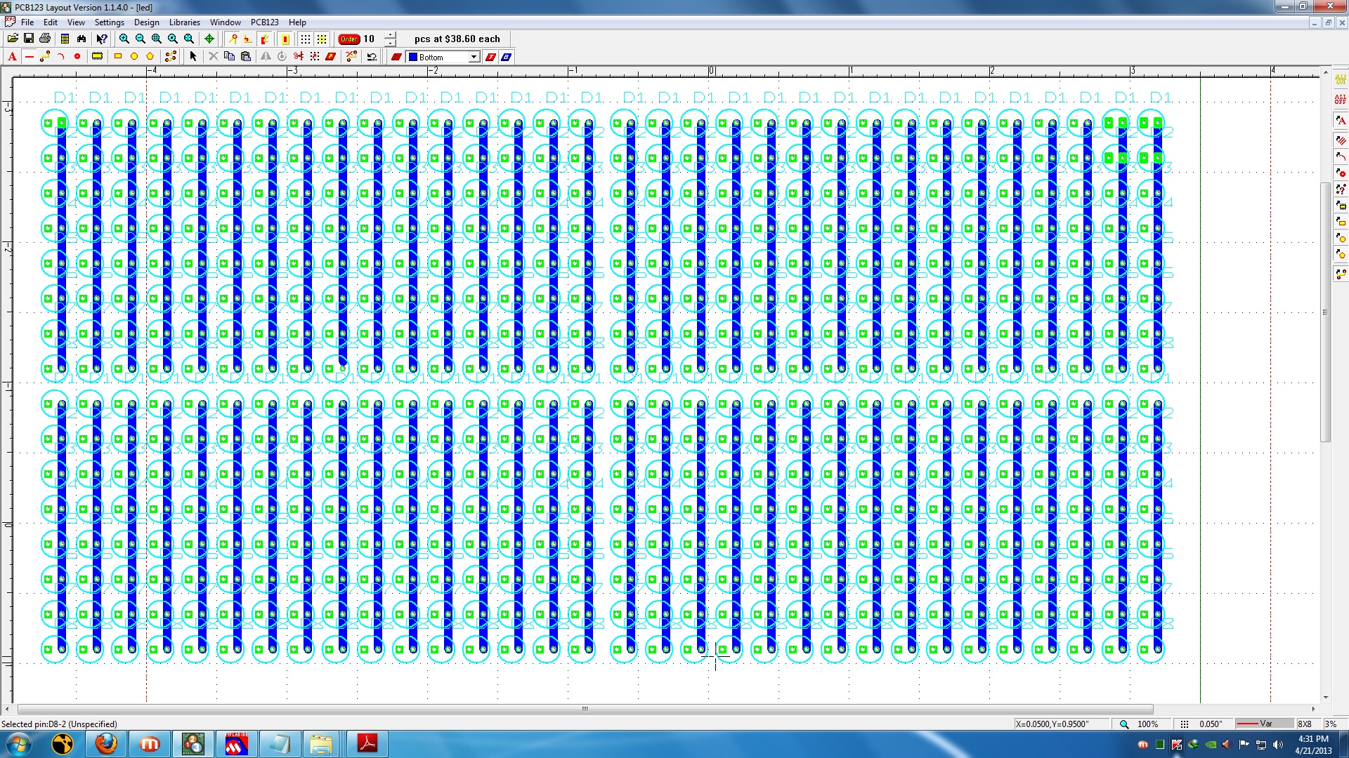

HI,
I am working on LED display PCB designing so, i need to what will be better for scanning :
1. The column connected as we were doing originally in past ||||||||| like this?
2. The Row section connection as you suggest in previous post??
1 2 3 4
5 6 7 8 like this??
and which shift register to be use 74hc164 or any other???
I need help how to design PCB layout for 16x32 display here it is...i mean to say how to do connection???

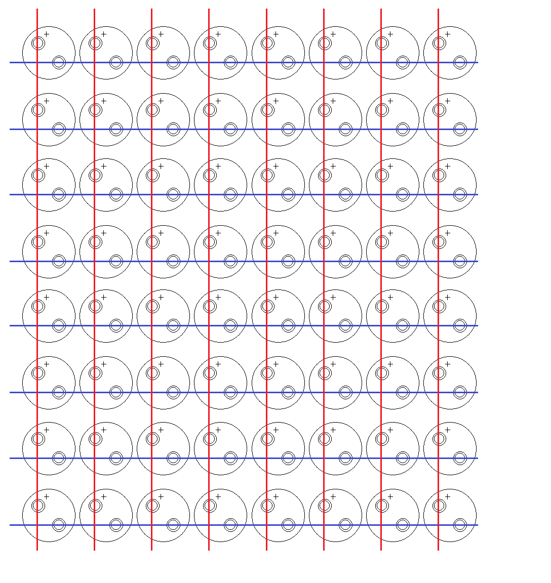

You have started down the route of column scanning again..
Look at this picture.. If you offset the led's by 45°, you can use straight tracks to make it easier.
The RED tracks are row connections.. The blue tracks are connected to the shift registers.
NO no, i am ding ROw scainning please ignore that blue line on layout just tell me for Row scanning which you have suggested!!
If you connect as the picture I posted you should be good to go ( I suppose it doesn't matter which way you connect them )
As long as all the columns connect to the DATA and all the rows connect to the shift registers..
