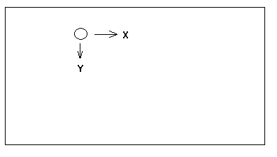

OK, Now i am going step by step ( making code is so difficult sometimes)....
The ball bouncing on screen will be my first step....

I just increase x and y by one if y gets bigger than height... decrease y.. If x gets bigger than the width decrease x..
I used a direction control... either 1 or -1.. Then toggle the direction when you hit an edge..

C:
struct{
   signed  int x;
   signed int y;
} ball;
If ball.y > height - ballheight
   y_direction = -1;
if ball.y < 0
   y_direction = 1;
If ball.x > width - ballwidth
   x_direction = -1;
if ball.x < 0
   x_direction = 1;
ball.x += x_direction;
ball.y += y_direction;
This way the ball will stay in play..
OK, I am just thinking how to use i mean setting parameters for ball height and height lite bit confusing....
