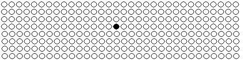

Once you have your on screen buffer, which is exactly the same size as your screen, you can draw to the screen with any shape, line, text, etc...
Imagine you have a blank square of paper.. You draw an image on the paper... You clear the paper quickly and redraw the image... Animation!!
You don't have to worry about shifting the buffers... The buffers are just memory locations..
There two are functions in my code... One is clr() and the other is blit() ... clr() clears the buffer and blit() puts the buffer onto the led..
Lets assume I give you a routine to draw a circle ANYWHERE on the LED screen and any size ( even if its too big for the screen )..
start a loop
for(x=1;x<16;x++)
   clr(); // clear the buffer.
   circle(16,4,x,0);  // circle at 16, 4 with an 'x' radius..
   blit(); // redraw the LED screen.
   __delay_ms(100) // time to view.
what will appear on the LED display will be a dot right in the middle ( x=1).
then it will draw the circle bigger and bigger clearing the LED's each loop so it looks like the circle grows until it cant be seen..
I have written the equation for circle:-
X1= X-N AND X+1
Y1=Y-N AND Y+N
WHERE N=1,2,3,4........
but how to fill the in memory buffer???
as we do for char was simple but in this i am not getting how to do, pls help..
The pixel routine writes to the correct memory location... Each routine.. Box, Line, Circle etc plots the positions then they call the pixel routine
Once you have finished drawing onto the buffer, the bit function places the drawing onto the LED array.... I can't see why you don't get it!!

You don't need to know what pixel does..... Pixel() puts a LED on or off at position x,y... the last parameter is condition... Or , Xor and AND..
If you want the LED at co-ordinates 16, 4 ( centre), on the display to be lit... then you call...
pixel(16,4,0); // centre
If you need a line from 0,0 to 7,7 then
pixel(0,0,0); // first
pixel(1,1,0); // second
pixel(2,2,0); // third
pixel(3,3,0); // forth
pixel(4,4,0); // fifth
pixel(5,5,0); // sixth
pixel(6,6,0); // seventh
pixel(7,7,0); // eighth

Lets think about it....
lets assume we are drawing a box from 0,0 to 15,7 creating a border right round the LED's...
Now we print the letter 'A' at 1,1 ... You will destroy a portion of the box you have just made
LED's off blank.png.. LED border boxed.png..
Drawing an 'A' preserving the data
Drawing an 'A' not preserving the data
If there is already data on the LED's You may want to preserve it.... so my routine takes a condition so you can make the relevant drawing..
