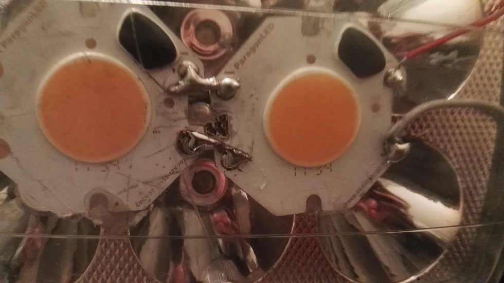

What is the LED part number?
What is the LED voltage?
hi sir
the part number is : cbcv-32-45195-12v - v02
power that: 8 watt
voltage is : 12 volt
3000k
thats picture:
