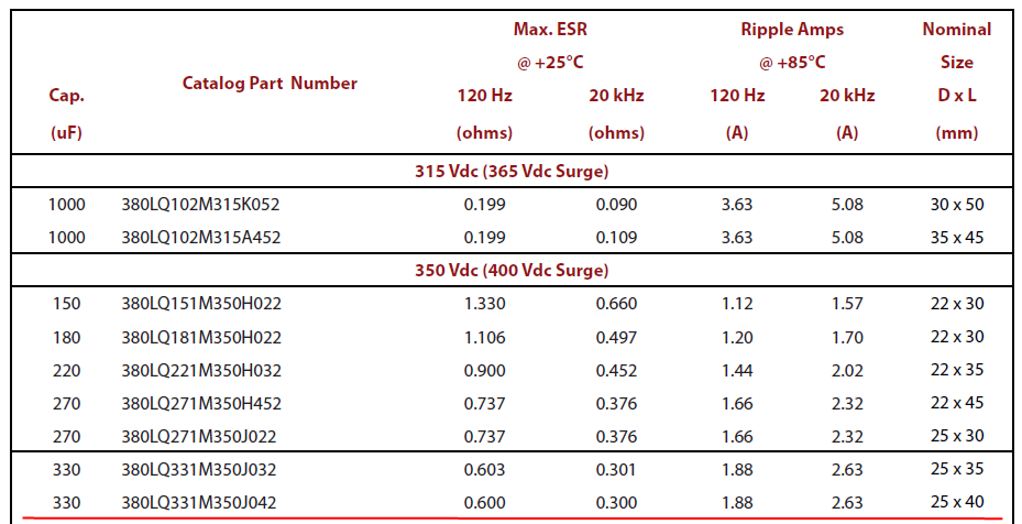

Data from:Type 380LQ 85 °C Compact, High Capacitance, Snap-In Aluminum Capacitors
This data sheet show ESR at 120hz and 20khz + Ripple Current at 120 and 20k.
Note in Ron Simpson's chart that a 220uF cap measured at 120Hz has an ESR of 900mOhms. You'll note in my previous post that the calculated value for the Nichicon 220uF cap at 16V came to 965mOhms, roughly the same and will vary by manufacturer. So the calculations presented in my previous post are sound. But it's best if you can find datasheets that show not just a couple ESR values at fixed frequencies, but show the actual graph covering most frequencies. That gives the clearest picture of all. But when nothing but TAN Delta is given, you have to calculate.
