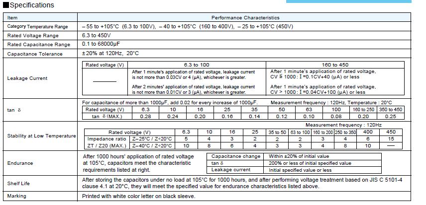

I'm not sure how to conclude the ESR of the capacitor from its spesifications.
what i did is:
R = 1 / [tan(delta) * 2PI * 120(Hz) * Cap(F)]
For a 350V rated, 330uF capacitor, it turned out that R = 16ohm, which is not reasonable.
By the way, voltage rating's units arent Vrms? why do they call it WVDC?
Thanks.

Tsk, tsk, Nigel, such a smart guy and you don't know tangent of delta?
Spec sheets don't always give you an ESR because it is dependant on frequency. See that tangent of delta term up there? That's the ratio of ESR to Xc.
tan δ = ESR/Xc
ESR = Xc tan δ
Yeah, that's was the wrong formula, use mine. Should get 1 ohm... ugh, is this a homework problem? I'm always suspicious of magic numbers like that.
They call it WVDC because the capacitance changes (slightly) when it gets charged, so that's Working Voltage DC. It changes because the charge on the plates exert a compressive force on the dielectric.
While ESR as such is dependent on frequency, the specifcation isn't, because it's specified at a common frequency - 100KHz.
Which makes it useless unless you happen to be operating the cap at 100khz.
I think Nigel's right.
Also: according to Mr Vette (who made the original ESR meter) readings at 100k and 50k are just as accurate.
I don't think you understand the problem. At OP's freq, 120Hz, the ESR is an ohm. At 100kHz, it's .0012 ohms. Big difference.
The ESR (Equivalent Series Resistance) should be a minimum at low frequencies (as opposed to the capacitor reactance). It's caused by the intrinsic internal resistance in the cap.
Would be if it was true - but it's not - ESR will be nowhere near as low as that.
As far as I know ESR at low frequencies would be lower than at 100KHz, certainly it's never mentioned or considered a problem at low frequencies.
