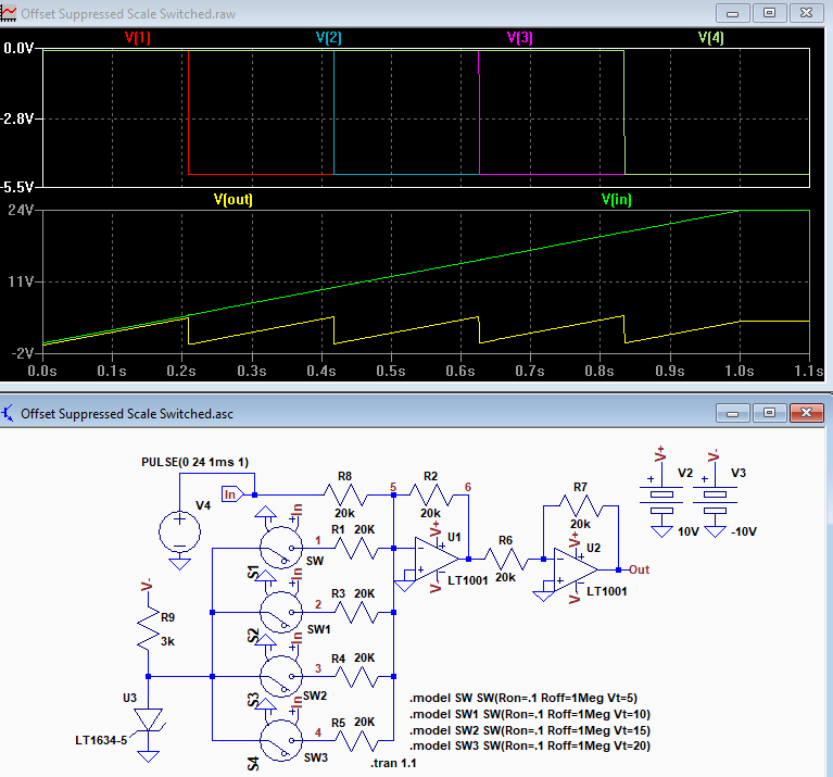

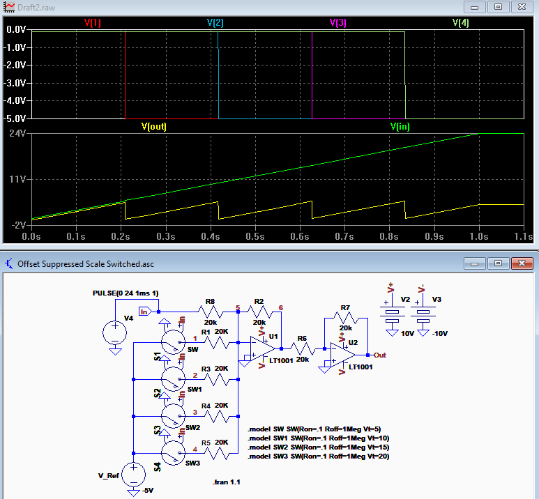

Hey wait a minute. The voltage reference is -4.5V. Where I am I supposed to get that?!
I just spent the entire afternoon putting together one huge simulation of the entire system. Unfortunately, the offset is also needed in the third stage but adding instead of subtracting. I'm not sure the project managers are going to like the design very much. Crutschow's tagline pretty much hit this on the head (inside every little problem there's a big problem trying to get out). I'm dumping this on the manager to find out how far the customer is willing to push out their limits and requirements.
I also now see the "pile of resistors" that has been mentioned. I was only thinking of the resistors for creating the offset. I was not thinking of the resistors that form the differential opamp. Once upon a time, I ran into a differential opamp design and don't recall having to deal with "a pile of resistors". After nearly two hours of searching and review, I found out why. That circuit didn't use a differential opamp, is used an instrumentation opamp. No pile of resistors. Ok. Back to step 1.
I used -5V.
You can get that from the negative supply and a LT1634-5 shunt reference along with a resistor, as shown here.
What does that stage do?
