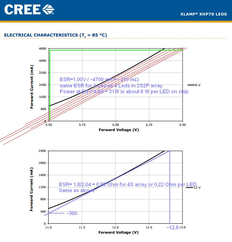

All diodes including LED's have a threshold voltage, Vth ( at say 10% of rated current) , a rated forward voltage Vf @ If and the difference in voltage can be used to approximate the effective series resistance inside or ESR.
Having worked with thousands of different types of LED's, I have a rule of thumb that the ESR of the diode is inversely proportional to the power rating such that the product term is nearly constant across all good vendors and sizes. Poor quality ones will be higher ESR per Watt or higher Vf per Amp unless in series strings. It also varies with chemistry, process & wavelength and is not exact.

Anyhow, my Rule of Thumb is 1 Watt-Ohm (WΩ) for internal ESR which is included in the Ohm's Law curve for V vs I with an external current limiting resistor.
Once you establish ESR, Choosing the resistor is just Ohm's Law between Vth and Vf.

This is obvious a high powered array of LEDs on a chip. 4S means 4 in series and the upper one 2S2P ,, you can guess. ;)
