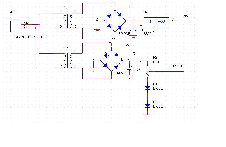

An improved schematic for smoothener will look like that:
D4 and D5 must be identical with the bridge diodes to compensate the temperature coefficient of the bridge
C3 = 220uF
R1+R2= 50..100 Kohm

It doesn't matter , the ADc input have clamp diodes. As long as you don't exceed the max input current it's ok. Use a pot > =1kohm (at 5v this means 5mA) and you're safe. The ADC input will be 0

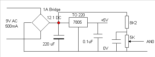

The circuit must be isolated.First I'm going to check the attached diagram, I changed the voltage dividers resister values please tell are they correct or not?
After I'm going to add the 2nd transformer like your one.
Also tell your edited final circuits resister values.Is that two diodes still there?

You need to flip the pot and the resistor around like this:

The cap in for noise suppression and better filtering the dc voltage use 1uF ..10 uF polarized cap. How big is your transformer?

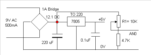

Yes, the last two schematics are what I had in mind. are what I had in mind.
Sorry it took me so long to get back.
Forget about a second transformer and all that. Your existing DC supply will do nicely.
I'm thinking mdorian's cap at the pot is unnecessary, but it can't hurt.

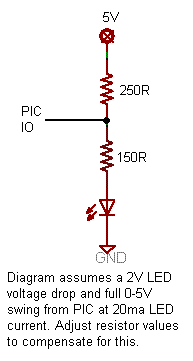

To keep the current consumption constant you could add extra resistors so that the circuit always draws the same amount of current whether the LEDs are on or off:
