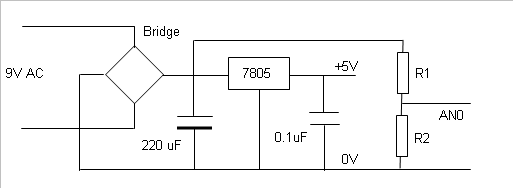

I mean like this.What about that?

I would not recommend using the PIC/7805 transformer for the low voltage 'ac' that you are going to sample.
Use a small say 2.5VA 4.5V/6V transformer and a low power rectifier to drive the adc input [ resistor scaling]

If I can scale the 230V AC to 5V ADC I can write the software.Still I'm struggling about what hardware to use.
I have again attached my earlier drawing please tell me is that the one do I have to use?

This is the circuit I'm having now.What changes do I have to do?
Note that input to the VREG voltage is smoothed the earlier guy told that there is a problem with that smoother cap.

We are assuming that you want the main 220/240 voltage to be insulated from your board , if not, you can skip the second transformer.
Thwe ADC impedance is too high to be a concern.
The schematic can be used only with an oversized bridge and transformer. If this is a school project don't use-it. This is not a proffesional way to do a measurement.

Morning Suraj,
The Vref is the internal Vdd =+5V.
Go over the calculations:
You want to to measure/detect a change of 10Vac on the mains input.
The transformer has a 9Vac secondary, so thats a step down of 25:1,
so the change of volts on the secondary for a 10V change on the primary is 10V/25 = 0.4Vac.
If you rectify and smooth the 9Vac you will get approx 1.4*9 = 12.6Vdc less the diode drop, say 12Vdc.
This 12Vdc is connected via a voltage divider to the PIC's adc input, say down to 4Vdc.
Thats a further division of 3:1, so for a 0.4Vac change is now 0.4/3 = 130mVolts. [referred as an ac signal].
My concern is is that if you use the same voltage source to power the PIC and LED's etc,
everytime the load of the PIC etc is changed the voltage to the divider to the adc is going to change.
There isnt a great enough voltage margin, in my opinion.
I suppose the way to prove this, is to build and test it.
If it dosnt work reliabily, then just get second low voltage transformer/rectifier and use that as the sampled voltage.

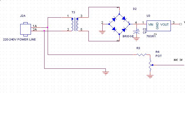

The input Leakage current for adc input is 1uA , If you use the noninsulated schematic:
For ADC divider
Assuming that you use 0.25W resistors
P = U^2/R so R >= U^2/P = 193,6Kohm
for R divider = 220 Kohm
I divider = 220v/220Kohm = 1mA
The error from the leakage current is 1mA/1uA = 1/1000
You can use R divider = 220K , pot = 2,2K
I don't understand why to use a rectifier and a smothener , this can be done in software as Eric did.

Hi mdorian thanks for your diagrams.Thank you very much.
The reason I use a rectifier and a smothener is because I need an extra transformer.So no place to get sample voltages in my diagram thats the only place I have.
But in your 2nd transformer can I drive directly the resister divider without using another bridge rectifier to make it DC.?
Because this formula is getting confused there.1.414 X 9V = 12.726V
Without a bridge can I use the same formula for that?
NO!!
You sample the AC voltage until you find the peak value, this wil be ACvoltage*√2
Wait for ADCin >0
Take samples and keep the highest value until adc sample = 0
Compare max value with values for 220v and 240v and set LEDs
Repeat
