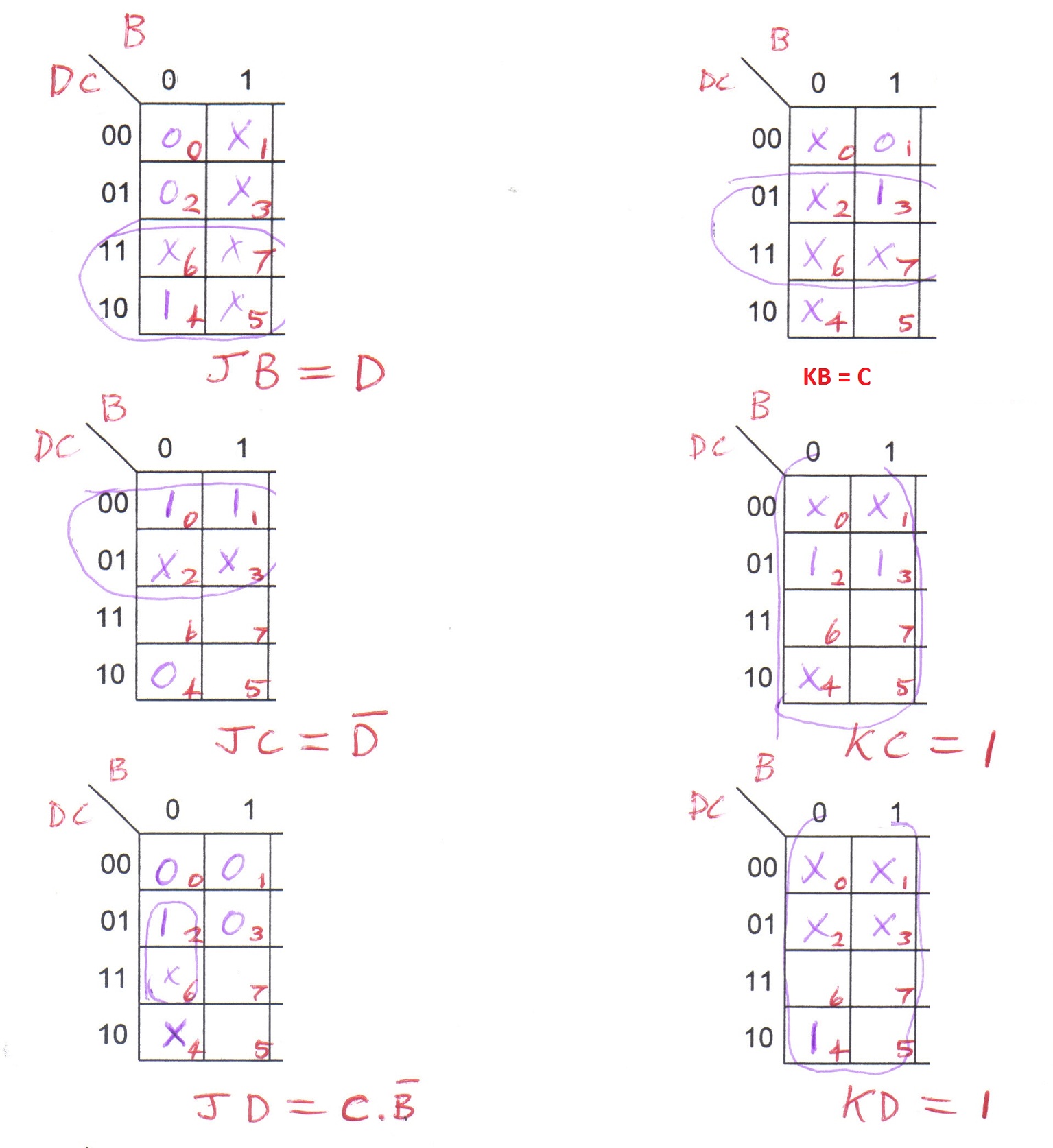

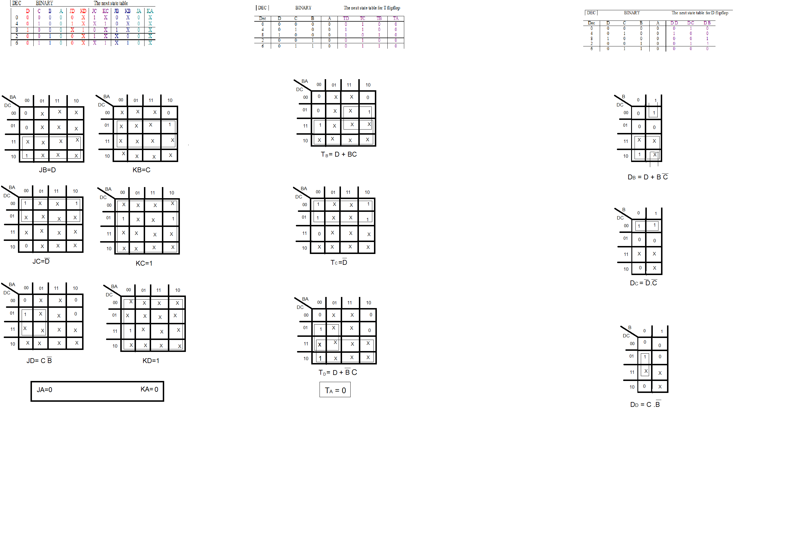

how to Design a counter which counts 0, 4, 8, 2, 6

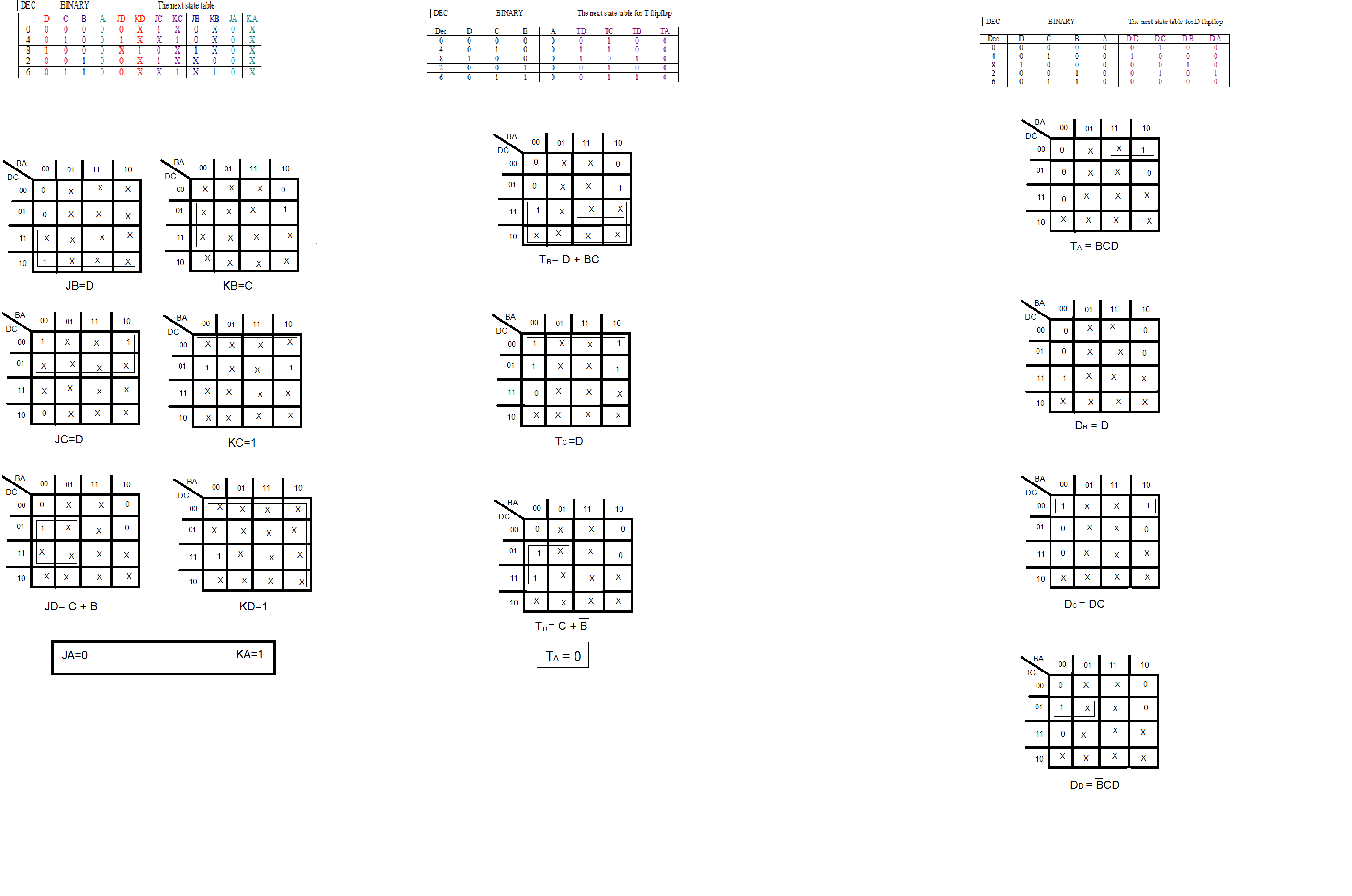

this is the k-map for the three flip-flops
The JK Map is almost right, well done.
You made a mistake with JD.
Also, you only need 3 Flip Flops. A is just connected to Gnd.

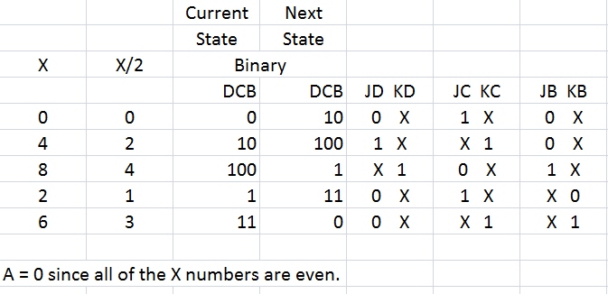

In the attachments you will see that I divided the figures by 2 before drawing the Next State Table & the K maps.
I'll look at the T case later, I have other things to do at the moment.

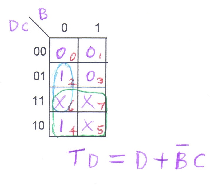

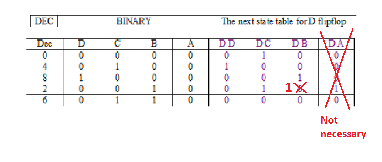

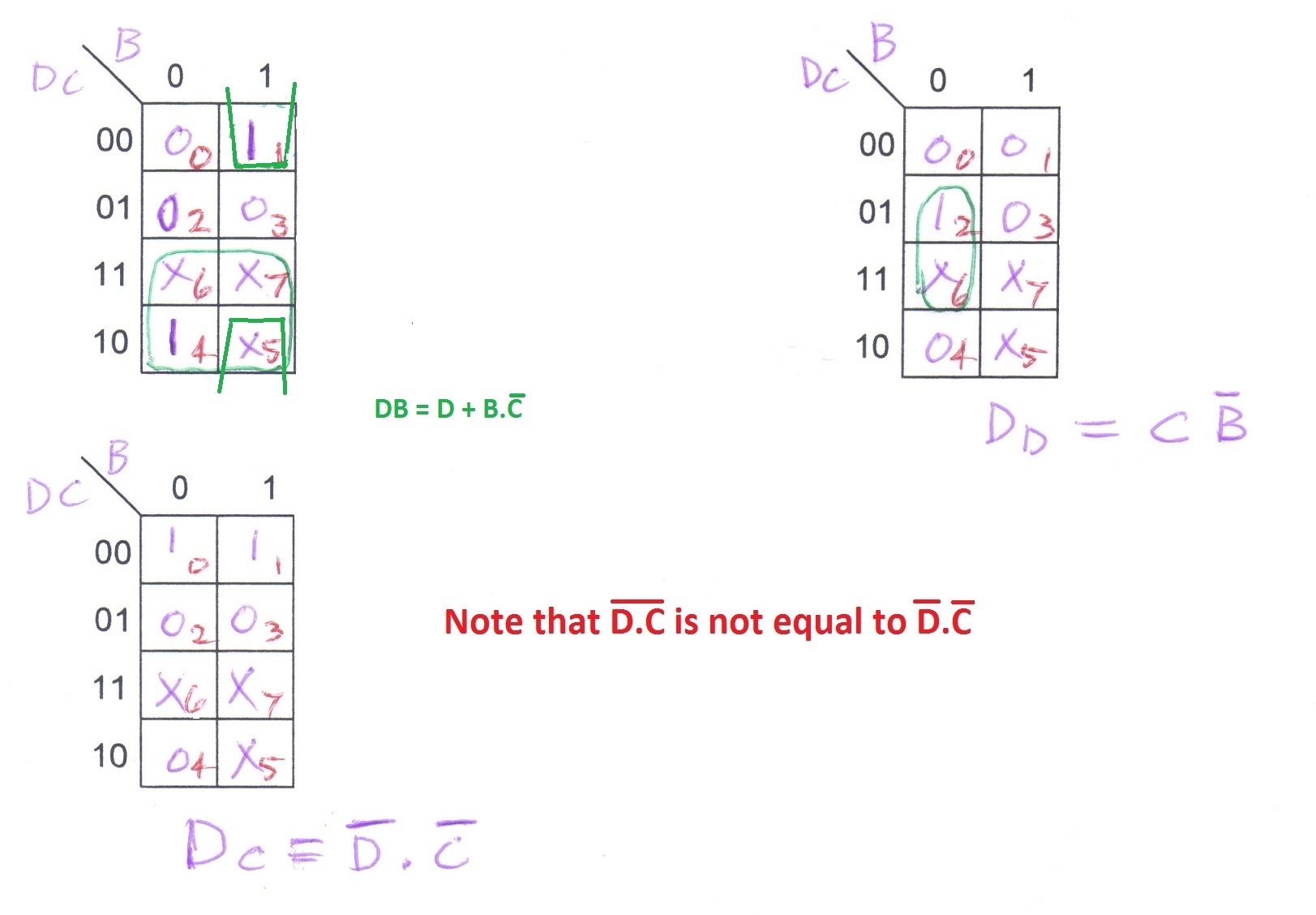

I have looked at the T & D cases.
You have made some minor errors, see the attachments.
However, check what I have done, I can make mistakes also.
EDIT
Fixed the error in the third attachment.
i fixed the mistakes
and this is the final results for K-map
now i will start design the first counter and when i finish it i will post it here
Your attachment looks good.
The only comment I would make is that you still have A in the Karnaugh Maps.
You don't need a Flip Flop for A.
It is 8:21 pm here now, so I'll have a look at your counters in the morning.

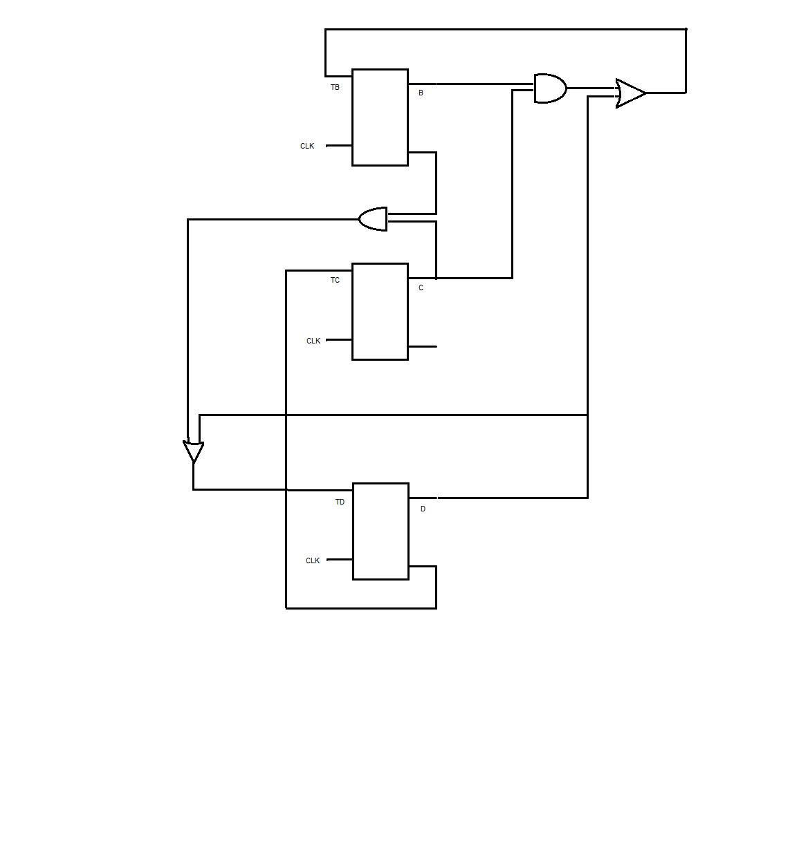

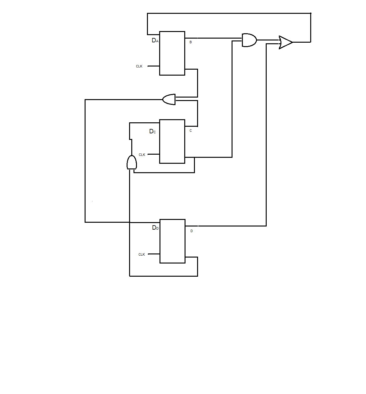

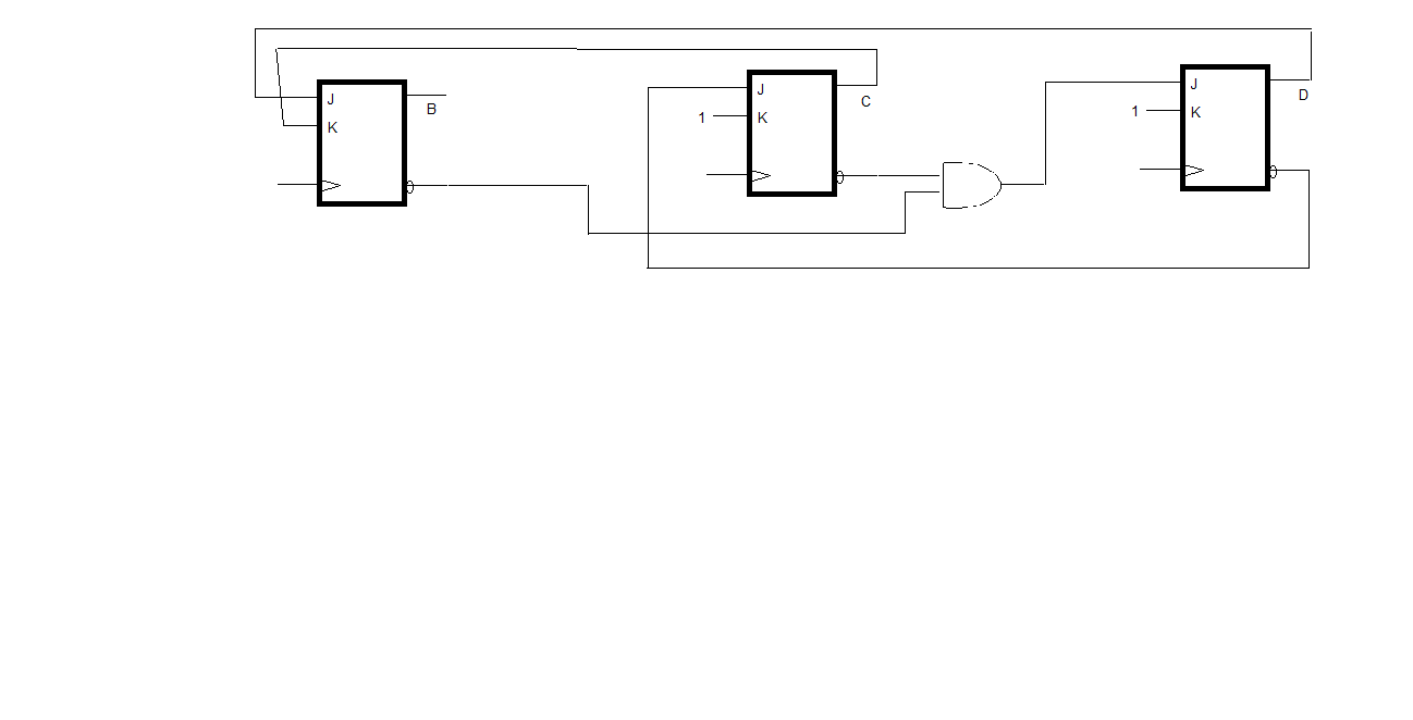

i done the counters but i think there is some mistakes

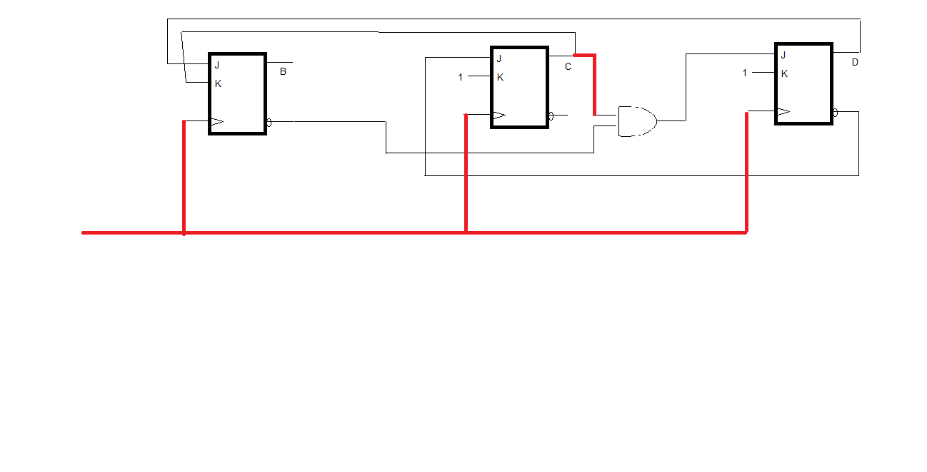

I only found one minor error in the JK drawing.
See attachment.
thank you very much
i fix it

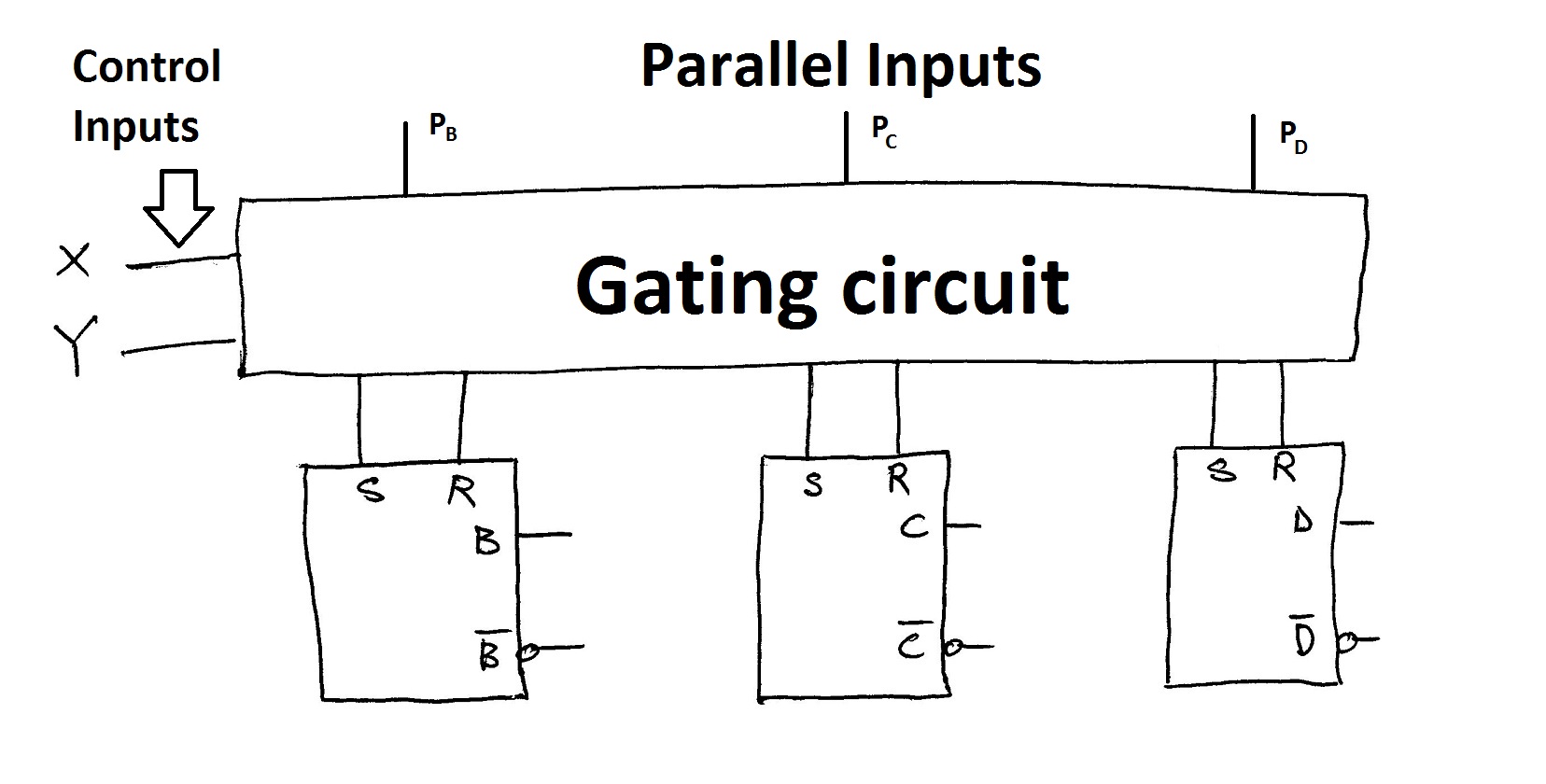

now, i want you to help me with the second part
2. Modify your design in question 1.a so that the circuit works according to the following function table
X Y F
0 0 Clear
0 1 No Change
1 0 Parallel Loading
1 1 Count
because i don't have any ideas of the way it done by it
I have attached the data sheet for the 4027 Dual JK Flip Flop IC.
Motorola call it the MC14027, other manufacturers use other prefixes such as CD4027, etc.
Note that the 4027 has Set (S) and Reset (R) inputs. These are called asynschonous inputs since they are independent of the clock. Some manufacturers call them Preset & Clear.
The J & K are called synchronous inputs as they are dependent upon the clock.
Look at the general description, Truth Table & the Block Diagram on page 1.
The Truth Table defines how the FF behaves under the various input stimuli.
You will need gating to control the functions. The inputs will be X & Y.
The outputs of the gating will go to the S & R inputs. You may also have to design some way of preventing synchronous changes when you want to make asynchronous ones.
The first step is to draw Karnaugh maps for the S & R inputs. I suggest you forget about the issue in red above initially until you have seen my next post. It is a side issue at this stage.
I will post another attachment later that will help you understand what you're trying to do.

I could not find a suitable counter data sheet that was relevant to your needs.
So I have drawn the basic block diagram of what you have to do.
I suggest that you concentrate on the Parallel Load & Clear (Reset) functions first.
Then we can think about the Count & No Change functions.

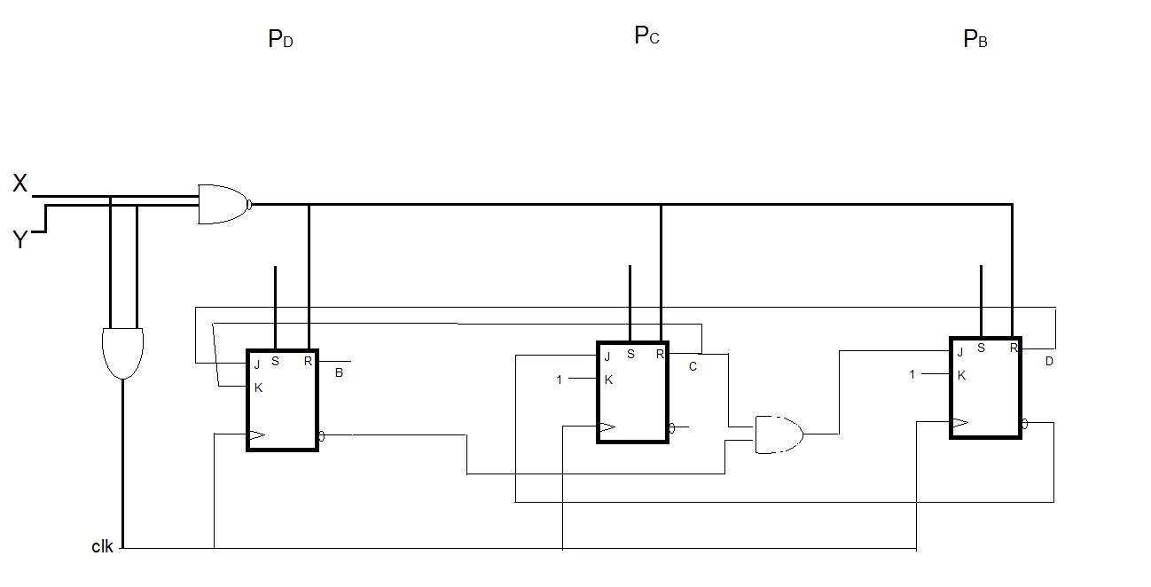

I think i have done all the cases except the parallel loads
* I have only 20 hours to finish it and i think it's not enough time

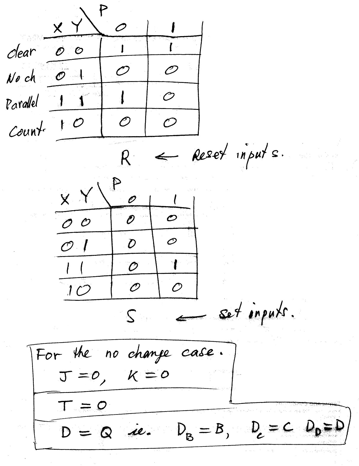

The logic is wrong in your drawing.
Since you are running out of time, I have drawn the Karnaugh maps for the Set & Reset inputs to the Flip Flops and have given you a clue as to how to do the "No change" case.
i don't understand the k-maps
and how to do the parallel load
The logic is as follows:-
To Clear all FF, ie. when X = 0 & Y = 0, you apply 1 to all R inputs.
To parallel Load, ie. when X = 1 & Y = 1, you make S = 1 & R = 0 if P = 1 or if P = 0 then you make S = 0 & R = 1.
Where P is the parallel data to be entered.

Parallel Load means that you set the counter according to data applied to the Parallel Inputs.
So, for example, if you applied say 110 to the P inputs, then set X = Y = 1, then the counter would be set to 110.
Then if you set X = 1 & Y = 0, the count will start at 110.
