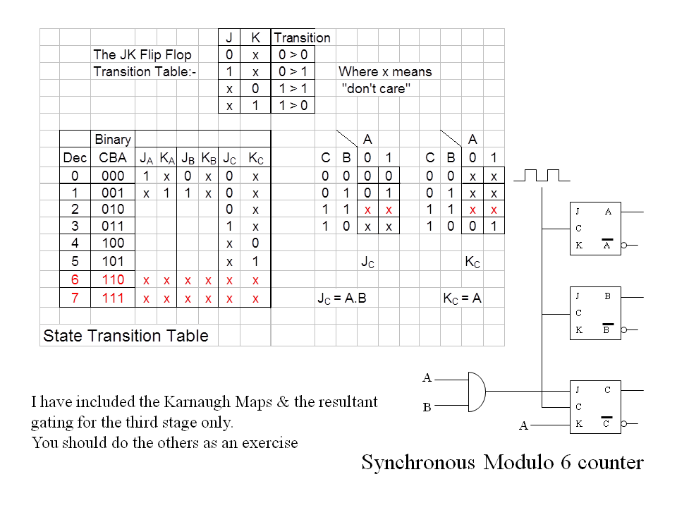

I have attached a partly completed design (that I did for someone else) for a Sychronous Modulo 6 counter.
This should give you a starting point in the art of sequential counter design.

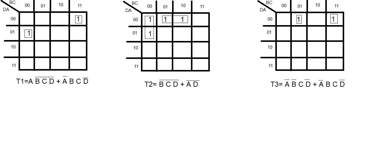

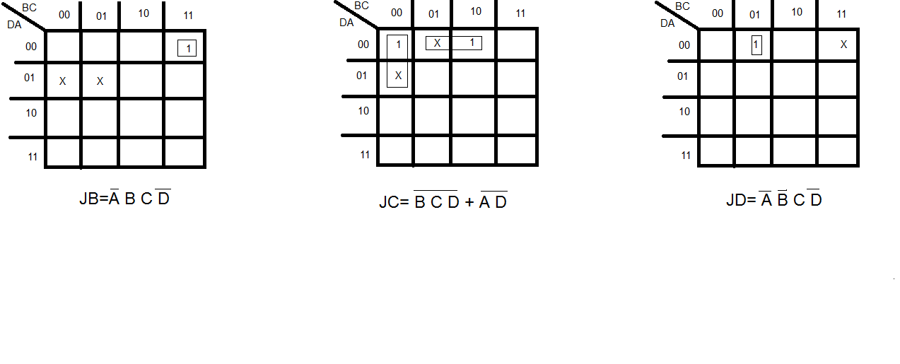

I looked at the next state diagram of for the T flipflop case. It looks good to me.
So as before, the next step is to draw the Karnaugh maps.
This is the k-map for them
please check them for me

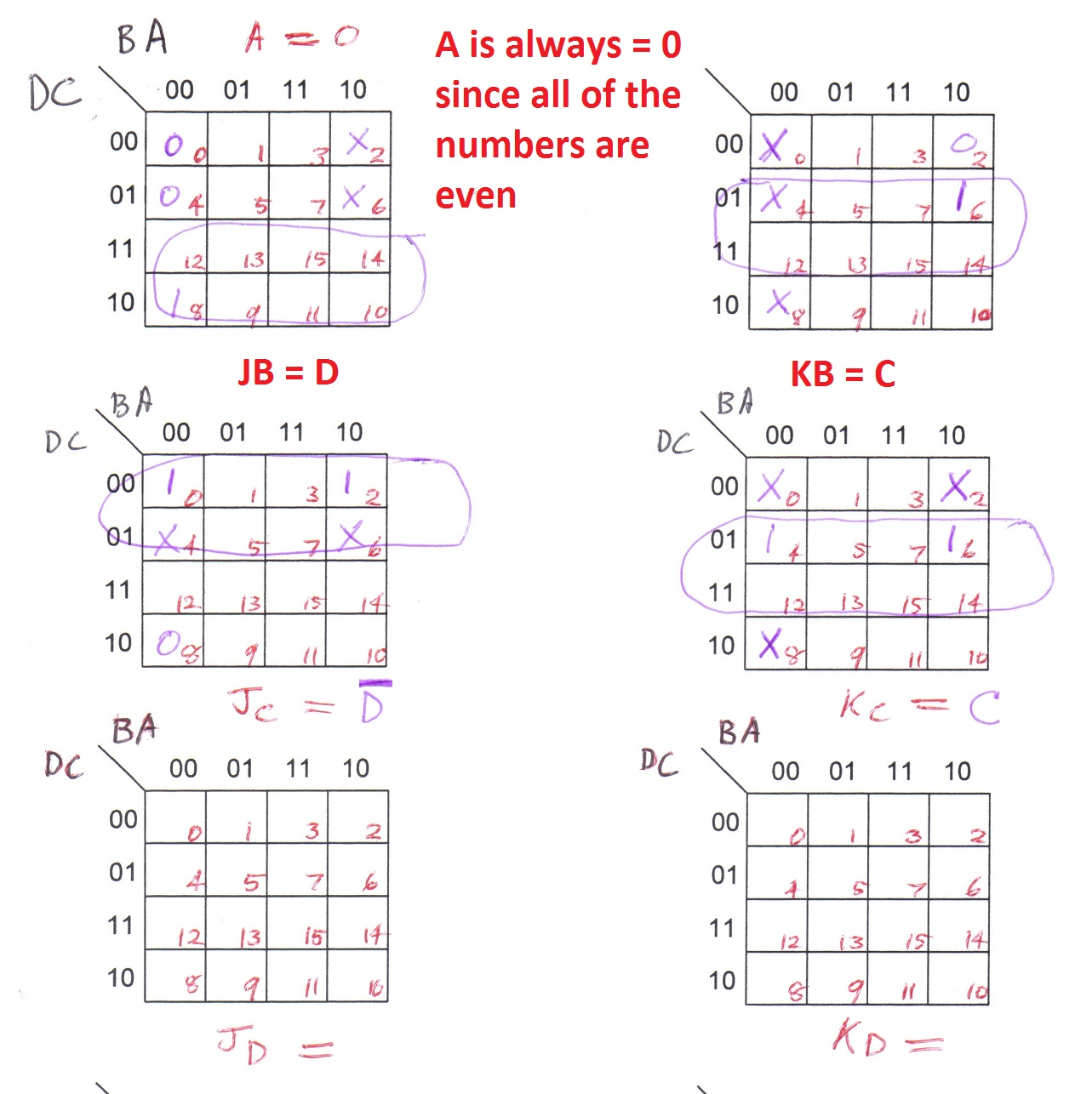

You did not take full advantage of the "don't care" states.
Also, sequence the A ~ D in the reverse order & add the decimal equivalents (as in red in my Karnaugh map).
I have done JB, KB, JC & KC. Please check them & then do JD & KD. You don't need a Flip Flop for A since it is always = 0 as all of the numbers are even.
I suggest that you re-do the T tables using this technique.
If you do it in the D ~ A order as in my Karnaugh maps, then it is easy to write the decimal equivalents in each cell of the map - as I did in red.
Then it is easy to see which states are valid & which are "don't care".
Then you can group as many "don't care" states as possible with the states that require a 1 & therefore minimse the logic.
For example, in my Karnaugh map for JB, I grouped 8 ~ 15 hence JB = D.
If I had only grouped say 8 & 9, then JB = D.C'.B' so you would need a 3 input AND gate to generate JB.
