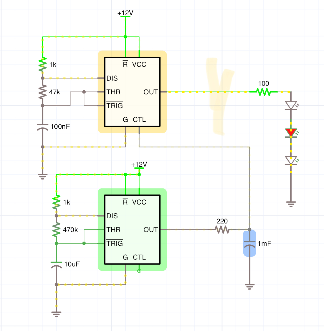

Hi everyone,
I'm working on a project to make an LED that fades in and out (breathing effect) and operates on a 12V power source. I have the following components:
12v strip led
3x 3.7v batteries connected in series = 12v (with added extra voltage when fully charged resulting in 12v)
BC547 NPN Transistor
NE555 Timer
C817 Optocoupler
330uF 50V Capacitor
330uF 25V Capacitor
1000uF 25V Capacitor
1000uF 50V Capacitor
100k Potentiometer
15K Ohm 1/4W Resistor
10K Ohm 2W Resistor
100K Ohm 1/4W Resistor
1K Ohm 1W Resistor
4.7K Ohm 1/4W Resistor
Could someone guide me on how to wire these components to achieve the breathing effect? If any additional components or specific values are needed, I'd love some advice. I’d also appreciate any example circuits or explanations on how to calculate the timing for smooth fading.
Thanks in advance for any help!
I am not very good with circuit diagrams I am a visual learner, I also checked youtube but it didn't help me much and it was over complicated.

The two circuits on youtube could be defined as junk, they use the sawtooth voltage across the capacitor of the astable oscillator realized with a NE555. This voltage, that varies from 4 to 8 volts with the NE555 powered at 12 V, is sent to the base of a transistor in common collector configuration so at the emitter output the voltage varies between about 4.3 and 7.3 V. To correctly drive two white LEDs in series even without a limiting resistor you have to hope for a miracle.
So straydoggo you can't drive a 12 V LED strip it with those circuits.
If you want to drive a 12 V led strip you have to use a pwm circuit that can be made with a NE555 and other components but it's not so trivial.
Pretty trivial once you think about it.

I did. See my post.

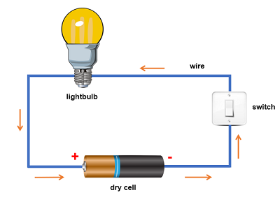

As I said I suck at understanding schematics. I am more of a visual learner. Like this
View graphic in my post. If that is not visual enough, you'll have to bring someone else into the loop to translate it to another format.
Note, the circuit performs well in simulation but remains untested in real life.
The LEDs go from 15% duty cycle to 85% duty cycle as shown. Lower the value of the resistor by the output of the lower 555-timer to get more range (ex, 150 ohm will get close to 5-95% duty cycle range) but the transition becomes faster (from full-on to full-off))
I did. See my post.
Hi so I what are the components that I need to buy? and where do I add the power? I only see two +12v. Where do I add the negative power source?
My led requires 12v to glow so I hope it will output 12v at max.
Also what other parts or resistors I should buy for the (ex, 150 ohm will get close to 5-95% duty cycle range) part. I mean if I want to make the fading faster or slower?
I also home someone is kind enough to translate this for me into something super simple and basic. I don't even know what some of the signs means.
