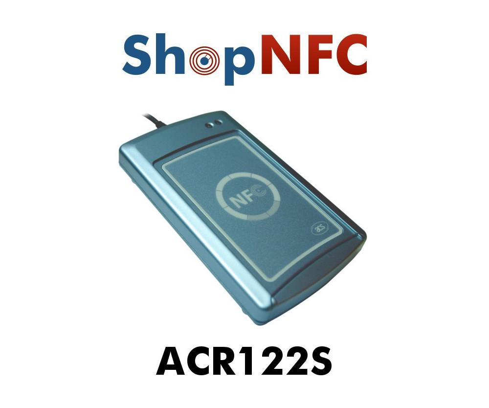

Or for a card that contains "credits" you need a Mifare style card and reader/writer.
That gives you the card number, but also allows data to be read and written securely, you you can check a credit count and write back one less to "pay" for a service.
This is an example ready built Mifare reader/writer with a serial interface:
Or you can get a module such as this, with a matching antenna, and build your own device:
Look at the data sheet link in the module listing for the technical info.
