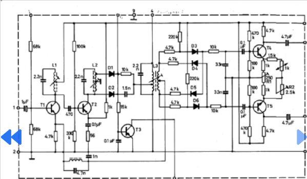

To all those who said NO.
Please try it out - it is quite a simple setup.
I have one made in the late 70's, it still works fine today.
This method was used in commercial FM receivers. A couple of references:
Both use Full Wave detection, I used Half wave.
