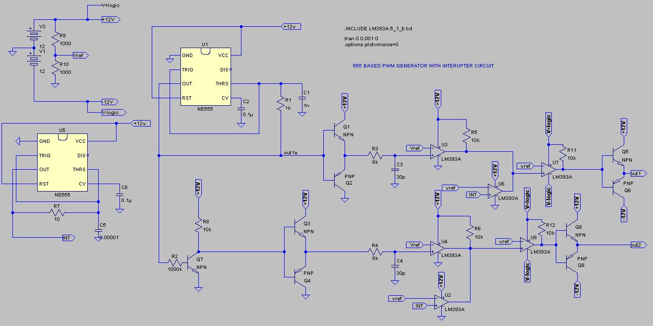

As my control circuitry stands at the moment, I have a 555 chip in astable mode outputing a square wave ar roughly 600khz this is then fed into a single transistor inverter to acheive two signals which are half a wavelength out of phase
these two signals are then passed through two seperate totenpole current amplifiers (one for each circuit). This signal (approximately triangular) is then fed into two comparators, these comparators compare the signal to vref. The output of these two comparators are conected to the output of two more comparators these two comparators are running from a signal from a secont 555 timer.
The 4 comparators form two and gate, the output signals for the gate drive are only high if both the input from the interrupter and the pwm sections are high
I included the interupter 555 because I thought it might be possible to use this as an option for reducing heat build up in the power transistors.

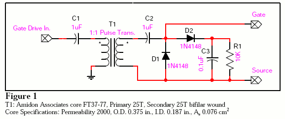

As for gate drive that is hadled by two pulse transformers not shown in the digram. Each has two secondarys. the setup is similar to the second digram below
would it be possible to replace the interupter 555 with a circuit based on a hall sensor to limit the current?

600kHz is too high a frequency for a 555. It is driving the dead short of a 10 ohm timing resistor so it will get extremely hot. If it works, its output will be a low level triangle wave.
The Vref is at 0V. Many of the comparators have a low input voltage near 0V so their offset voltage will cause some not to work. I think Vref should be +6V.
I was planning to use the cmos version of the 555 they are good up to 1-2 Mhz
Vref is at 6v it is in the middle of a potetial divider, R7 will be increased to about 1k, it is low currently to cut down on simulation time
where did you get that gate-drive cct from? - that wont drive at 600kHz with any real power!
Also as I said you are going to need to use IGBT's since you link potential is going to be over 100V
And with IGBT's you are going to need a firmer gate-drive cct.
Likewise you will not be able to switch them at 600kHz, likewise is there any need? 100kHz should be more than enough
How did you come at 600Khz? the normal way is to calc the rise-time of current in yr inductive-load and work out what ripple you can cope with, AND also look at the switching characteristics of yr silicon switch.
