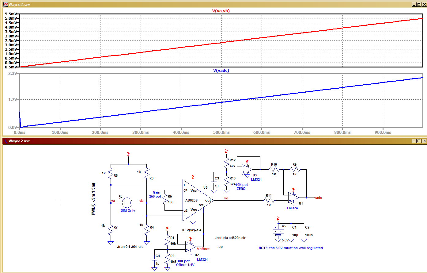

Hi,Thank you for your reply and is really helpful but I am still a bit confusing. All LM324 used in your circuit is to offset the output voltage?What is the output voltage range of your circuit?The Rg of your AD620 is adjustable depend what gain we want?I don't really need to show the weight, I just have to set a preset value and measure whether the object is under a preset value, so can I connect my circuit without LM324? If I connect the circuit shown in attached picture, my output voltage from AD620 is 1.67mV when there is nothing on the cell,is this the offset voltage?
Rg is adjustable for the Gain.The output range of my circuit is upto +3V

Using the LM324 circuit will give you the best results.
Are you sure you have the Load cell connections to the AD620 inputs the correct way round, if they are wrong any weight will try to drive the amp output below zero.!
Do this test... put a 5Kg weight on your load cell [ making sure that all the leads are connected].
The output of the load cell will be only 5mV, so the AD620 will have to amplify it by 600 times to make it +3Vout.
So make RG=80 ohms, using your circuit, dont forget to connect pin 5 to 0v.
Let me know what your voltmeter reads on pin 6.

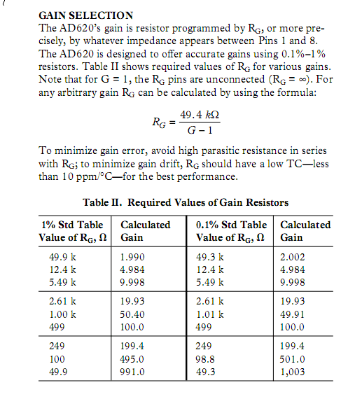

The Rref pin #5 MUST be connected to 0V or a offset reference voltage [ as shown in the LM324 option], if you leave it disconnected the AD620 will not work as you expect.
The Gain range is shown in the datasheet for the AD620, I have posted an image of the page,
As I said earlier use a 80R for the Rg that will give a gain of approx 600 which will raise the 5mV FSD output of the load cell to +3V.

Hi,If I use the circuit you posted last time, the output voltage range from the AD620 is 0V to 3V?The 10K pot of both LM324 is set to 6K4 and 4K5 respectively?If I use the circuit you have posted last time as shown in attached picture, the output for light weight will also be more sensitive?

You have to adjust the 10K pots a little to set the Zero and Offset, also the RG pot will need a small adjustment to the required Span accuracy.
The light weights will be more 'linear'

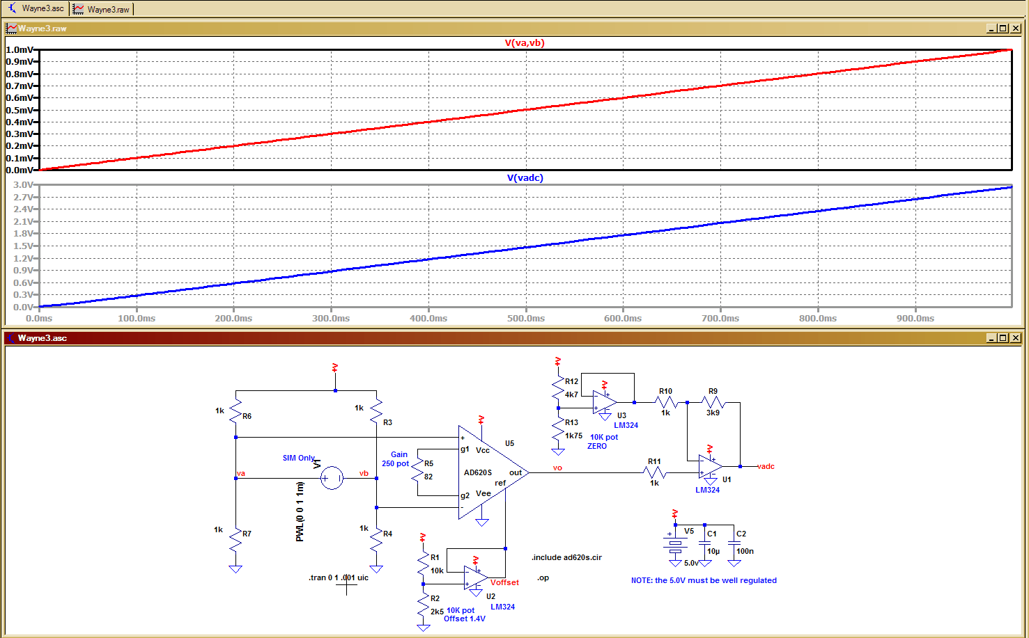

For your load cell a 5Kg bridge is not the best choice for a 0 to 1Kg scale, you will only get 1mV signal for 1Kg.
So if you amplify by 600 that will only be 0.6V, if your LPC has say a 10bit ADC at 3V input you would get 1023 counts, but for 0.6V you get 1023 *[0.6/3] =204 counts.!!

I got no choice because I cant find another scale to replace my current load cell before my project due,so I can just try to get as sensitive as possible. The circuit you posted last time have 3 pot resistor. I have to adjust the resistor to get 0V when there is nothing on my cell? Can I use 80ohm as my gain instead of using a pot resistor for my Rg for AD620?Thanks again:)circuit.gif

I have modified the circuit, this option will give you ~0v thru +3V for a 1Kg weight.
Look it over and ask if you have a query.

Hi,what you mean 0-3V for 1 KG?If the weight more than 1kg,the voltage will exceed 3V?So this circuit will change the overall gain dramatically and also the sensitivity?
If there is voltage when there are no object on the scale, how to reset the voltage to 0?

You said you only wanted to weigh from 0 to 1Kg in an earlier post, so what weight range do you want to weigh.???????????
Use the Zero and Offset pots to set the Vout to zero when there is no weight on the scale.

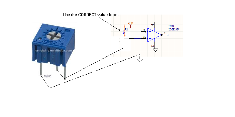

Hi,I not able to adjust the output voltage from LM324 to 0. Is it I connect the variable resistor wrongly?I using a trimmer as shown in attached picture,what is the correct way to connect the resistor?Can I leave one of the pic float and use just 2 pins as a resistor?schematic.pngimages.jpg
Hi
Look at this image, you MUST use the values I have marked on my drawing.

Hi
Hi,so is short the middle pin to one of the pin and use it as 2 pin resistor?I use the same value from your circuit but still not able to get 0V and the output of LM324. The minimum I can get is around 0.6++.
When you place a 2K or 1Kg weight on the scale what is Vout.?
Hi,I followed your circuit and I get around 3.7V for 1KG thing and 1.1V when there is nothing on the scale. I should short 1 pin of the variable resistor to the middle pin of the resistor right?Thank you:)
