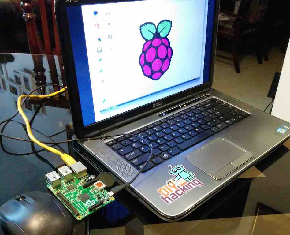

1) Like Ian said, in post #2.
2) Some people want to type on the PC but drive the Pi. See picture. (don't need a keyboard and monitor) Use a PC.
https://diyhacking.com/connect-raspberry-pi-to-laptop-display/
