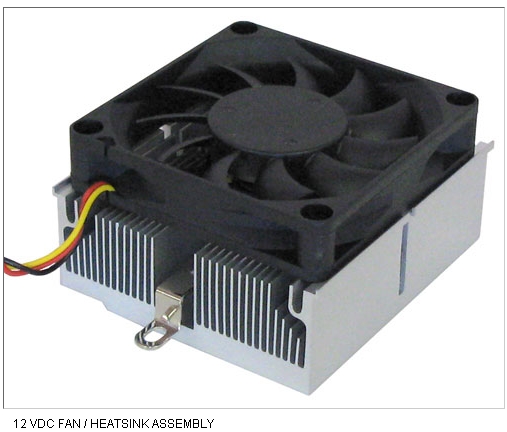

Assume you bolt a Power FET to the face of one of these, how many watts can it dissipate while keeping the face of the heatsink at say 50degC?

are you sure jawed ? isn't that a standard CPU cooler, the average CPU uses 50-70 watts.
Mike you would need a clip os some kind unless you drilled and tapped the heatsink but I wouldn't recomend it
I suppose it depends on the allowable temperature, CPU's need to stay around 50-70 C these days, if higher temps are allowed by the device being cooled then more power can be dissipated, depends on ambient temperature, computer cases get warm, if there is greater air flow it should be able to dissipate more
This test of several CUP coolers CPU coolers compared! measured above 0.5 to near 1.0 degrees C rise per watt. From the pictures I would guess your unit is around 0.75 degrees C/W. Thus you can dissipate 33W for a 25C rise to give a 50C heatsink temperature with a 25C air ambient.

I was looking at one as a load for discharging batteries. West Mountain Radio allows up to 150W in their **broken link removed**
